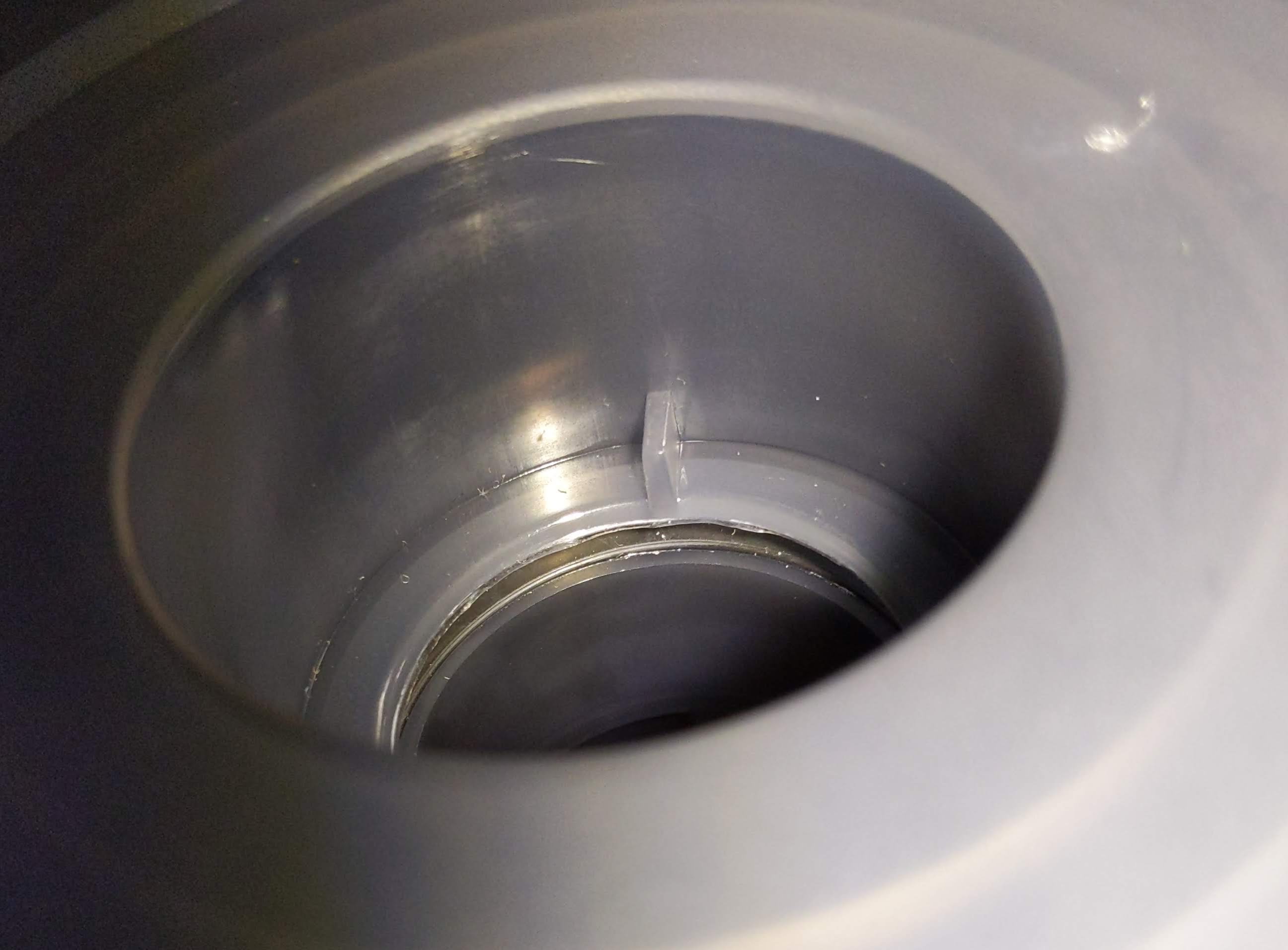

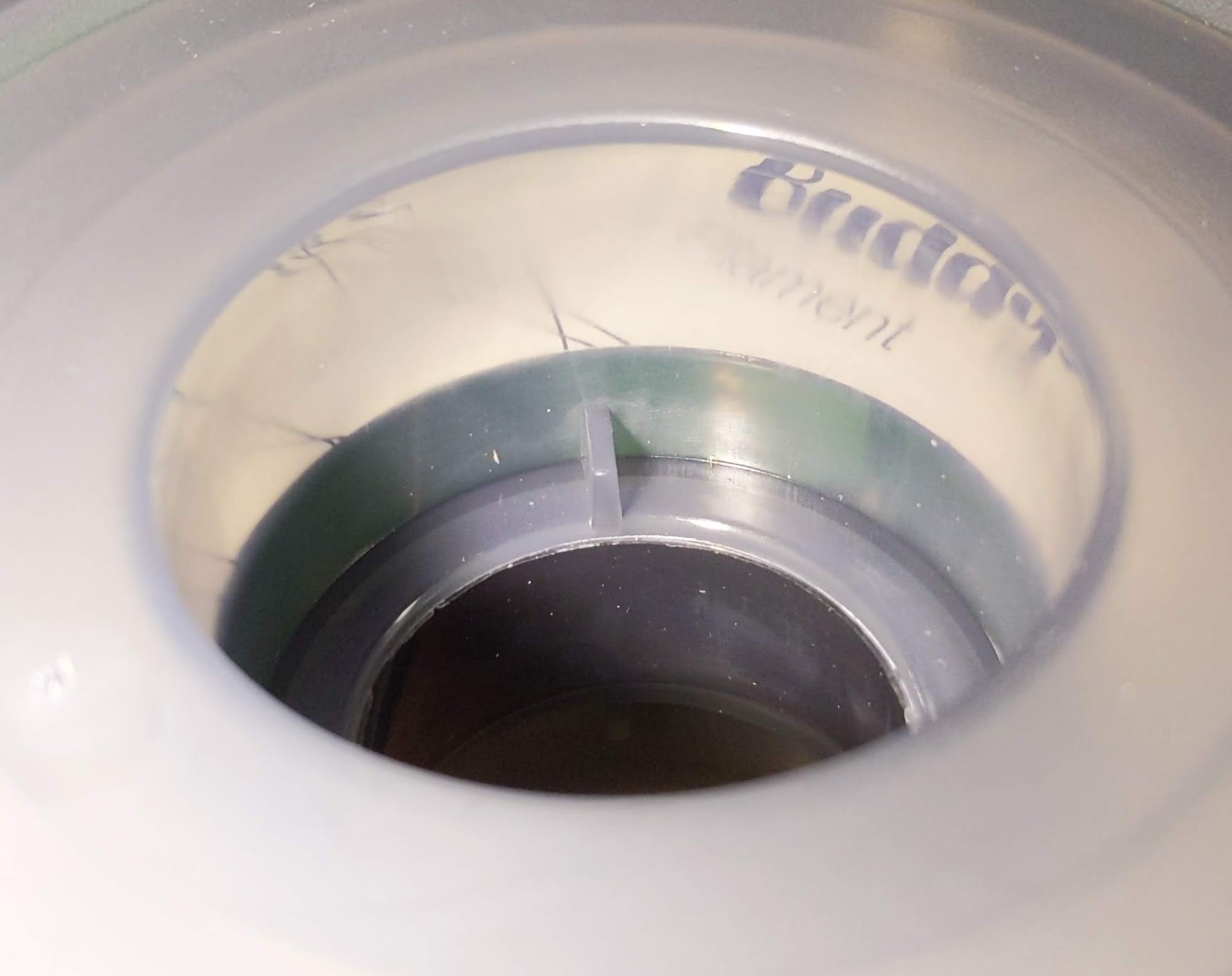

Well my dryboxes arrived a few days ago (in an MK4S box no less!) and they are quite nice indeed.
However I have just encountered my first problem.  It seems they are not compatible with the MATT brand spools sold on the Prusa web site!  I put one of these in and the lid closes and all seems fine, however you can't actually mount it to the machine, and it's very difficult to pull the filament out as there is so much friction, it's like the spool is clamped in place.
After some back and forth with support I realised that the spool is just a couple of millimetres too thick, so the box closes but the hole in the middle doesn't fully seal, which makes the middle of the drybox a few millimetres thicker than it's meant to be, and that prevents you from mounting it as the spool holder ends up being too short to accommodate the increased thickness.  (Not that you'd want to anyway, it takes way too much force to get the filament to come out.)  Prusa support said those spools are supposed to fit, so they're going to investigate and get back to me.
Hopefully Prusa will add some more details on the product page about the maximum dimensions of spools, and which ones will/won't fit, as there isn't much detail there at the moment.
FWIW these MATT spools are 197mm in diameter (which leaves 2-3mm spare so plenty of room in that dimension) and the width is around 75mm, but my calipers say the middle of the spool is 76.1mm thick, and that's too much for the drybox.  At a guess, 74mm is probably pushing it and 72-73mm is the thickest spool you'd want to use.
Here's a photo of what the middle is supposed to look like when it's sitting flush:
Drybox with a thin Buddy3D spool that shows the centre hole fuly closed and sealed
And here's the same shot with a MATT spool showing how the two halves of the drybox won't fully come together.
Drybox with MATT spool showing the hole in the middle doesn't close completely

The video doesn't really cover anything we haven't already discussed here.  It would've been nice to see it a few weeks ago when we were all asking questions about it though!  Also in the video it says the little cover in the corner is for replacing the desiccant but this isn't the main reason, it's primarily there to allow you to rotate the spool (e.g. to wind in the excess after unloading it) otherwise you'd have to open the whole box in order to turn the spool even a little.
And yeah I'm not too upset either about the MATT brand spool not fitting (Prusa offered me a small discount off a future order as an apology but I declined), as I'd rather they just made it clearer what the maximum dimensions are for the spool, and listed which common brand do and don't fit.  At the time of writing there's no information at all about what spools do and don't fit, so I think you could be forgiven for assuming that it would at least fit all the spools available for sale in the Prusa store.  But as it turns out, quite a few spools they sell won't fit, so that was a bit of a surprise.
