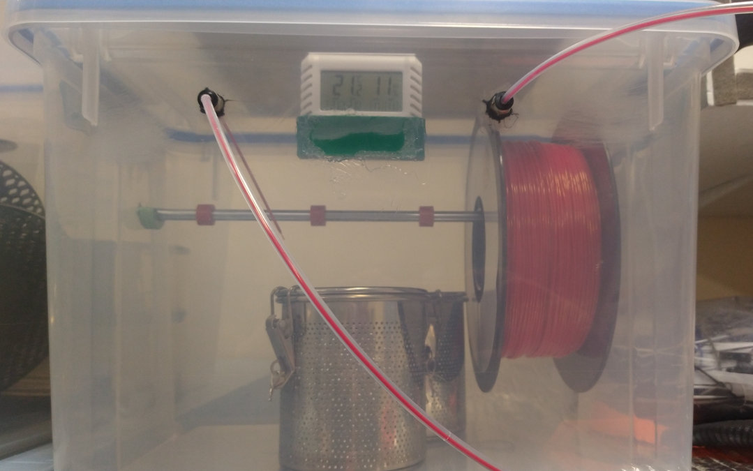

I will stick with my home made dry box.  This one could handle 3 spools if needed or 2kg spools.  Cheap sealed box from Walmart and a couple of connectors and a stainless rod that I had sitting around.  I think that the total cost was less than C$30.  I am looking at changing the rollers.  Stainless tell containers are activated alumina.
