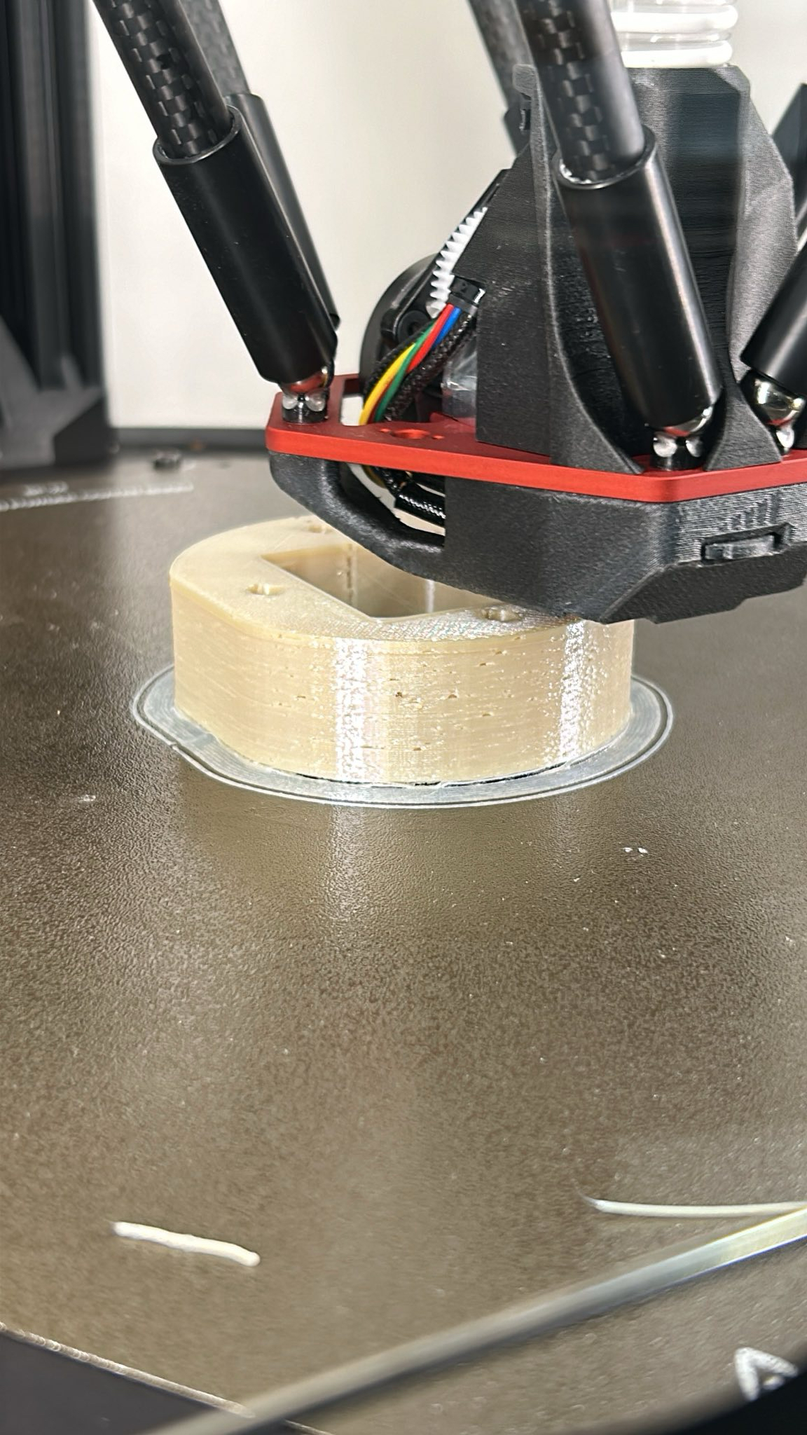

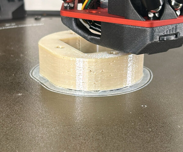

Our success in printing PEI 9085 is maybe 10%. The first issue keeping it adored to the bed. We have tried both Nano polymer adhesive and Caption take. The textured bed make the tap lift up when the part starts to cool. The Nano polymer adhesive is not thick enough to fill the voids of the texture. We are in the process of making out spring steel print bed that is perfectly smooth. We bought one of the nylon print sheets but that too is also textured. First bench print failed.
just like @parts-depot mentioned above. the stringy parts are pretty standard.
Another annoying thing that happens is when the head stops and moves to a different section of the part it seems to create a small pock mark. I included a picture. we also dry for a day before printing. It still looks like crap compared to our FORTUS 900 ULTEM 9085 prints.
I am hoping a lot of this can be fixed with future releases.
As for the camera. I find its position to be nearly useless.
