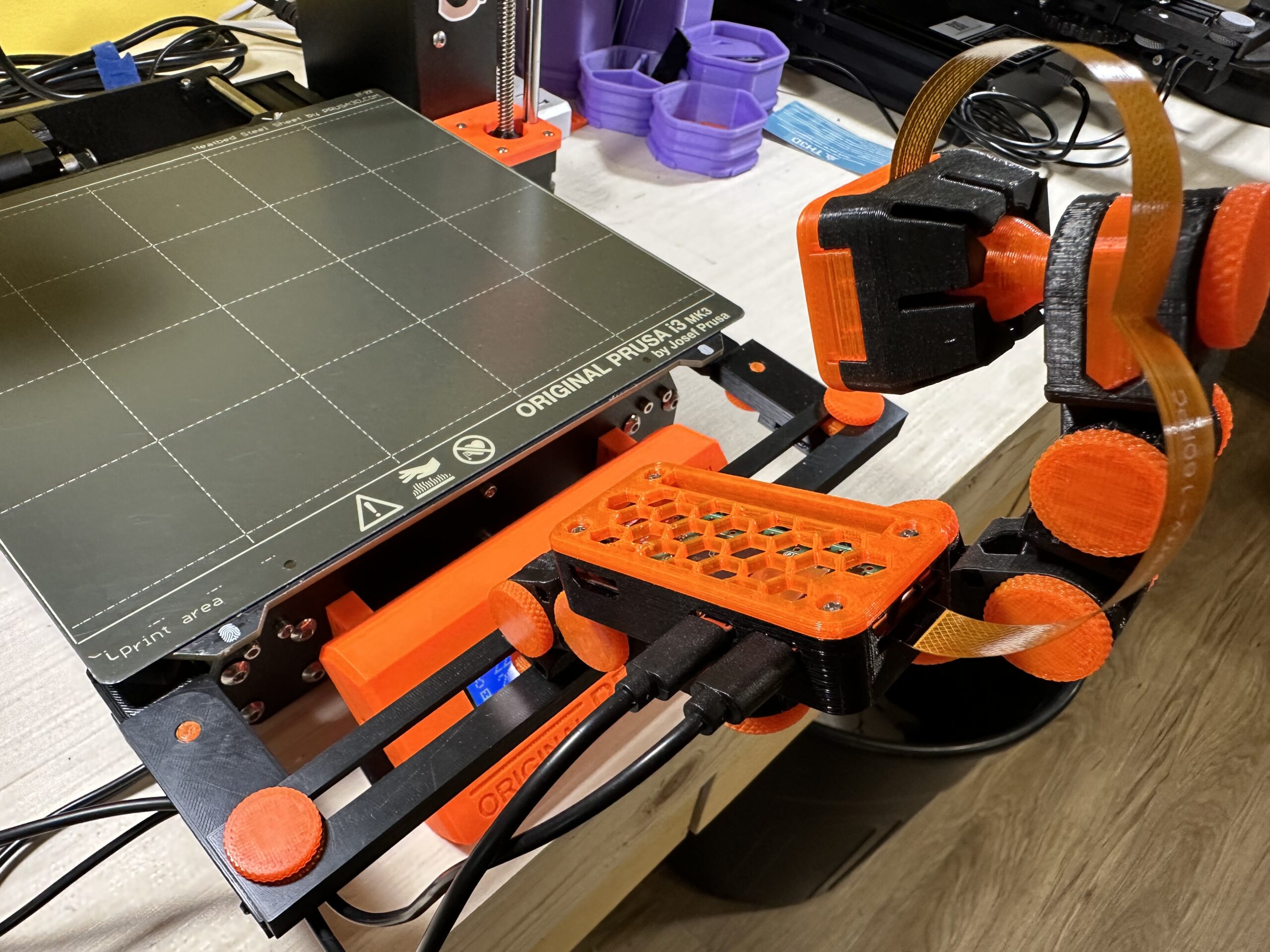

More in depth about what I'm doing: I've gone through Printables and some other sites looking for a good camera mount for my Prusa. I found I hated stationary mounts, since they made timelapses that made me disoriented to watch, since the printed objects were going back and forth. So I modified parts of some mounts and ended up with this:
When I designed it, I made sure the rail that holds the camera mount (and a Pi Zero) was high enough up that it didn't hit the end of the frame under the print bed and also missed the top of the case for the LCD screen. It's worked fine for a year or so, but today I did my first print with PETG and ran into issues. While this isn't attached directly to the bed, the parts of the bed support frame heat up along with the bed and apparently that extra heat for PETG instead of PLA was enough that the extensions started to sag so the crosspiece now hits the end of the frame and the LCD case.
As I mentioned, I prefer a camera that moves with the bed. I'm thinking I can make a support or rail that will attach to the channeled aluminum frame under the bed and a camera mount that'll ride along on that. I'll attach part of it to the bed so it moves with the bed, back and forth, along the rail I make. That means the part attached to the bed will ride back and forth on the rail. I'm wondering if I need to include some kind of wheels or rollers so the two parts aren't just sliding against each other and if the type of filament I use will make a difference.
Is this something I even need to be concerned about? Will PETG (for example) handle the friction better than, say, PLA? Or should I do a design where the weight of the mount slides along on ball bearings or on some kind of roller that rolls along on the rails? And if I find I can easily make a metal part for the rails, and still use a printed part for the mount that slides back and forth on the rail, do I still have to consider those issues?

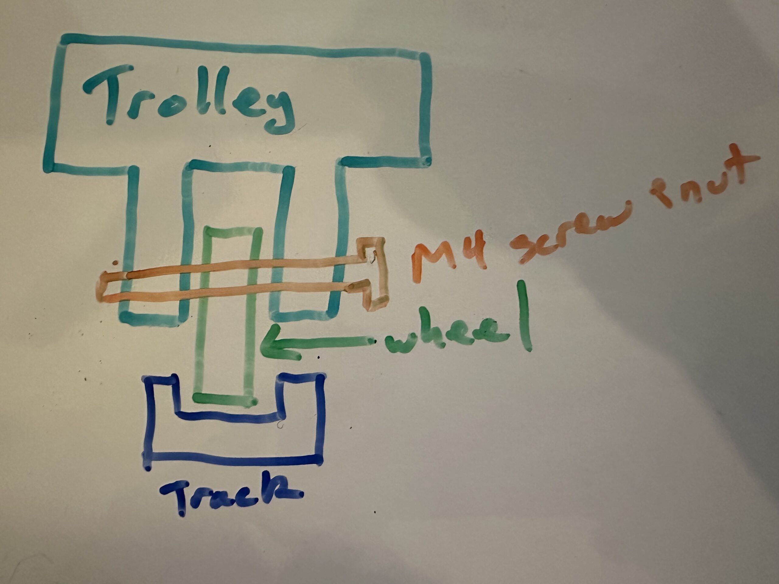

I'm thinking that I can do it all in PLA and a few screws. The camera stand trolley will have wheels that will run in tracks on a rail or base that is near the print bed. Something like this:
I'll use a screw for the axle for each wheels and the wheels will roll along in a track. I may make the wheels a bit more wedge shaped so they fit in the track better and I'm considering adding teeth to the wheel and track, so it fits like a gear, which will ensure the wheels turn instead of sliding - but that could also cause a problem if something goes wrong and the wheels might jam. My thought with this design is that screws have rough edges and I'm wondering about the friction of the wheel against the screws/axles.

If you are concerned about the wheel on the screw thread then just use a screw with a shoulder.
For the ultimate you could just use a suitable bearing as your wheel
Good point - had thought of that. Still early in the design process and have other things that are taking priority, so I'm just thinking about this when I have time here and there.
One concern I have is the possibility of the wheels (or bearings) sliding sideways. If I use metal bearings, any suggestions or thoughts on an easy way to get a metal track? I'm thinking maybe some kind of angled aluminum for that.

If you use a bearing there should be no issue with sliding providing you don't pinch the outer race. Easiest way to make sure is to put a washer on each side about the same size as the inner race.
You don't need a metal track, there should be no wear if it is rolling, and trying to buy or make a rail of the right size in metal is going to to be a pain. If you are worried about wear then make sacrificial tracks and when they wear out (they won't) you can reprint just those.
