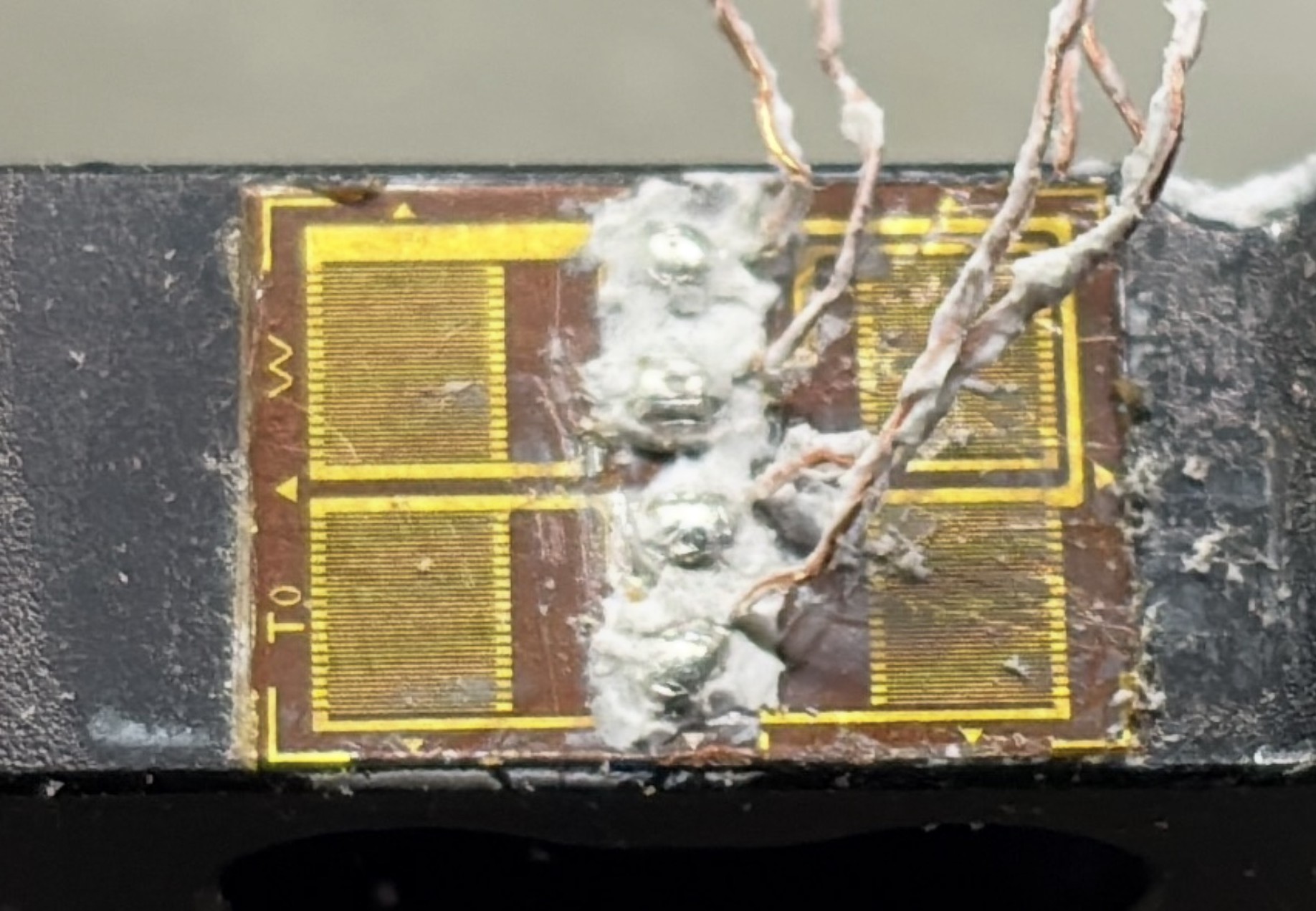

I don't know if this will help you, but this is what I found after scratching around.
This is what came up when I asked Chat GPT:
The component in your photo is not an ‘IC’ or sensor chip, but rather a
➡️ foil-etched strain gauge (SG), 4-grid full bridge – exactly the type of component that is attached to a metal spring in a load cell / force or bending sensor.
Why is it almost certainly a 4-grid strain gauge?You can see four identical measuring grids (2 at the top, 2 at the bottom), typical for a full bridge for bending or force measurement. Such ‘four grid full-bridge strain gauges’ are offered exactly as shown. tst-scale.com+2tst-scale.com+2The fine, parallel conductor tracks on brown carrier foil are the classic design of a metal foil strain gauge.Four solder pads in the middle = 4 connecting wires of a Wheatstone full bridge (E+, E-, S+, S-).Meaning of the markings ‘T0’ and ‘W’
For many Asian strain gauge manufacturers (BF/BA/BM/BY, ZF, ZYM series, etc.), the printed letters/codes have a standardised meaning:
In catalogues from Zemic, Materontek & Co., codes such as T0, T2, T4, T6, T8, etc. appear as so-called ‘creep / STC codes’ – they indicate the combination of temperature and creep compensation, matching the material of the spring (steel, aluminium, etc.). zemic.co.za+2Zemic Europe+2A Chinese overview explicitly mentions:‘T0: Temperature self-compensation’,‘W: Welding Wire: Silver, Enameled Wire, Cable’ – W therefore stands for the variant with soldered connection wires. WayDigi Site Name
This fits your component perfectly: “T0” at the top and ‘W’ on the right, plus the soldered copper wires.
Exact type?
Unfortunately, I cannot read the exact type (e.g. ‘BF350-3FB-T0-W’ or similar) from the photo because:
the actual type code (BF..., BYM..., ZF...) is normally printed below/on the side – in your case, it seems to be covered by silicone and the wires,and there are several 4-grid full bridges with similar dimensions in the catalogues (backing e.g. 9.8×7.3 mm, 10.0×6.5 mm, etc.). zemic.co.za+1
However, you are certainly correct with ‘4-grid strain gauge / full-bridge strain gauge’.
How you could continue searching / replacing
If you want to find a replacement part or data sheet, search the internet for combinations such as:
four grid full bridge strain gauge T0 WBF350 4FB T0 strain gaugeZemic full bridge strain gauge W T0
and compare the backing size (~11.5 × 7.3 mm) and the grid arrangement in the catalogues with your photo. tst-scale.com+1
