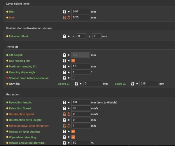

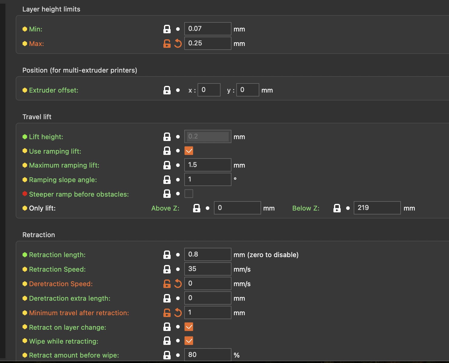

GrayM
(@graym)
RE: Micrometer inconsistencies in z-offset probing causing waviness?
Hi, I don't yet understand why the retraction settings are effective due to my lack of experience, but my tentative conclusion is that it ensures more precise layering and cooling/adherence consistency.
I solved my issues with the attached retraction settings on a satin sheet, PLA filament, 65 bed temp and 215 nozzle temp, with brimming and organic supports.
Posted : 01/02/2025 3:42 pm

UjinDesign
(@ujindesign)
Posted by: @graym
I tried these retraction settings and they didn't eliminate the waviness for me. I have no idea why they worked for you, but congratulations on finding a solution I suppose! 😄
