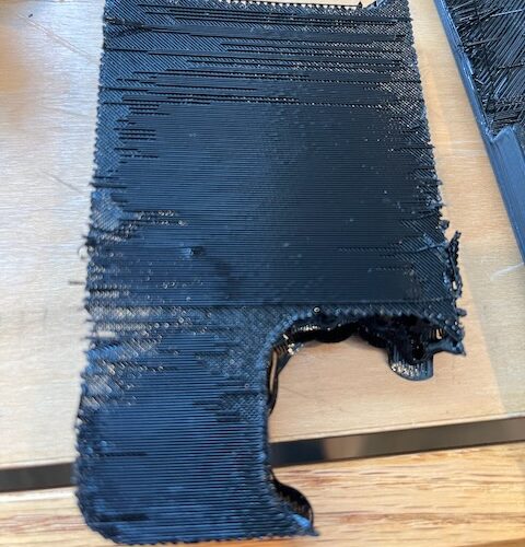

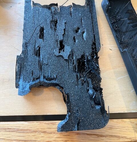

Looking for help with problems separating supports from models, perhaps organic supports related
I'm having trouble when I try to separate support structures from my models.  I can't tell if I'm not getting all of the supports out, or if I"m tearing into the layers of the model itself.   I'm printing on a Core One using Prusament PETG.  Slicing in PrusaSlicer with the default settings, except that I'm using organic supports.  I haven't done much experimenting, but I don't think I've seen this problem with the default settings.
Here's an example of a print of Jonte's iPhone 13 case:
Here's the interior after I pulled out the supports.   I can't tell if the leftover threads are support bits that didn't come out or the model's innards.
Here's the block of supports that I pulled out (this is the side that faced the model):
and here's the side that was on the print bed:
<edit>
Looking at the bgcode in the Prusa viewer, it looks like the leftover hairy bits are either Bridge infill or Support material interface.
<end edit>
Am I doing something wrong or is this the way things are supposed to be working?

This looks like a support settings issue rather than a print defect. Organic supports can fuse to the model if the contact distance and interface settings are too aggressive. Try increasing the Top Contact Z Distance to around 0.2 to 0.25 mm for PLA or PETG. Reduce the number of interface layers to zero or one since too many interface layers make supports much harder to remove. Lower the organic support branch density and slightly increase the branch distance so the support tips do not press as firmly into the model. Increase XY separation a little to prevent side bonding between the support and the part.
You may also get better results by rotating the model to reduce overhangs and using paint on supports instead of fully automatic supports. Dropping the nozzle temperature by 5 to 10 degrees and improving part cooling can also help, since higher temperatures tend to weld supports to the model. With these adjustments, the supports should snap off more cleanly and leave less damage or residue on the printed part.

Going through the default settings,
  • top contact z distance was already 0.25
  • top interface layers was 3, I"ll try 1
  • organic support branch density was 30%, I've lowered it to 15%
  • branch distance was 1, I'll try 2.
I'll report back on how it goes.
