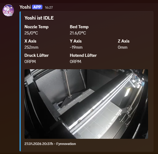

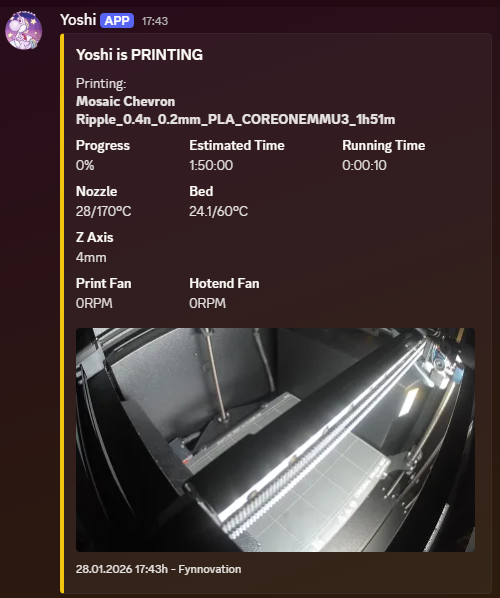

Since PrusaLink provides a direct local API with live printer data, I decided to develop my own solution:
PrusaLink Discord Notify (BETA)
PrusaLink Discord Notify is a lightweight C# background service that monitors a Prusa printer via the local PrusaLink API and posts structured status and progress updates to a Discord channel — including live camera snapshots.
It's still in a beta-like state and will be further refined.
Feature requests are also welcome XD

Posted : 28/01/2026 6:05 pm
