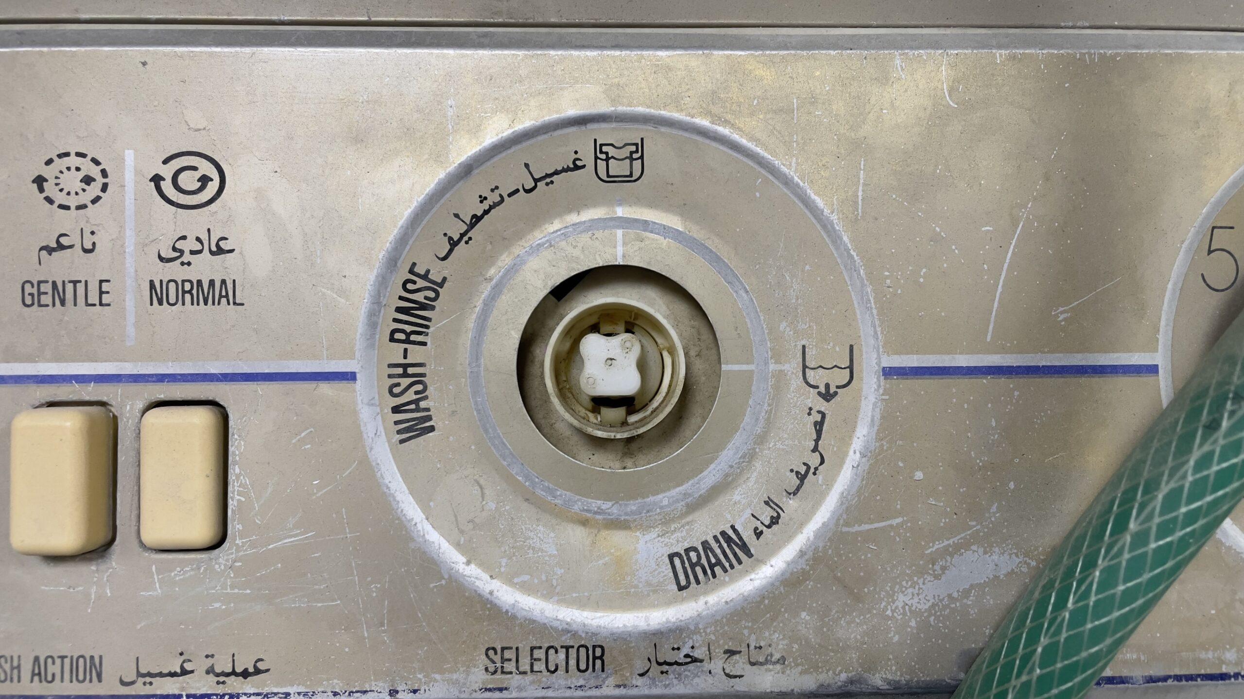

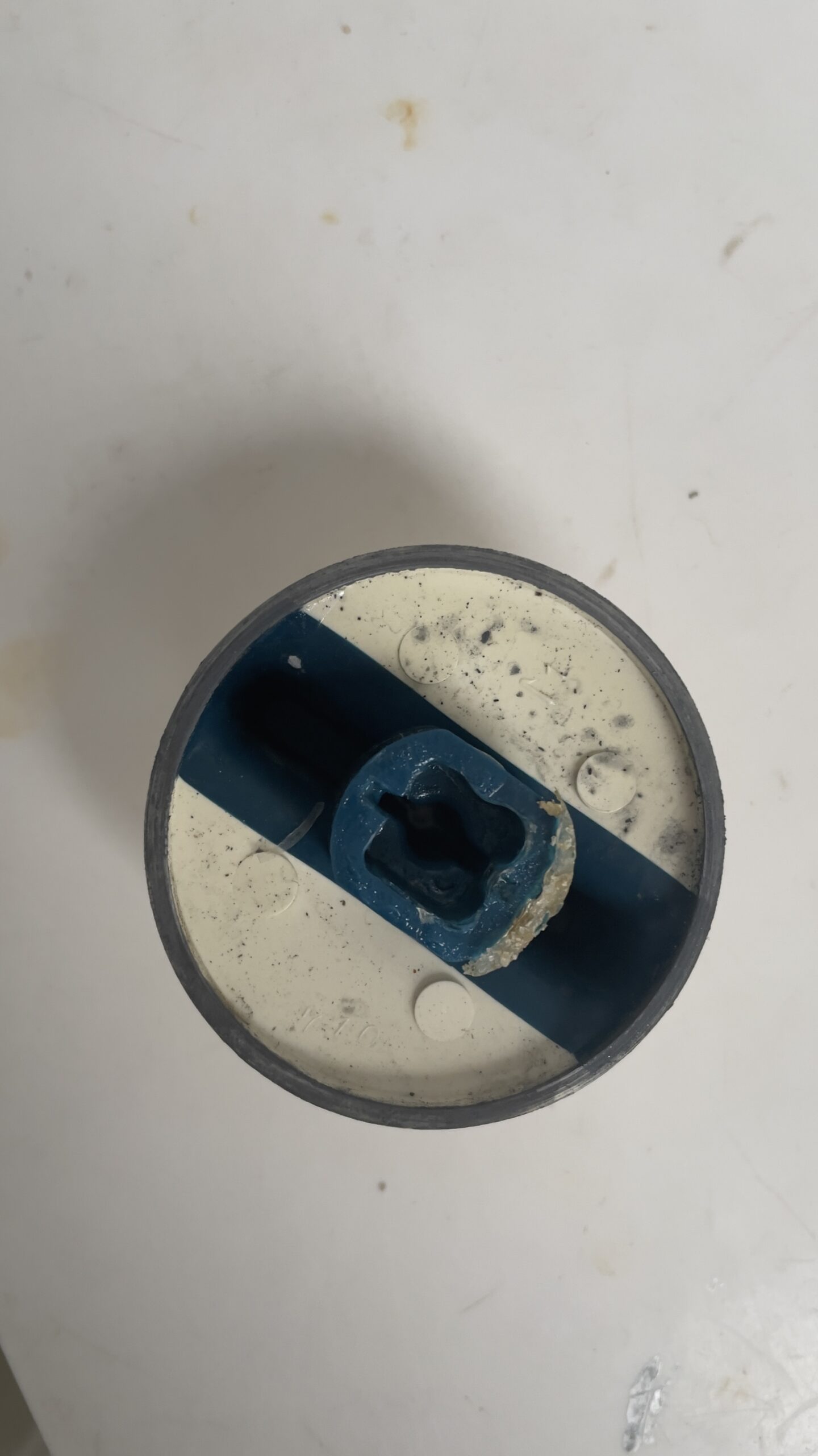

I've been trying to find replacement knobs for this old Sanyo twin tub washer, but specifically the middle knob cuz it's different from the others. i cant find them anywhere, so I was wondering if anyone has a print of these as a last ditch effort

This is the sort of small part that really justifies the use of 3D printing and is not too hard to learn to design.
I don't have the washer but that's an interestingly shaped insert - I assume the part looks something like this:
In which case the following OpenSCAD code creates the shape but I don't know any of the measurements - OpenSCAD is a free download so you can measure the part and edit-in the correct values.  The pointer_angle allows you to change the zero point and will probably need to be a multiple of a right angle.

wow you're a life saver thank you so much for this. I've never 3D printed anything tbh, so i was planning on sending it to someone to 3D print it for me, but i  did measure the knob just now

You will need more measurements - work through the parameters in the script and replace the placeholder values until you get an acceptable rendering and then send the resulting .stl file to your printing friend - for a precise fit you may need to trial-print, tweak a few decimal places and iterate a couple of times.  All measurements are in mm except the angle in degrees.
