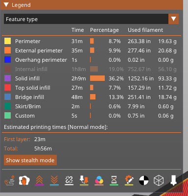

Export Slicer summaries in CSV format
I would like to be able to import this summary Slicer information into Excel to be able to compare different ways of printing a file.   It is not selectable text, and using OCR on a PDF of a screen capture is simply a mess. CSV would be fine.

I did something similar to analyze gcode and config.ini settings. It takes a g-code file, config.ini and compiles an excel XLSX with charts and tables. It's still very much a work-in-progress still.
Have a look here: https://github.com/hyiger/gcodeToExcel
Can run like this:
python gcode_to_excel.py --config config.ini 3DBenchy_0.6n_0.2mm_PC_COREONE_1h6m.gcode
Make sure to scroll around the sheet since a lot of the charts are further down on the page. Make sure to follow the installation instructions in the README file

Ah! Thanks for the clue about the GCODE file. For what I need, which is really just the Sliced Info, I can open the GCODE in a text editor and copy/paste the first 24 or 25 lines into Excel.
