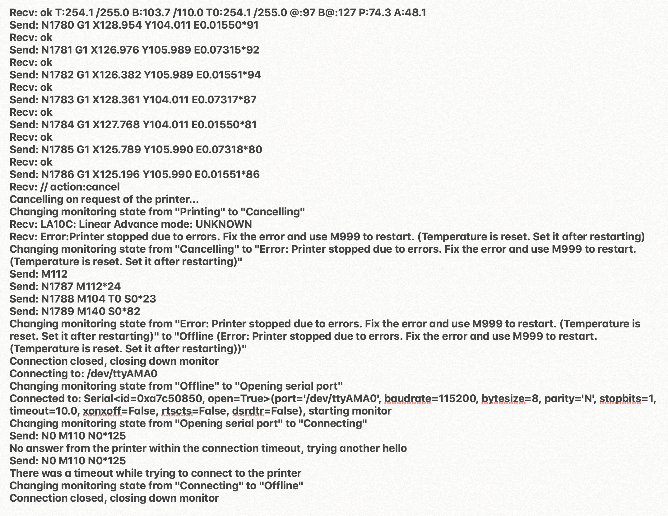

Emergency Stop: Error M112
Does anyone know what might be causing this?
I print 1-3 layers and it stops and spits out this error.
Error M112 Error M112

RE: Emergency Stop: Error M112
That looks about inline for something like thermal runaway, which will put similar messages on the console.
@charles-h13 are you running firmware v3.9 with Linear Advance? I noticed the "LA mode unknown" message. Is it possible you have some old M900 Kxx commands using LA1.0 values? The reason I ask is discussions like this that mention a reset when the newer firmware is unable to parse old LA1.0 values properly.
@charles-h13
After installing the FW 3.9.0 I would re-calibrate the LA for each filament and enter it in the slicer. Conversion from 1.0 to 1.5 is not optimal and can lead to incorrect results.
Posted by: @charles-h13
I guess I don't understand this error.
I can't say it's directly related, but the sequence of messages matches up with problems reported with the implementation of Linear Advance in firmware v3.9. The firmware supports both LA1.0 (M900 Kxx in the range 10-100ish) and LA1.5 (M900 Kxx in the range 0-2). If you have LA1.0 values in your filament startup gcode, or have tried having both, there can be conversion issues. I'm not sure that's the source of your M112 hard stop, but the sequence looks right. I'd try powering off, clearing any M900 Kxx gcode commands and trying again.
It might also be worth doing a factory reset and recalibrating the printer as there are big differences between firmware v3.8.1 and v3.9. Even prior to this update, I had occasional issues when upgrading firmware. Since resetting my LA values to 1.5 values, I've had much better results with v3.9 and have elected to continue using it.
@bobstro
M900 is no a part of my startup code, but it is a part of my end G code.
Interesting. It may be a red herring, but that error log made mention of LA values. Are you certain there's nothing in a default Prusa filament profile? If not... perhaps try inserting a manual M900 K0 to make sure there's nothing left in memory. Any chance that error occurred after an aborted print in which your M900 end gcode didn't execute?

cwbullet
(@cwbullet)
Solution: Factory reset.  It stopped happening

bobstro
(@bobstro)
Looking at the commits to firmware 3.9 on the GitHub pages, I see one referencing M112. Looks like it's a known issue and will hopefully be resolved for the next release

bobstro
(@bobstro)
Posted by: @karl-herbert
[...] so let's wait for good things for the 3.9.1 or later versions 👍
No idea if it's the fix, but I've now seen a couple of threads indicating mysterious M112 errors since upgrading. I haven't had the issue myself, but I am re-doing all my Linear Advance settings. The GitHub notes mention an issue with Octoprint.
This resend request becomes very problematic once Octoprint is streaming gcode to the printer. The printer would signal Octoprint to resend line 1, but that is not possible anymore and M112 would be sent to the printer.
@charles-h13 are you using Octoprint?
