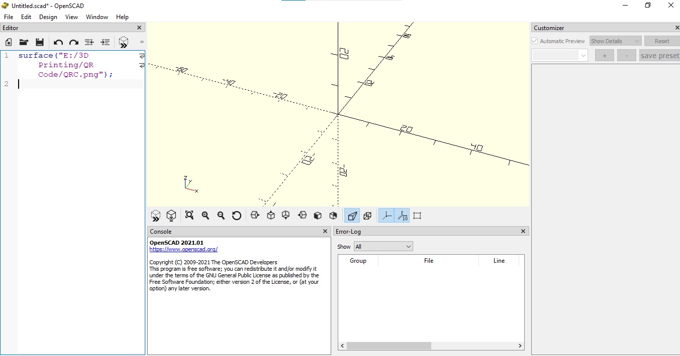

eager
(@eager)
RE: Embed QR Code into a 3D Print
Diem.... Thank you for sharing that. I've used OpenScad once and that was to convert a scad file to stl.
When I open Openscad and choose Open to find the QRC.png it only says it's loooing ofr scad files.
So, I dragged the QRC.png into AutoScad and the attached is what I see.
Not sure what I do next?
Thank you so much.
Posted : 10/05/2025 9:35 pm
You need to tell OpenSCAD to render the one-line-script you have generated:  F6, or the second button in the view pane, or button at top, or the design menu - this runs your script.  Once run you can export the result - STL button at top or any of the formats in the File > Export menu.
But I doubt your single line will give you a useful result, it will be far too blocky.
You have effectively auto-generated the "/path/to/qrcode.png" part of my mini-script above, copy and paste in the other lines and you should have control of the dimensions.
Posted : 10/05/2025 11:12 pm

Copy and paste my five line script above into OpenSCAD's editor.
Delete the file-path in quotes and copy and paste the file-path in quotes from your one line script into its place.
Render.
Export an STL as above.
Open TinkerCAD
Click the “Import” button in the top right corner. You can then drag and drop your new STL file into the window; and from there, it's over to you.
Posted : 11/05/2025 6:35 pm
