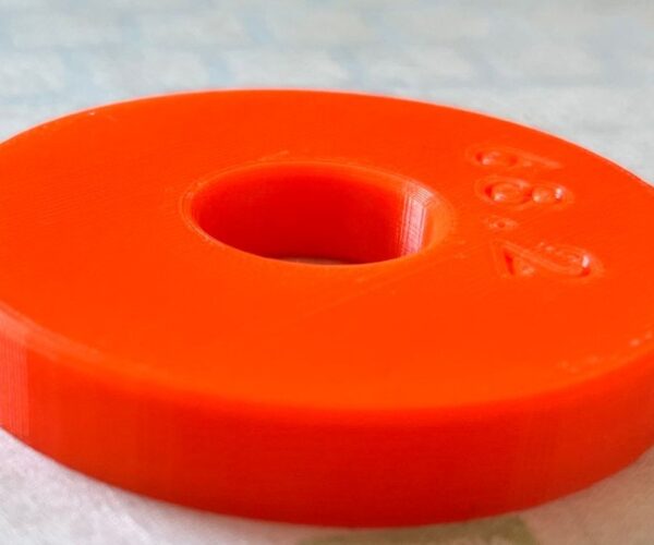

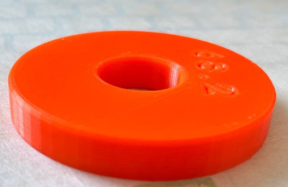

Hello.
I want to print some bushings and I have problems with the roundness of the part. It looks like the big circle is made from interpolated circles. How can I make more smooth and eliminate this problem? Any ideas of what settings I might make?
Thanks.

If you have access to the original CAD file for the part you can try to increase the export quality/resolution there and export the part again. If you have access to the CAD you can also try to export it in STEP format. PrusaSlicer can handle this format.
Or you can try to enable the arc fitting option in PrusaSlicer in case this is not enabled yet: Print settings > Advanced > Slicing > Arc fitting

Is this an STL file from the internet or your file from a CAD program?
A little tip: most STL files are not of very good quality (for round objects).
If you created this object yourself, export it in STEP format—you will see the difference

right after I made the post I exported as STL with higher resolution and I can even see the changes in the Slicer . Seems much better. I will try also as step after this one. Thank you!

While I agree with the advise to transfer from CAD to Slicer using a STEP file (I do this exclusively for my own projects), there is a caveat to remember. When the STEP file is imported into PrusaSlicer it is converted to a triangle mesh. The default detail value is sufficient that you won't see any faceting when printing normally, but if for some reason you need to scale the imported STEP significantly, then you'll start to see the triangles.
This can be mostly ameliorated by selecting a higher resolution when you import, though. You just need to remember to watch for that instead of blindly clicking through the import window because that's what you always do. 😉

In the photo, the part is exported from Solidworks to PrusaSlicer as a 3mf. Changed to stl with good resolution and also to step, and it's much better. I also think this is the best you can get from the hardware. it has step motors , no glass scales etc. pretty round , good enough for my application .
