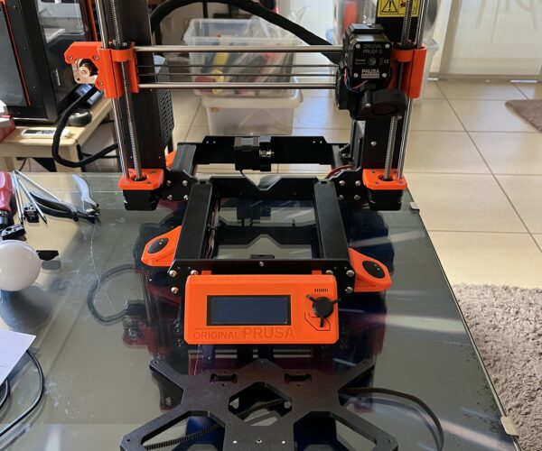

Hello,
This will be a slow build.
I am planning to only place one order to Prusa, to minimise shipping cost to Australia. I started with a Mk3 and have upgraded all the way to Mk3S+ to Mk4 to Mk4S to CoreOne. I have a lot of left over parts, so let’s see what I need.
The obvious missing parts are a heat bed, y smooth rods and 2x 8mm linear bearings. I am going to reuse the MK4 y carriage parts. My plan is to built all parts expect the y axis, to see what else I need.
I will see how far I get and will update this thread.

RE: Can I make a Mk3S+ with leftover parts from Mk4S -> CoreOne Upgrade?
Well, after a week of building, I can confirm, if you have upgraded from Mk3>Mk3s>Mk3S+>Mk4>Mk4s>CoreOne, you can build a MK3S+ with the left over parts plus:
  1. A heat bed
  2. 2x 8mm linear bearings
  3. 2x 8mm y smooth rods.
Time to place my order.

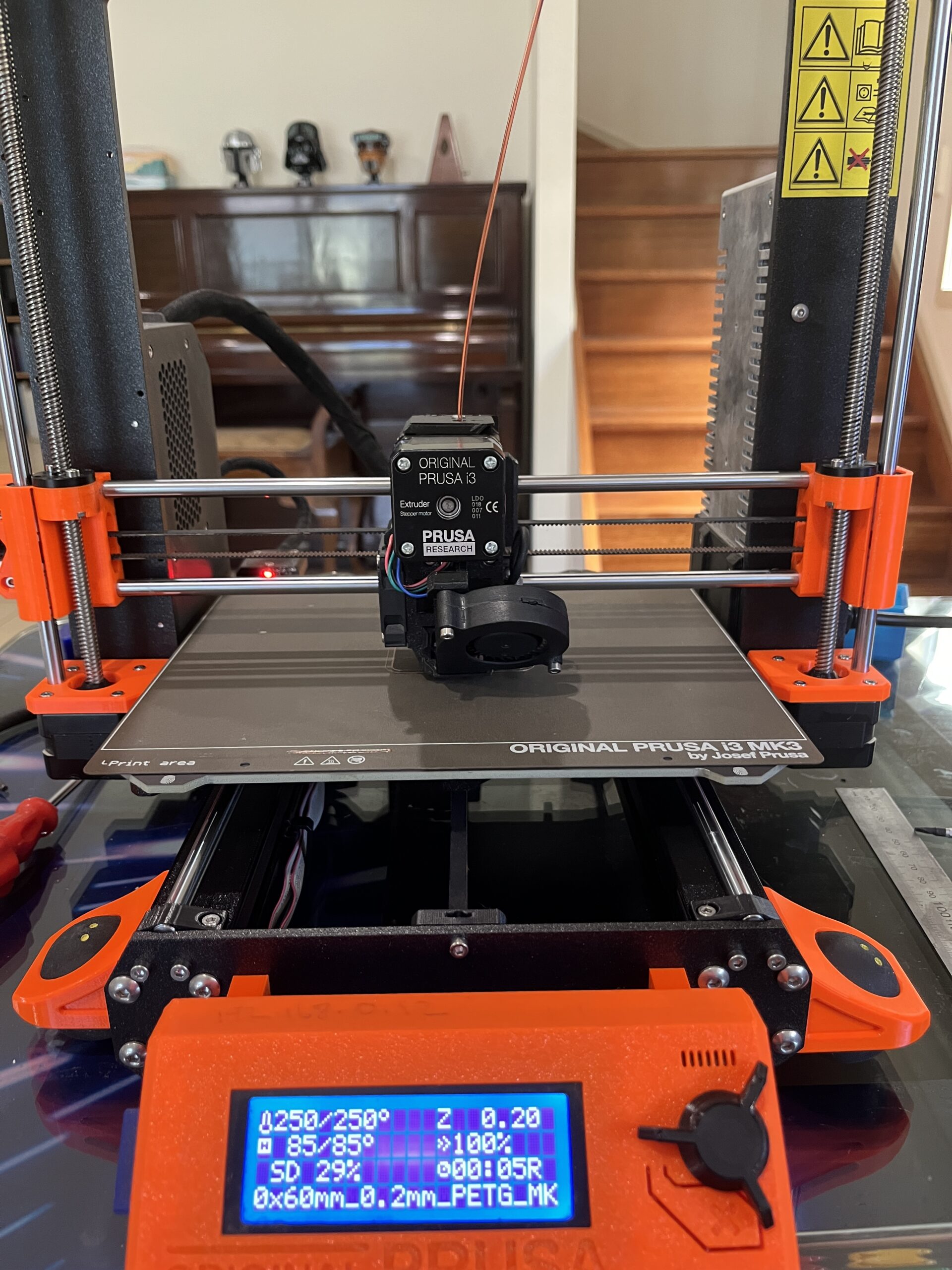

I can confirm, you can make a working Mk3S+ with the leftovers and the above extra parts. Nice to have a 2nd machine for single material prototype prints.
