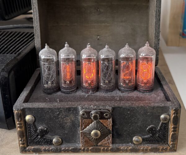

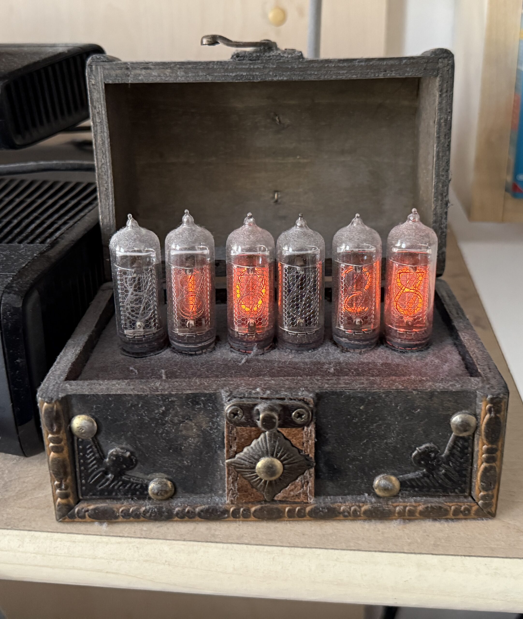

Lately i find myself complaining a tiny bit about prusa's printers. But in all fairness they actually produced great results on my projects. Following is an approach for a Nixie clock i build when i first got my XL. I uses the XL for functioning parts, my SLS for cosmetic and detail ones, my cnc for wood processing and my smaller engraver for  pcbs. It uses a nixie bar for temperature or second reading , according to a levers positions , humidity meter and motion detection.

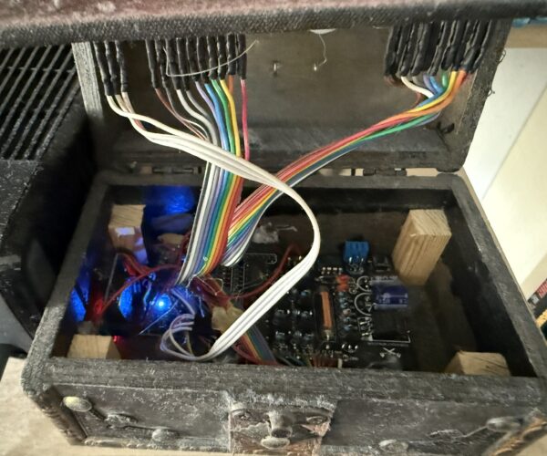

How do you drive the nixie tubes?
I have built some nixie clocks as well.
For the first one, I did the whole electronics by myself (with an arduino nano), and later I used the arduinix board, but I added a RTC module.
The last one uses a nixie driver board from aliexpress.
On the pictures not all digits are visible, because of the shutter speed.

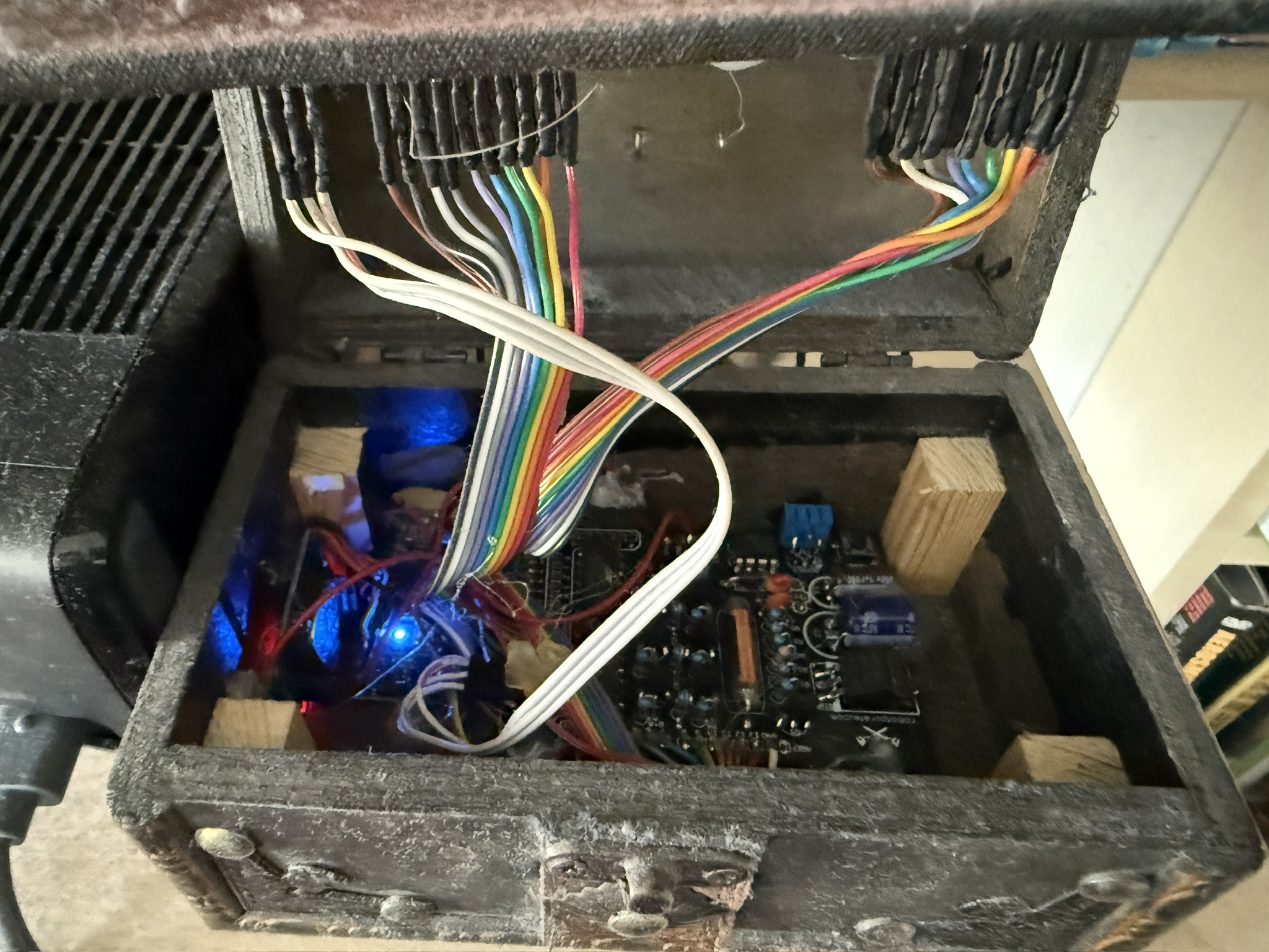

I actually use an arduino nano for the nixie digits along with a couple of 74HC595 SR and 4 nixie drivers. For the bar i made current regulator circuit. The humidity indicator its just a servo with a dht22. I just love the retro feeling of nixies.
