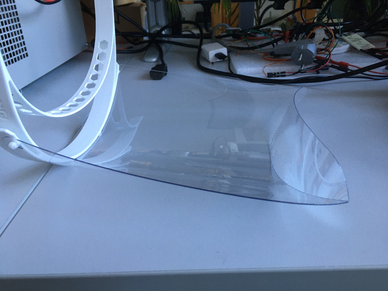

The lower sheet holder might be difficult to clean and to disinfect. With a slightly different design you may avoid this part, see picture. Laser cut of 0.5mm Vivak/ PET-G. Simply bend the sheet as needed. Its a dotted line, easy to bend. Just a suggestion.

Uhh, not possible to append a *.dxf?

Can you ZIP the DXF and attach the Zipfile!

Yes, i can 🙂 A short and a long version. The first print with perimeters > 10 is done and the print quality is a lot better, and with sligthly higher temperature no stringing at all. The infill algorithms have still much room for improvements...
