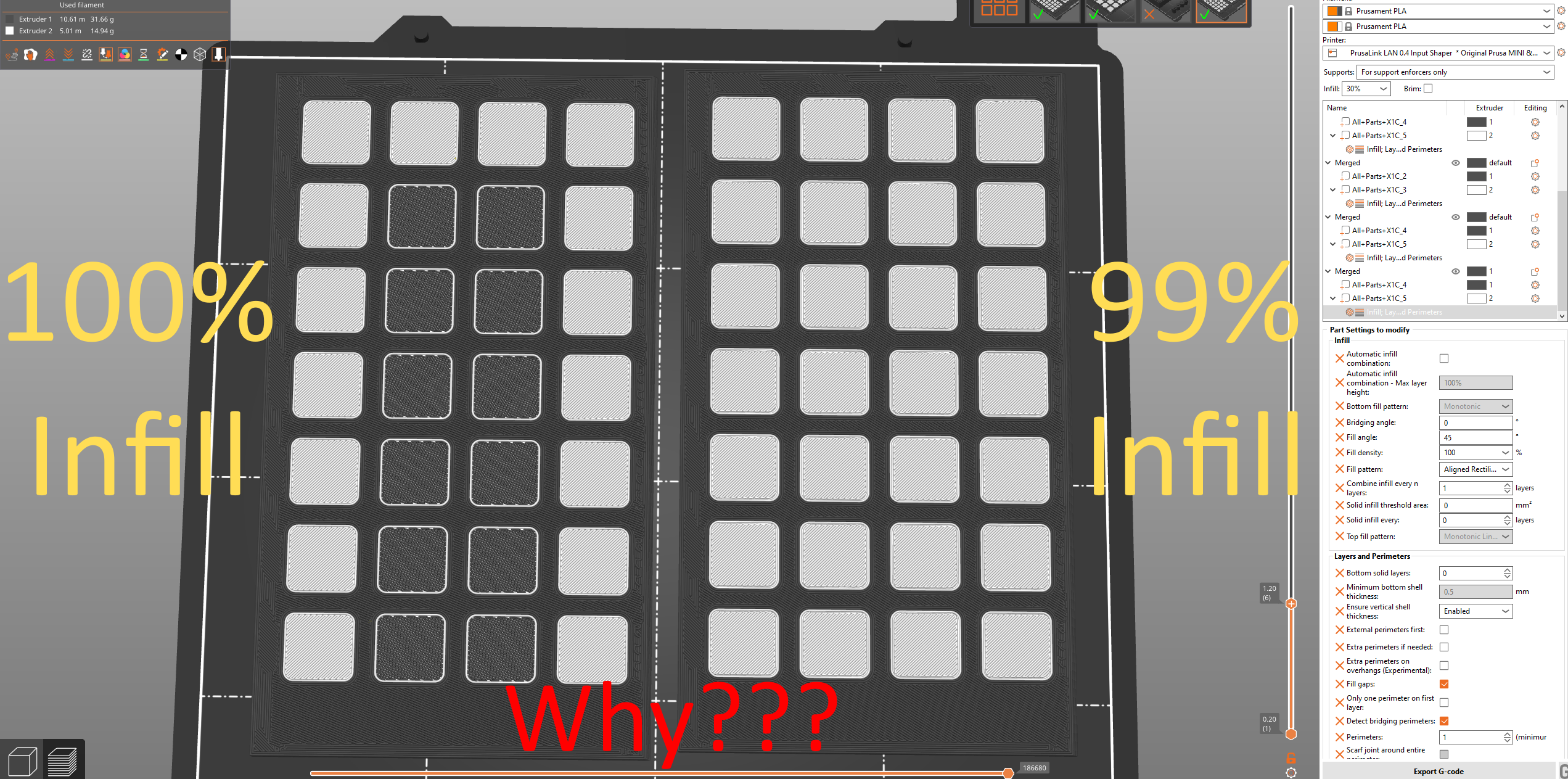

I am using PrusaSlicer 2.9.4 which is the current version.
Both objects are the same, all settings are the same. The white part is supposed to be translucent and therefore printed with 1 perimeter, 0 top & bottom layers, and aligned rectalinear infill to make it as translucent as possible using transparent or white filament.
BUG?
But for some reason the slicer wants to print the uppermost layer on some of these little windows with the other wrong filament, despite me having selected something else for this entire object. This strange bug occurs only when I set the infill to 100%, but when I make it 99%, everything seems to be fine (despite the infill not being at 100% of course).
What is going on here? How can I fix this?

here you go. I set one side panel on both side panel build plates to 99% and one to 100%. For the top panel 100% works.

RE: PrusaSlicer bug: 100% infill uses wrong extruder with multimaterial printing while 99% infill works fine?
Very odd, at 100% there is a layer of overhanging infill from nowhere - I suspect that at some point you selected only that central section and somehow gave it a different route to the same apparent result - however, as a workaround 99% should be indistinguishable.
In the ordinary way 100% infill is usually a mistake,   your use-case might be an exception but I would expect you to need to lacquer the print to improve the result.
I usually achieve this sort of thing (ports for LED indicators) by making the window only two or three layers thick and allowing the top and bottom layers to make it solid - no fill at all.
Clear should be OK but white filament is among the most opaque.
