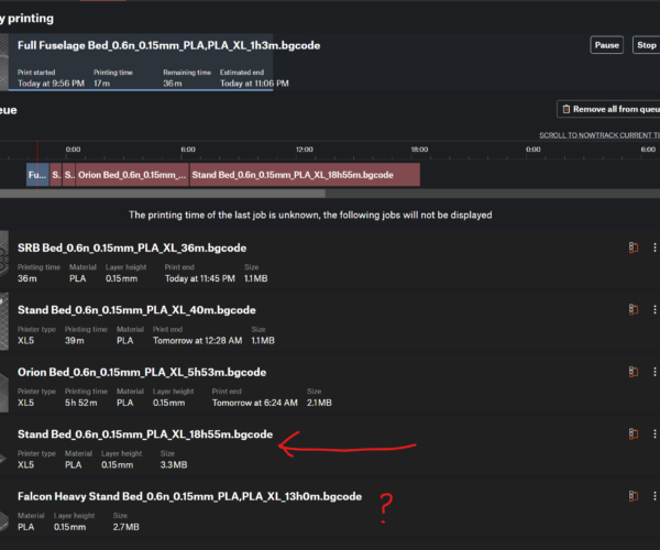

I like the bgcode in Prusaslicer 2.70 and MK4 on 5.1.0 firmware. However i am noticing couple of issues in PrusaConnect since using bgcode.
1) preview works fine on printer but it frequently doesnt show up on PrusaConnect. At least not at start, they show up later but cant confirm what triggers suddenly show them. Maybe random, maybe shows after i print the file for first time. Not sure. Sometimes shows instantly after upload, sometimes days later. Dont see any pattern.
2) it often cant get print details from the bgcode, such as print time. As example when putting files in queue, it tells me "print time is unknown" and then wont show the timeline

The failure for me is more to do to the print time missing.  I'm using the "Print Queue" for schedule management and the missing time results in a 12 hour block and missing any job past that point.  Once it starts printing it will correct itself and print without issue, but a repeat print of the same file still shows the same problem in the schedule.  I've tried re-slicing and file naming defaults, no differences. It seems random as my jobs at the moment use the same parameters in slicer, just different parts.  Naming of the files use consistent naming, like starting with beam A, beam B, beam C...  beam C has the problem and nothing I do seems to correct it.   BTW Slicer 2.7.1, MK4 5.1.2

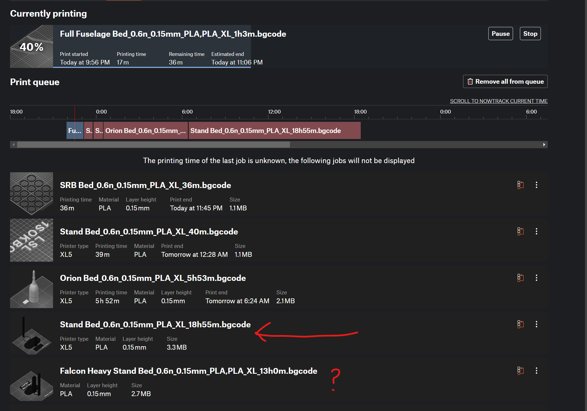

I'm also seeing this - starting today, interestingly. Certain files are displaying this message "The printing time of the last job is unknown, the following jobs will not be displayed".

I have the same issue. When stacking up a bunch of prints, apparently random prints in the queue will not have their duration appear in the timeline, and every job after them in the queue won't show up on the timeline. Deleting the file from the queue, reslicing and reuploading with identical settings solves the issue.

I have a temporary workaround for one of the issues. When you move the file from connect to the printer, make sure the printer and the file are in the SAME team. Hope this helps at least some of you. It seems like we have multiple issues mixing in here now.
