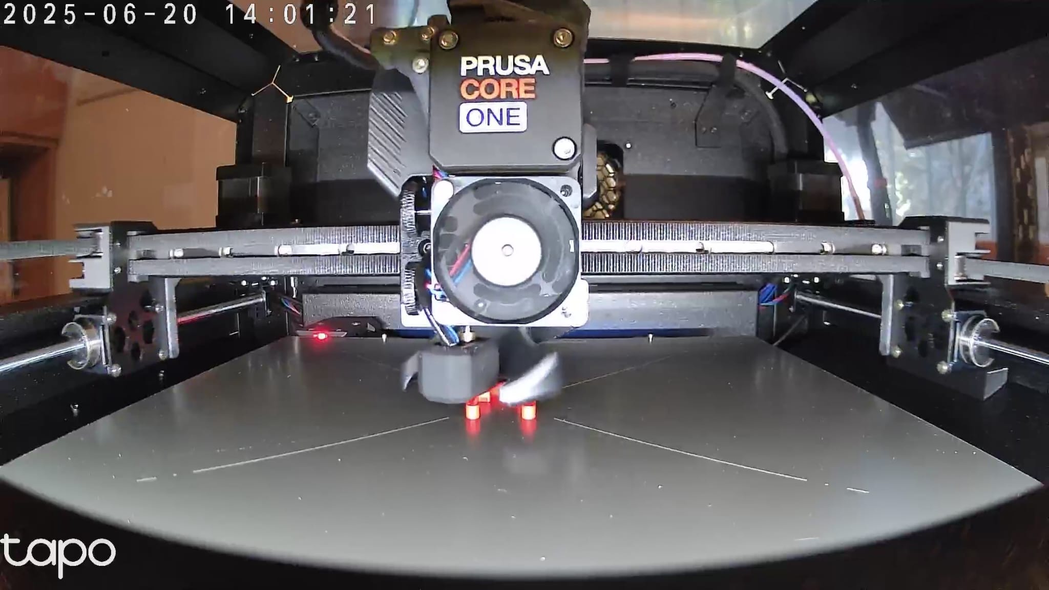

I love my CoreOne to bits, it is conceptually simple and well executed ... as long as you do not mention the lack of a proper camera. Having heard all kinds of bad things about the Buddy3D, I decided to build my own. I invested 25€ in a TAPO C110 camera, which will send real time high quality video to any smartphone or tablet over wifi, and designed and printed a bracket to keep the camera stuck to the printer door. It works wonderfully, real time, no server, not even any internet.

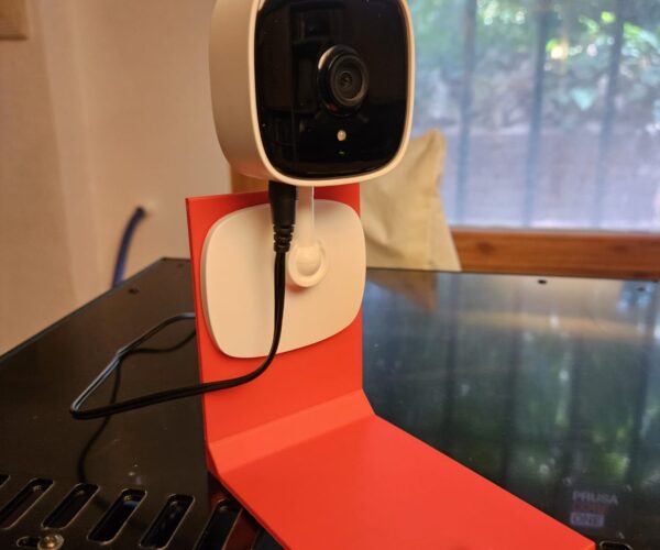

Here's the bracket. The camera attaches with double sided tape.

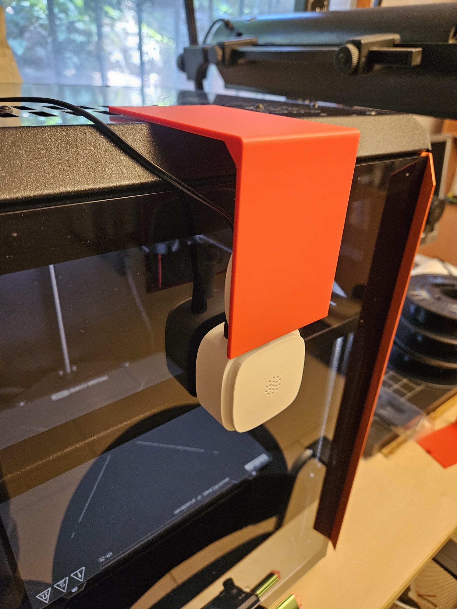

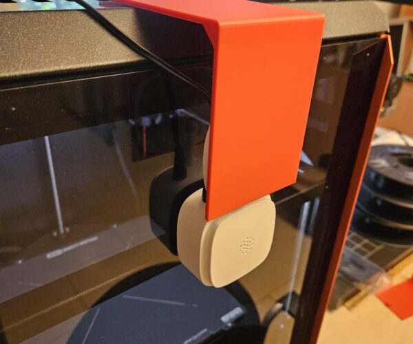

Here's the way it mounts to the door, hooking unto the ventilation louvers. The lens views through the door itself, just above the light bar.
And here's the image you get on your phone, in real time, anywhere in the house or even in the world (if you wish to):
The only catch is that you need to remove the camera before you open the door, which only takes one second.
If you are really cheap, you can get a TAPO C100 which only costs 20€ and still offers great video quality, and if you are REALLY REALLY REALLY cheap, you just drill a suitable hole through the door (Sorry, Josef!) and attach the camera to the outside of the door with double sided tape, no need for a bracket. And if you are REALLY REALLY REALLY lazy, don't even drill a hole, just stick the camera to the outside of the door with tape.
