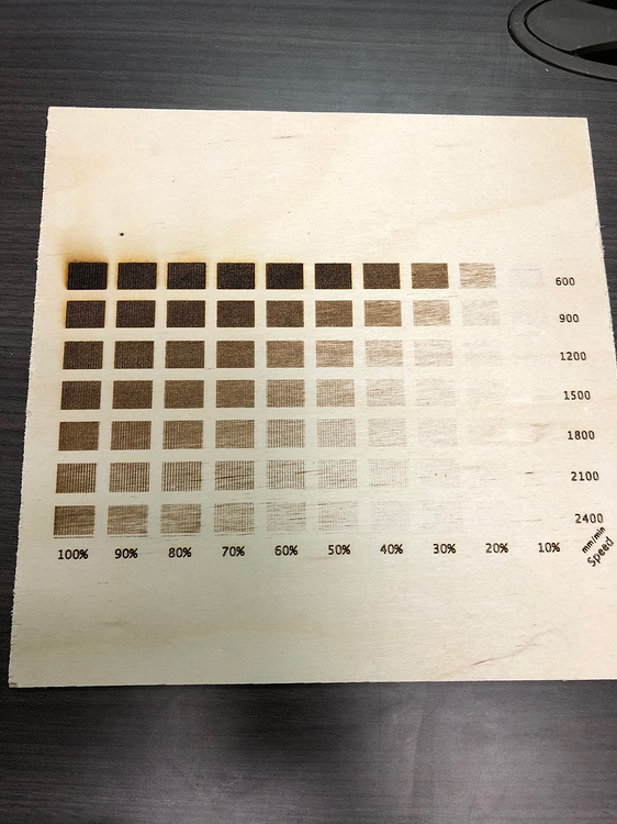

To be clearer about my question I guess, I have a laser printer that has a built in program that allows me to put in baseline parameters and then have it run a test cut to see what's going to work, which is essentially a grid with increasing speed on 1 axis, and increasing power on the other so that you can see what's going to be best (see photo). Is there anything like that for 3d printing? Because I think that would help tremendously.

Perhaps you are looking for a test called "temptower" to dial in your optimal printing temp. This could be the equivalent of the picture you posted.

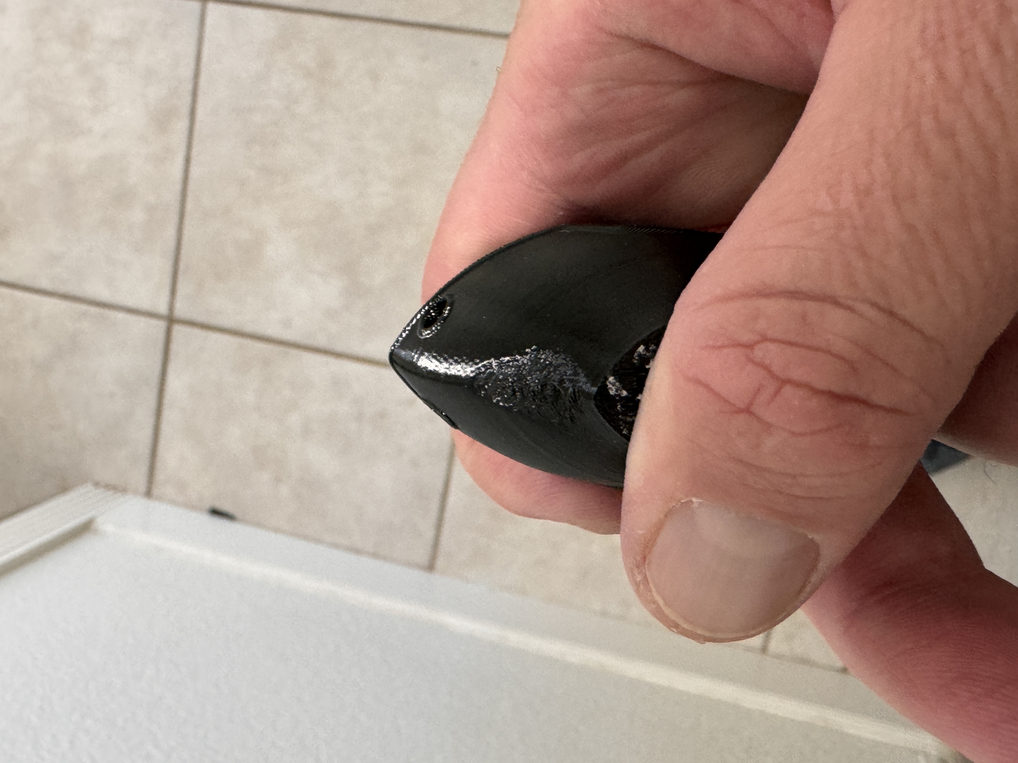

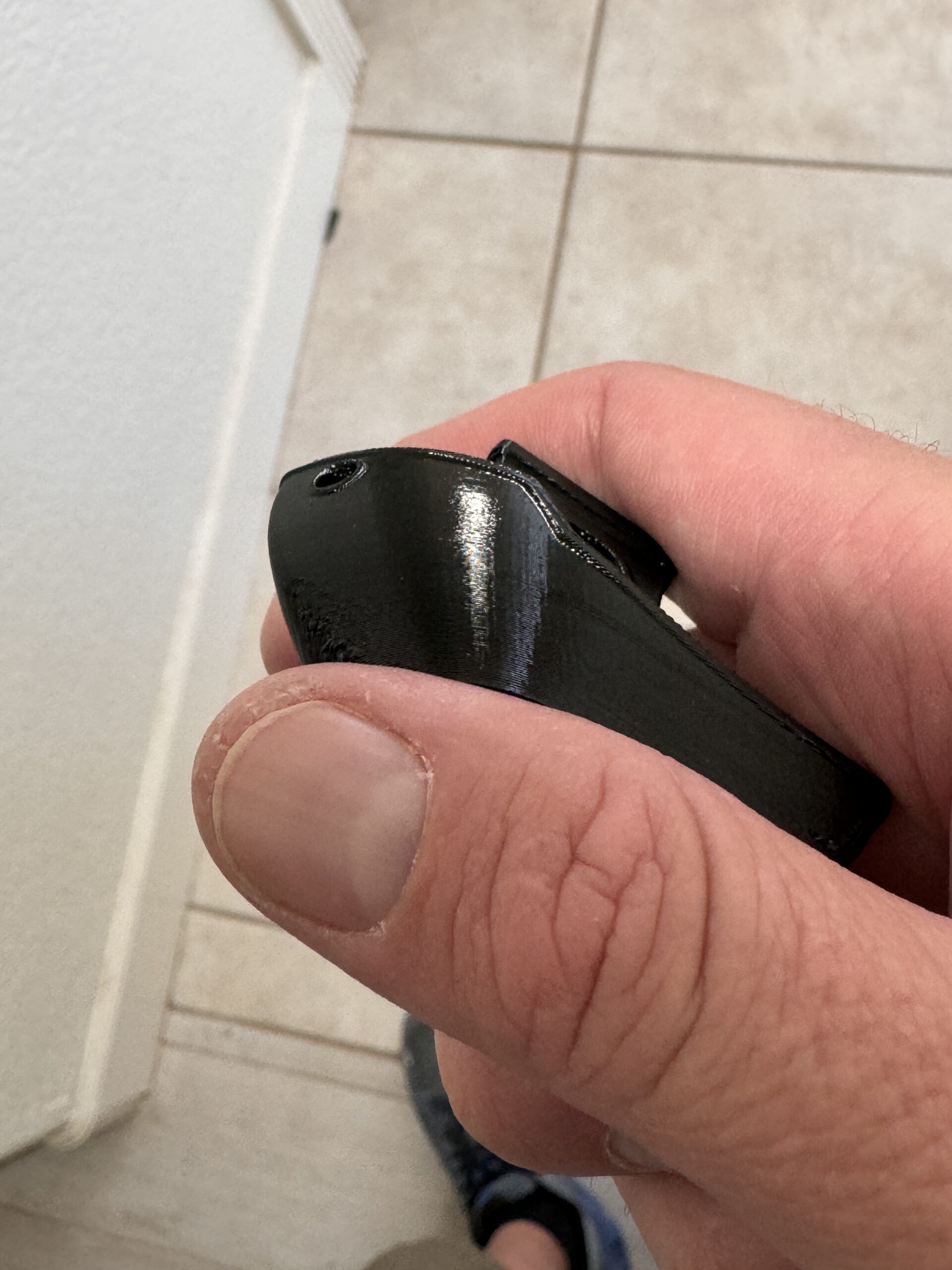

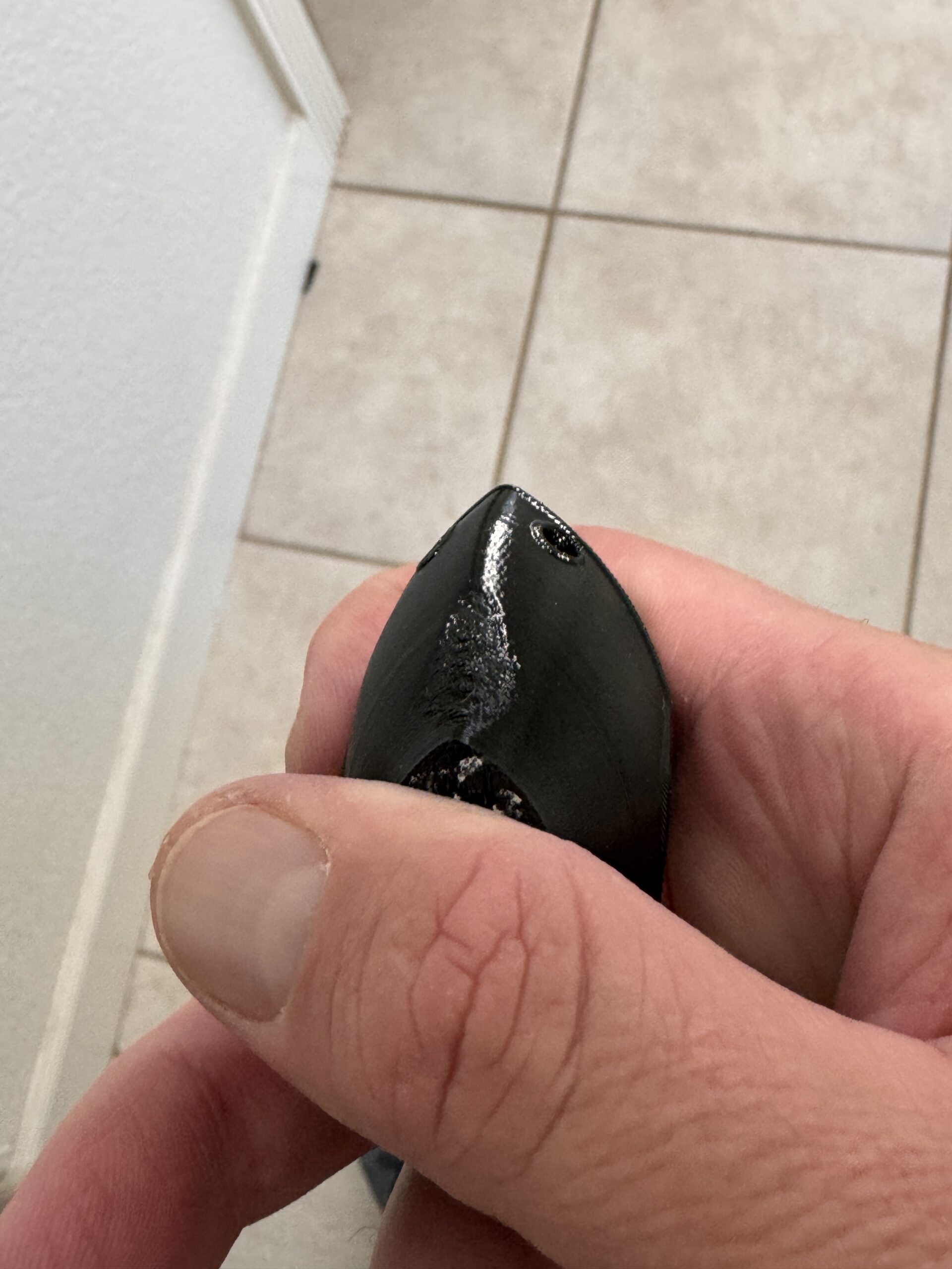

Okay so I made some changes, disabled IS, and found a profile for my Hatchbox PLA and the print came out GREAT! Then I tried my Overture PETG for the same print, and had a problem but was MUCH closer than I've been before, so I'm getting (cautiously) optimistic!
So I ran the "generic PETG" profile for it and had poor print quality on the bow. So I tried to figure it out and in so doing, I made fan run at max after 5 layers, fan on always, and changed the infill to rectilinear, dropped bed temp by 5 degrees, and none of them changed what was happening. The rest of the print came out great so I don't think print speed or temp is a factor, but I'm lost where to go from here. Any thoughts? See attached photos for details.

Try reducing the hotend temperature by 10 degrees.

Okay I tried that and had the same issue with separation on the sides as well. Dropped another 10 degrees and it got worse. Added 10 degrees from baseline and it was horrible. So I THINK the temp I was at is correct being that everything looked good except that bow area. So what other parameters could I work with to dial that issue in?

It will not hurt to dry your filament also, i had issues with new spools of PETG until i started drying. mini+ seems to devour any filament i have used so far. but it must be dry.

How was the benchy oriented on the print bed? With the bow pointing to the front or to the back? In the latter case you could try to rotate the model to make the bow point the other way. Could be the cooling of the fan for overhangs is insufficient in this orientation. I arrived at better results for overhangs when I changed to a bidirectional shroud for the parts fan on my MK4. I have not researched for the Mini, but for the MK4 and the MK3xx there are multiple mods on Printables, so I expect there could be similar mods for the Mini.
