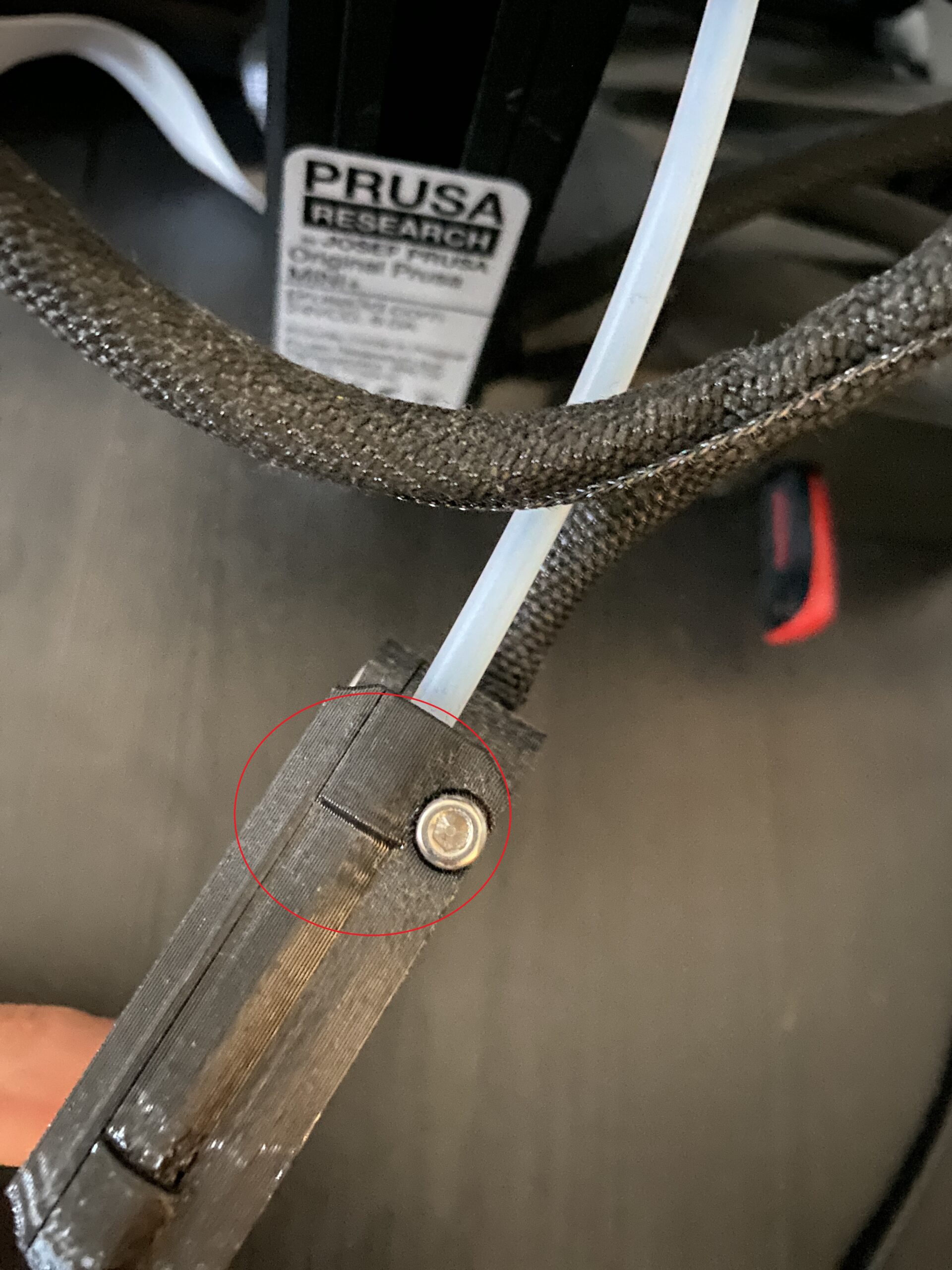

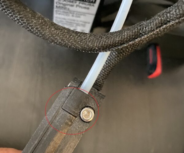

I recently purchased a second-hand Mini+ and after I purged the previous filament I was unable to re-load the printer with new filament as I couldn't seem to push it through the sensor up into the plastic tube even with considerable force -
I can't quite see it but when I look up the tube I can see something black blocking it (photo below with the stuck filament circled)
How do I go about removing this please? I checked the manual and I could only find reference to blockages in other parts of the printer Blockage circled in red
Best Answer by karl-herbert:
The Prusa Mini filament sensor can be easily disassembled for cleaning and repair purposes.
https://help.prusa3d.com/article/ir-filament-sensor-troubleshooting-mini-mini_230431
