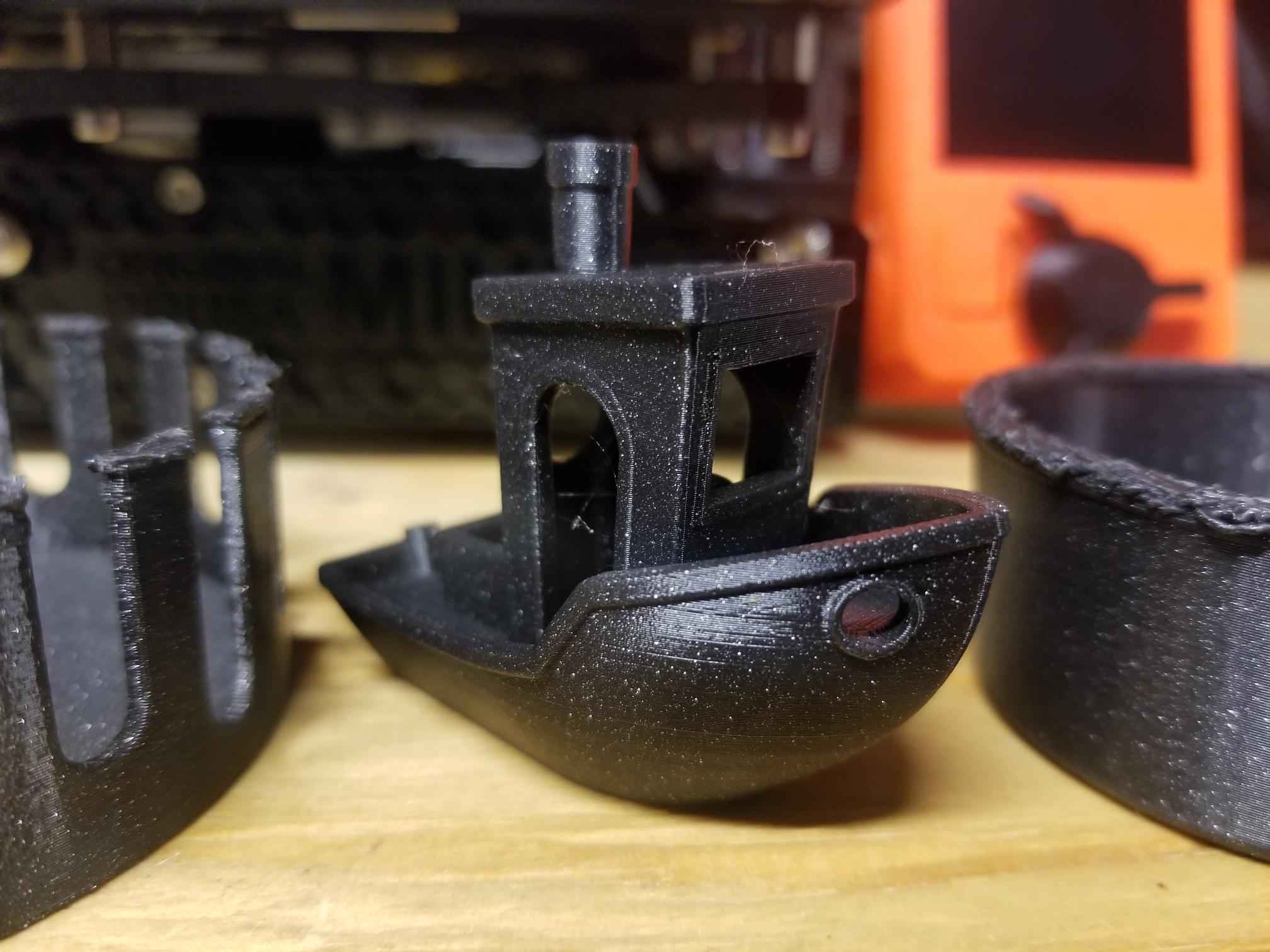

I have seen some recent dislodging issues so I thought I would share my experience here. I ordered the Mini+ Kit and assembled it and carefully followed the instructions (I have experience in assembling small scale devices, even though this is my first printer!). During assembly, the instructions mentioned to twist the z-axis screw by hand to raise the assembly... when I did this I noticed that it I had a tough time raising it. I failed the z-axis test. I loosened all the screws, tripled checked the alignment, and still failed the z-axis test. When it failed, it raised about 30 mm above plate and then stopped. After much more similar tinkering, it passed the z-axis test!
I then started printing. The frog came out well (for a first print). Then I started printing larger objects. The printer would not rise above about 30 mm (despite passing the z-axis test that I continuously conducted) and would continue to print, which would eventually push the piece off after some accumulation on the top layer.

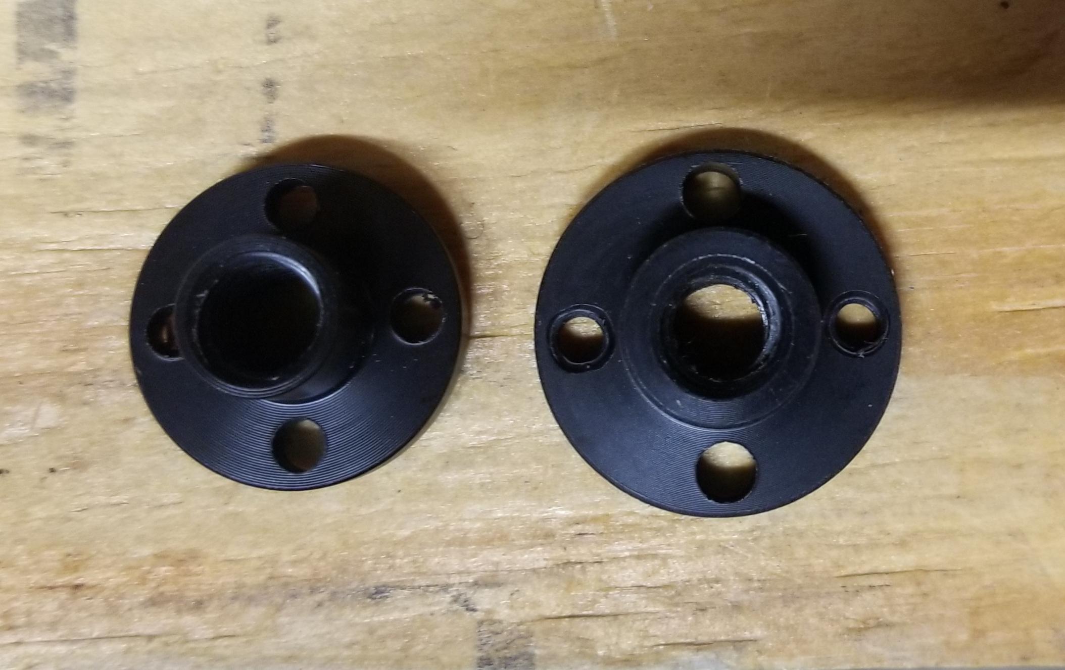

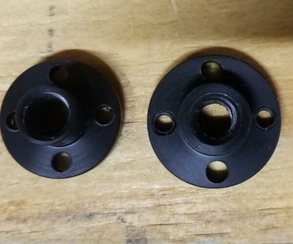

While waiting, I decided to try something and it worked. 😀 Out of curiosity, I ordered some other nuts (TR8, 2 mm pitch, 4 mm lead) that are not Prusa's. I threaded them on the z-axis with no significant resistance. Although the threads matched, the location of the fastener holes and other dimensions did not. I had to modify two holes in the new nut to carve a "slot" for proper placement of the fasteners. I have had no issues with my (few) prints so far. Pictures below are of Prusa's nut and the ordered nut (before modification).
This means that my prior problems are either due to (i) the manufacturing of the two trapezoidal nuts provided by Prusa and/or (ii) the threads on the z-motor. Hopefully Prusa will process and replace the z-motor thread (as the service chat said they would) to see if that was the original issue. I'll update this thread if that is the case.

I hope Prusa hasn't had a recent bad batch of nuts or threads. But hopefully we can identify the issue.Comparison of nuts
