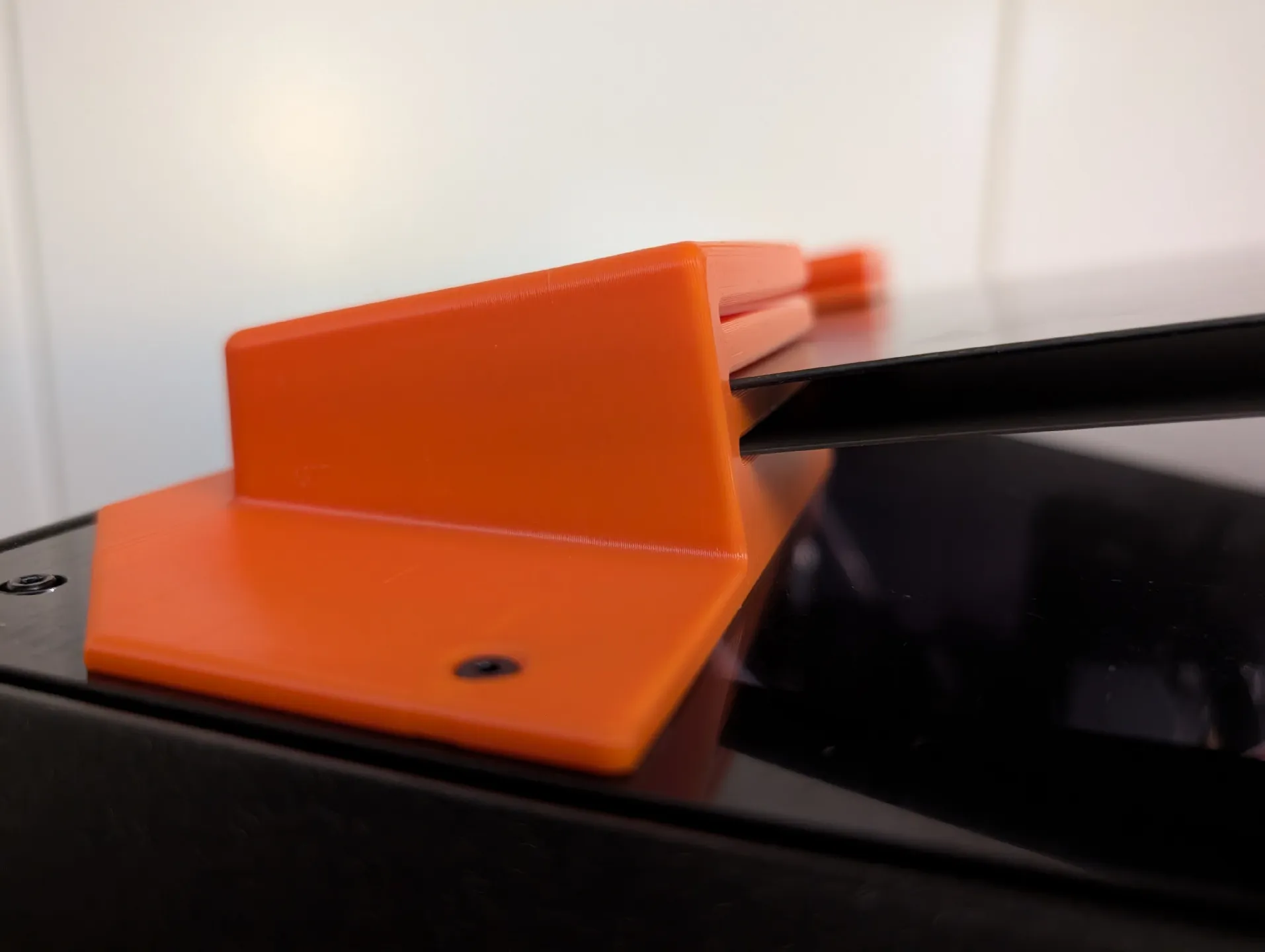

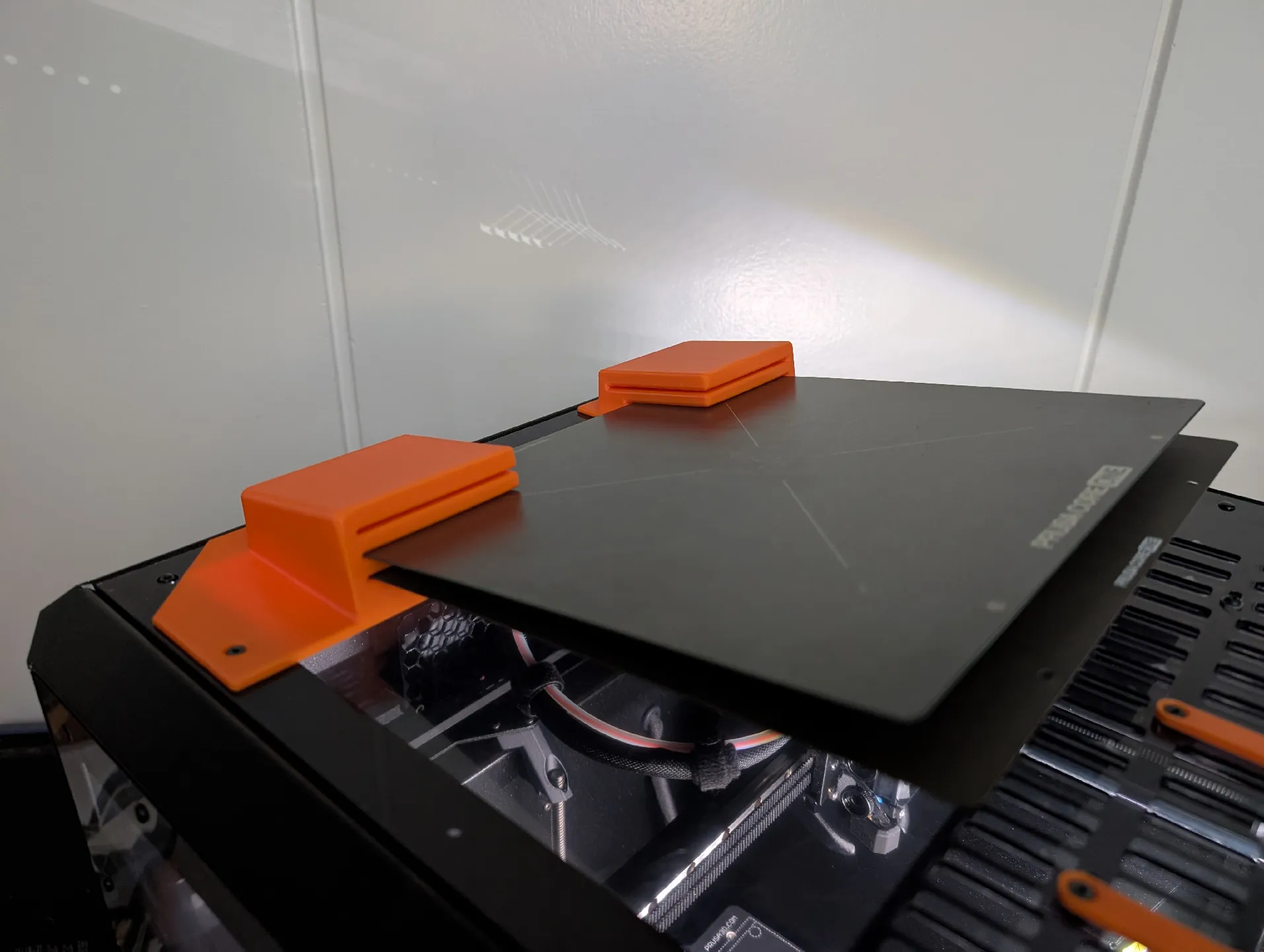

        On Top Print Plate Holder
This is a print plate holder for storing print plates on top of the Core One. Attaches to existing holes with M3 flat-heads, lock washers, and nuts. I printed in ABS and used an orientation that needed no supports. I found supports too difficult to remove from the slots.
