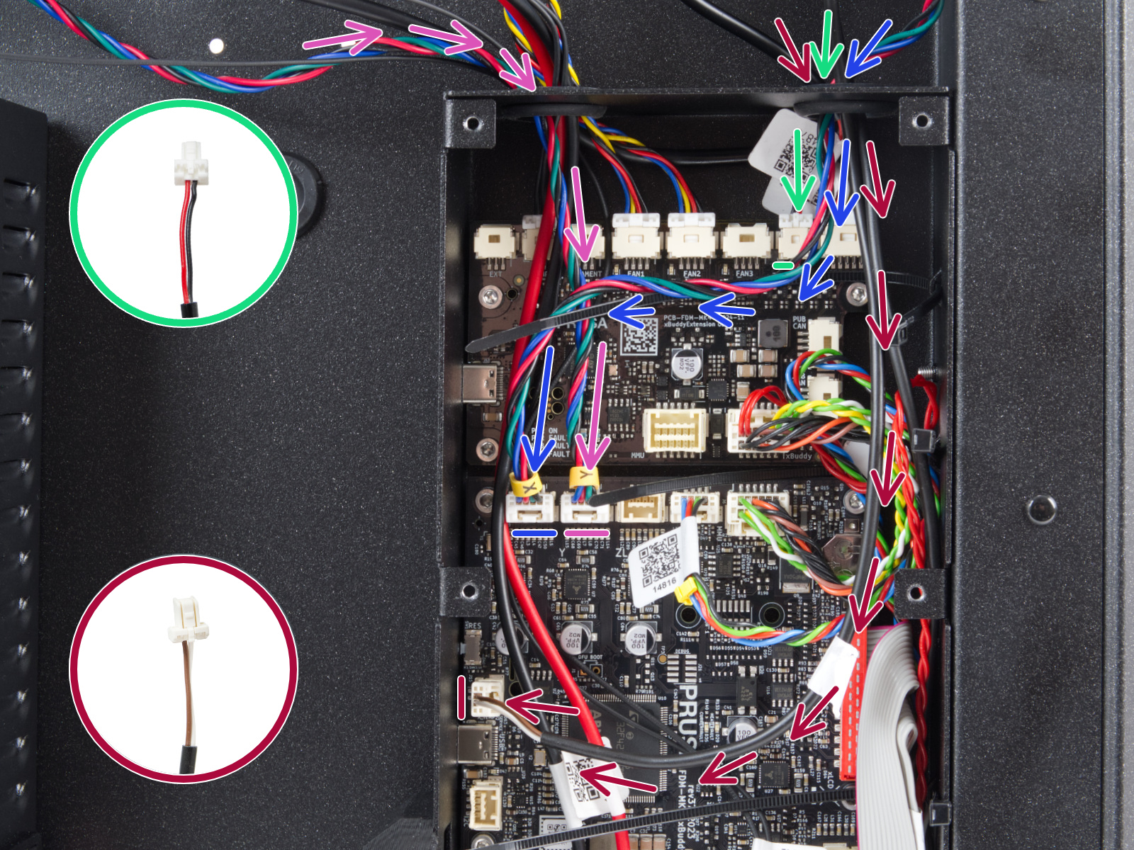

Homing error, it seems that my Core One starts on the opposite site - Question: Where is the mistake??
Hi !I did the same thing, the X and Y motor cables are swapped on the motherboard. Check it out, swap the two connectors and everything will be fixed.

I made the same mistake with swapping X and Y motor cables and only noticed after my first print.
