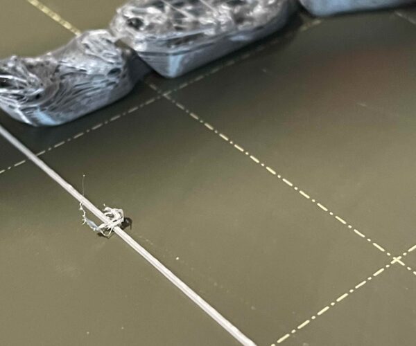

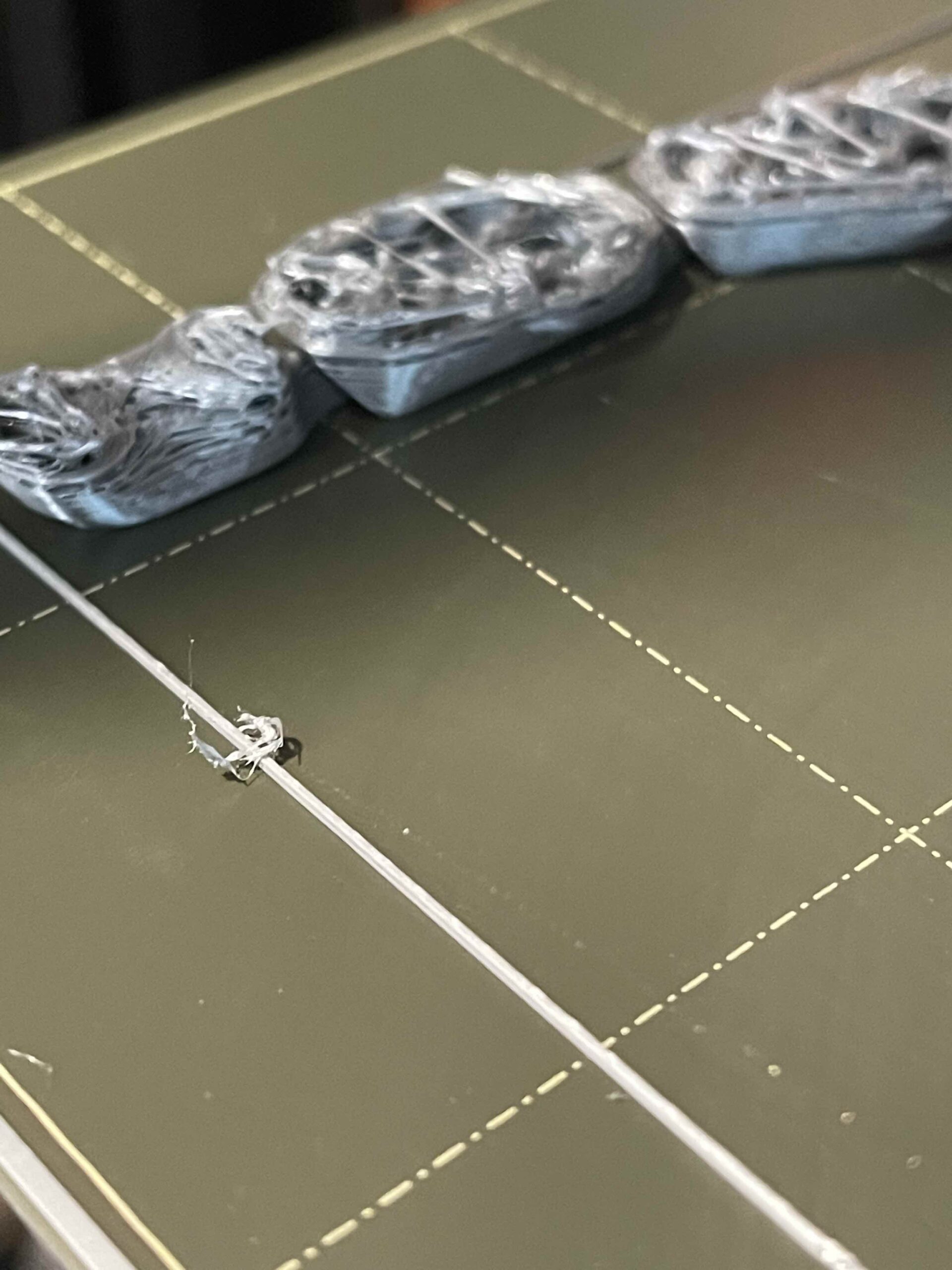

Thanks, I did another print at 225 and the retraction down to 1.8 but got the following results in the picture below. Should I try 230 then so I am closer to 220? What about retraction? Appreciate your thoughts.
Latest fail with Revo Micro (.6) Nozzle
Posted : 02/04/2022 6:03 pm

Okay, just to follow up. I took the collective wisdom and turned my temp up to 225 and reduced retraction to 1.8. I got several really good prints. However, I notice that there is a need for yet another upward temperature adjustment and now I am up to 230 to get this thing working again. Waiting for a response from E3D. I am certainly holding off on installing the V6 version I also purchased for fear of "losing" another printer.  Wondering if anyone else is seeing a steady need to increase temperature.
Posted : 04/04/2022 1:58 pm
