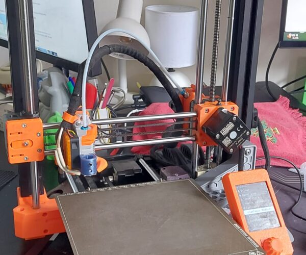

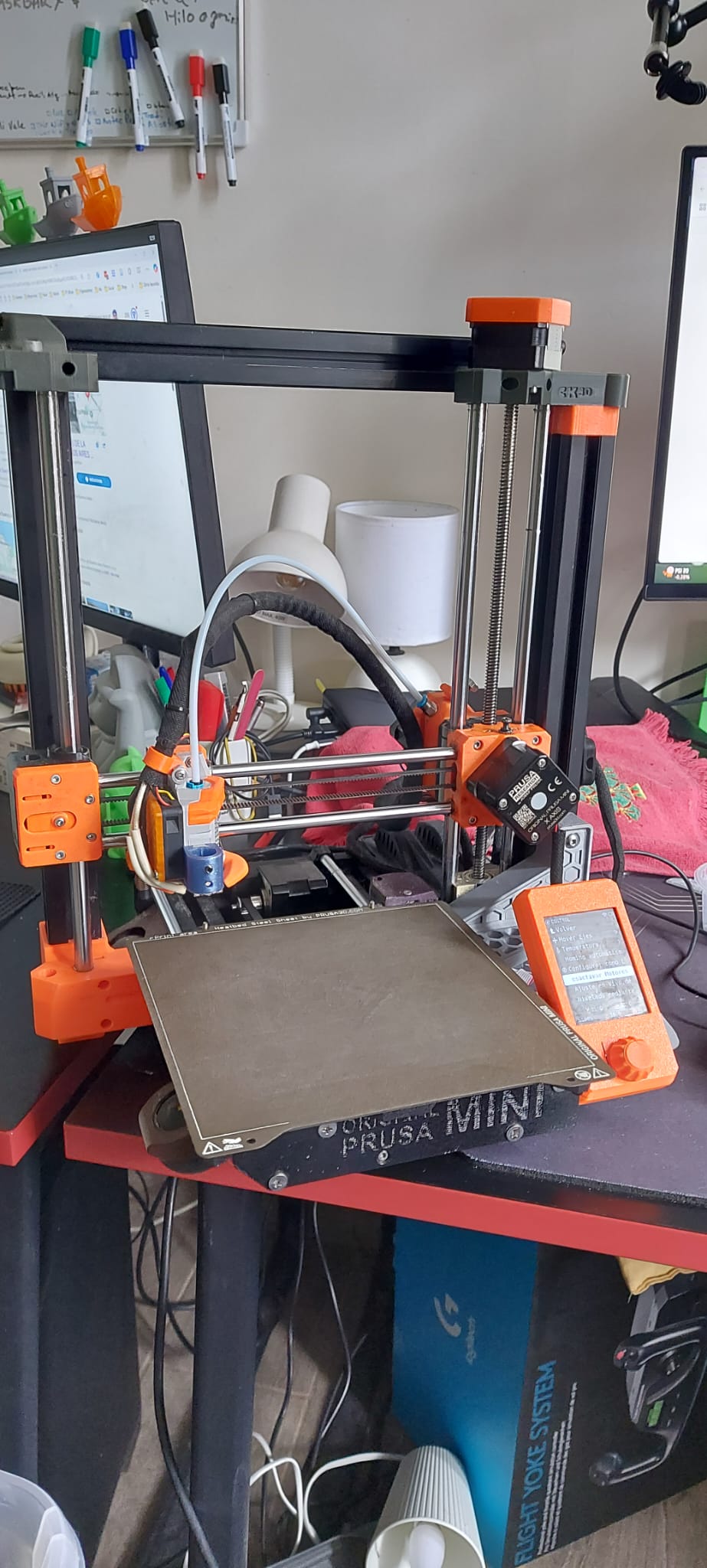

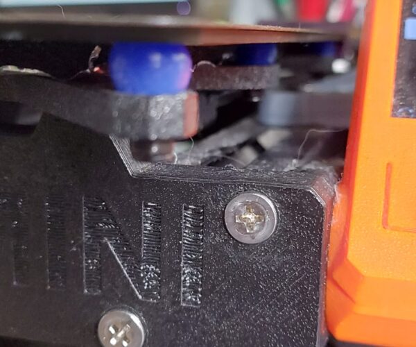

Today i do the Silicone Mod and at the first try i got this result:
Completely in zero(0)
 05/11/2024 12:49
Posted : 05/11/2024 12:52 pm
