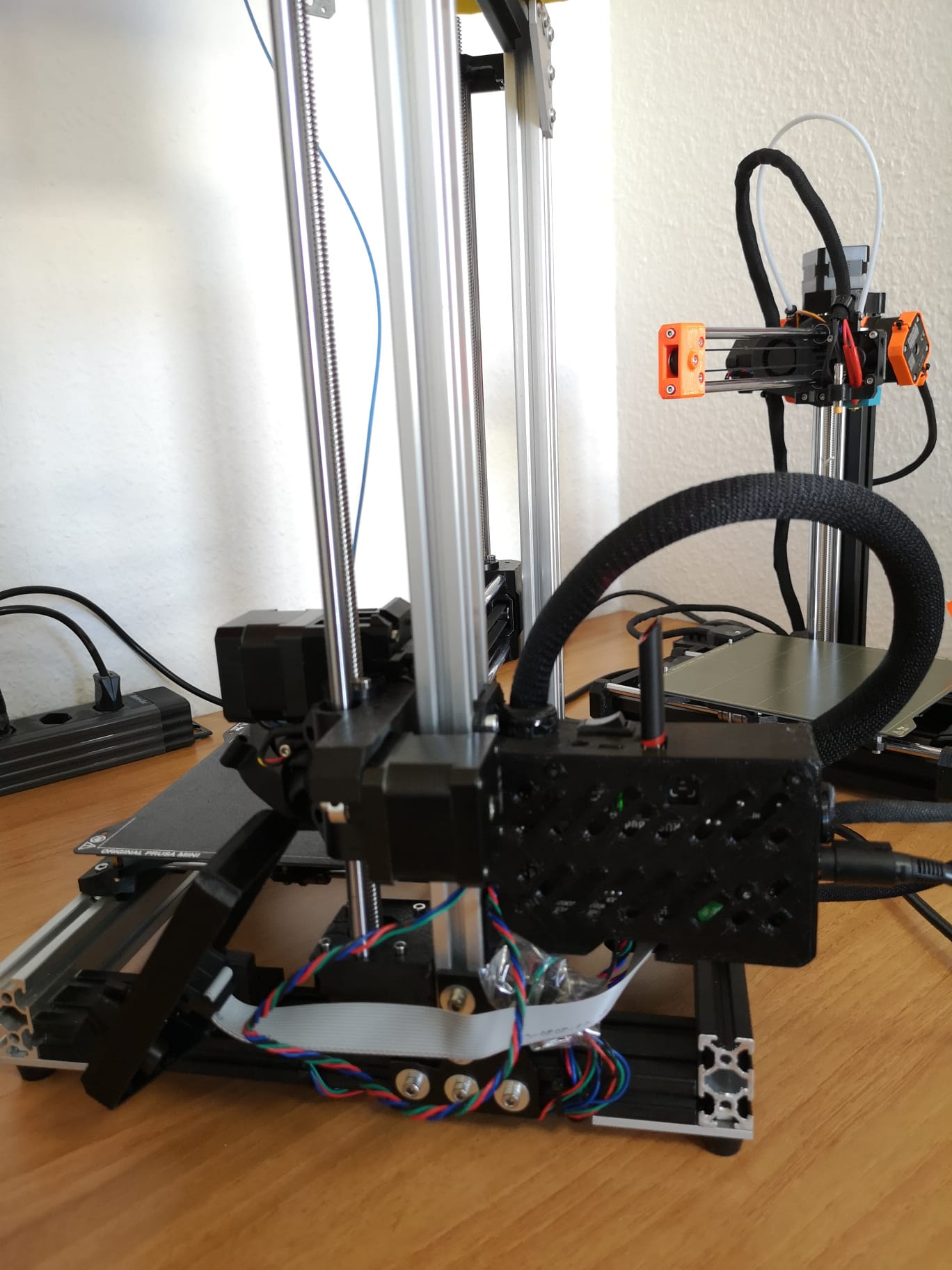

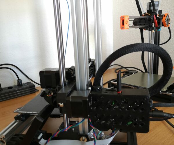

hi guys this is our mod prusa mini bear smokystyle check it at this link:. https://www.prusaprinters.org/prints/37939-prusa-bear-mk3s-mini-ultra-upgraded. Cheers and happy printing. It prints better than mk3s and way better than Mini. We are glad to share.

We ordered some 3030 aluminium extrusions to do the other version the haribo upgrade, what would be fun to use the extruder gears for the directdrive we will post soon a work in progres using the mk3s e-axis directrive with the mini gears. lol a lot to do 😉

Yes there are, the haribo would cost cheaper les aluminum to buy, but we will make the haribo one as well and compare the costs, now to print the front and back plate for the haribo mini you will need a larger bed than mini thats the downside.

Hi Padigree, yes we have been using for our printing farm 10 of these mini babies and they do perform at our acceptance, bear in mind this is not Prusa official mini, its a modified one and we dont take responsability, so if you need help on building it let is know we are glad to help you 😉

I've had some time today to make it look a bit more like it's big brother haha. It's just a draft atm, have definetly to make some more editing to the x axis, all other parts are modded now to fit original mini hardware. So except the extrusion kit you would need a second Z motor. Everything else will fit. Used the 10mm z extrusions, so you'll gain some height. Either I'll buy a China buddy to remove the appendix or I'll make a whole new Klipper based firmware with an skr. Have to order the extrusions soon, also the motor, carriage and heatbed - so I'll give it a try to build a second "mini". I'll definetly stay with my genuine one. Replaced the rods with misumi a few days ago.

and in the project the z axis is reversed because an easier cable managment, it prints exactly as an prusa mk3s+, at least the 10 modified minis we have up and runing 24/24 7/7

How you connect two z-axis motor in motherboard?
I undestud, firmware src have multi z-axis motor preset.
You connect in parallels in z-axis controller? Have this controller power for two step-motors?

https://www.prusaprinters.org/prints/56315-dual-z-axis-for-prusa-mini-upgrade
everything is in prusaprinters or in github
