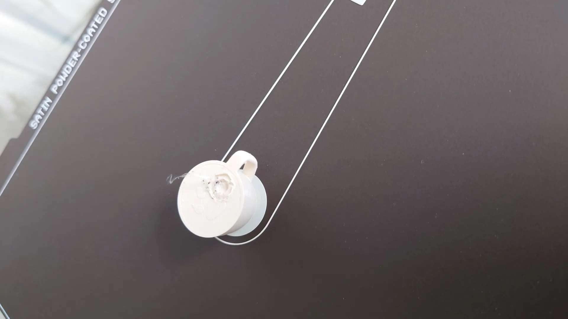

I'm using MK3S to print multicolored models. I enabled "Wipe tower" and also "No sparse layer (EXPERIMENTAL).
Until now I was using Prusa Slicer 2.5.X and it was working well.
After upgrading to Prusa Slicer 2.6.0 it will always lower the nozzle too soon and it will hit the printed model.
Some other users has the same issue too https://www.printables.com/model/404906-ark-nova-coffee-break-token/comments#preview-comment
Is there some settings to make it work again?

OK, I will try to post an issue on GITHub
Posted : 28/08/2023 7:04 am
Robert Kindl
(@robert-kindl)
It's already reported on GITHub:
https://github.com/prusa3d/PrusaSlicer/issues/11089
And there is also another reported problem that should be fixed which annoys me too.
https://github.com/prusa3d/Prusa-Firmware-Buddy/issues/3106
So PrusaSlicer 2.6.0 is huge downgrade for me as I can't print multicolor models anymore 🙁
