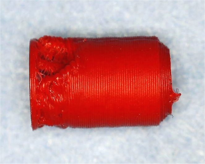

I just spent many hours trying to figure out how to get a decent print out of PS on a pretty simple (but tiny) part. I tried it in my Version 4.1 of Simplify 3D, and the first attempt was WAY better than ANY of the results I got out of PrusaSlicer.
This is far from an isolated incident. I have posted on the forum and GitHub on multiple occasions about print defects (especially the "buldge") that I have in PrusaSlicer prints that vanish (or at least get acceptably small) when I switch to Simplify3D. I can spend hours tweaking speeds, temperatures, cooling, retraction, etc. making incremental progress. I finally give up and plop the design into S3d with whatever profile I used last, and I instantly get far better results.
I really LIKE PrusaSlicer and the user interface, but there's something missing. Most of my prints come out fine, but when I have an issue, I can almost always fix it by going back to S3D.
Todays' example is a very small (4.5 mm diameter) cylindrical part. I started out with the Arachne slicer, and I was hoping the new scarf joint feature would help to make the outside relatively smooth & round. Instead, the lower section (which is hollow, with thin walls) was like Swiss cheese, despite the preview looking fine:
I tried a bunch of things, including the Classic slicer. I discovered that it goes bonkers if I have "Detect thin walls" selected. The prints were actually better, but here's what the preview showed:
Instead of actual holes, I got periodic dimples all around the perimeter of the base. I could fix the mess in the preview by turning off "Detect thin walls", but the prints weren't much better. I finally gave up and tried Simplify 3D. Right off the bat, I got this:
The seam isn't too bad, and it's actually vaguely cylindrical from top to bottom, with NO HOLES.
