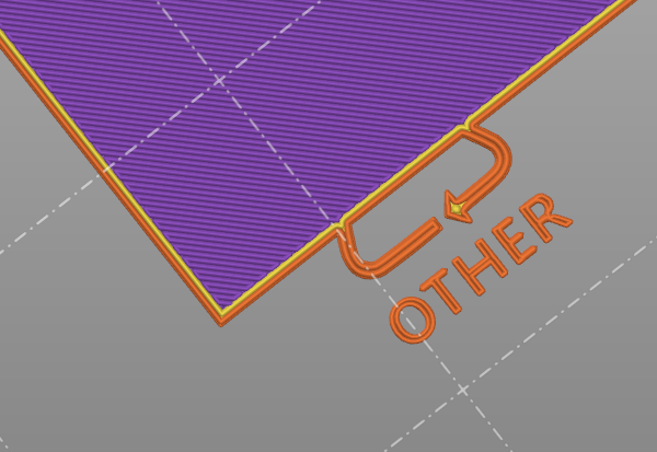

Using Pruca Slicer 2.9.0
On the bottom of a box i want to print this recycling_symbol which you can find in the part gallery. But i don not want it to be an extrusion (no point on the bottom of a box) and preferable also not as a negative volume. The overhang issue, well  mostly a mess.
What i want is that the nozzle is following the shape of the recycling_symbol, so the symbol is showing on the bottom side. But i can't figure out how to get there. I played with the order of the box and symbol (like you have to do with the helper_disk). I figured it is a matter of priority. Which part should fold himself around the other one.
Any idea's?

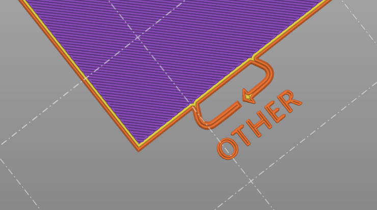

Do you mean like this?:
If yes, select the first part, right click add part > Gallery > Other .... Then you select just the symbol part (not the whole part you added the symbol to, just the symbol) in the Name panel on the right hand side and manipulate it (rotate, scale, move) to your liking.
