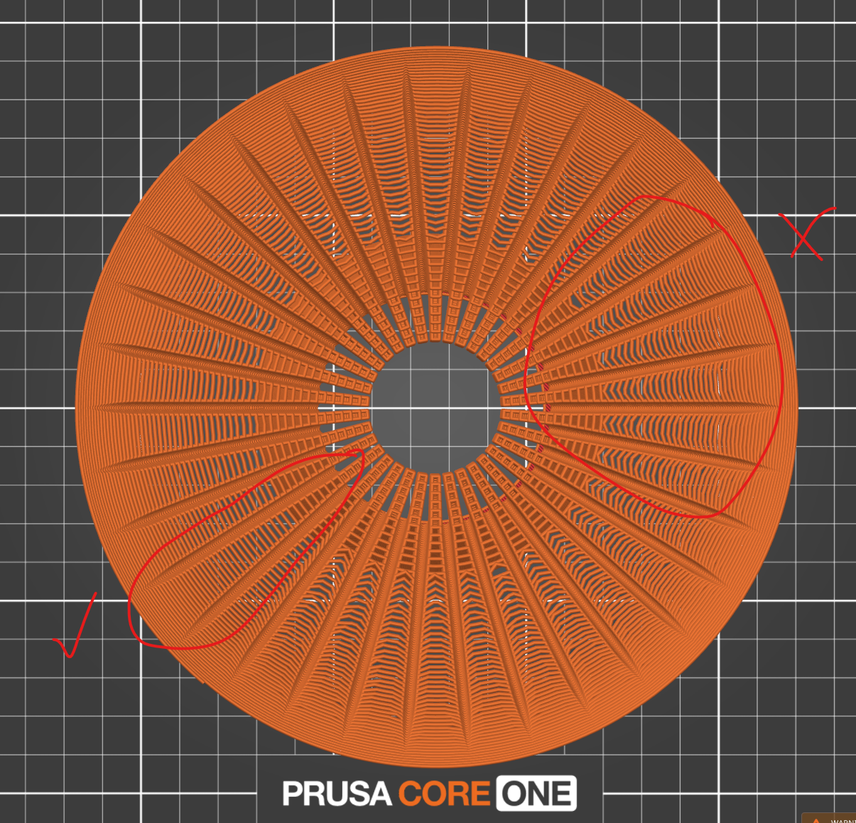

Some time ago I added a model to Printables:
https://www.printables.com/model/175751-mushroom-lamp-fast-print-for-e14-lampholder-with-s
That time I used Simplify3D to slice and print on my MK3S+. Now I like to be able to slice, print and monitor my prints - using PrusaSlicer / Connect.
This is when I stumbled on unexpected slicing behaviour in PS: (it is a lamp; the gaps between the bridges are intended in this sloped area, see link for earlier printed results)
top view overhang issue

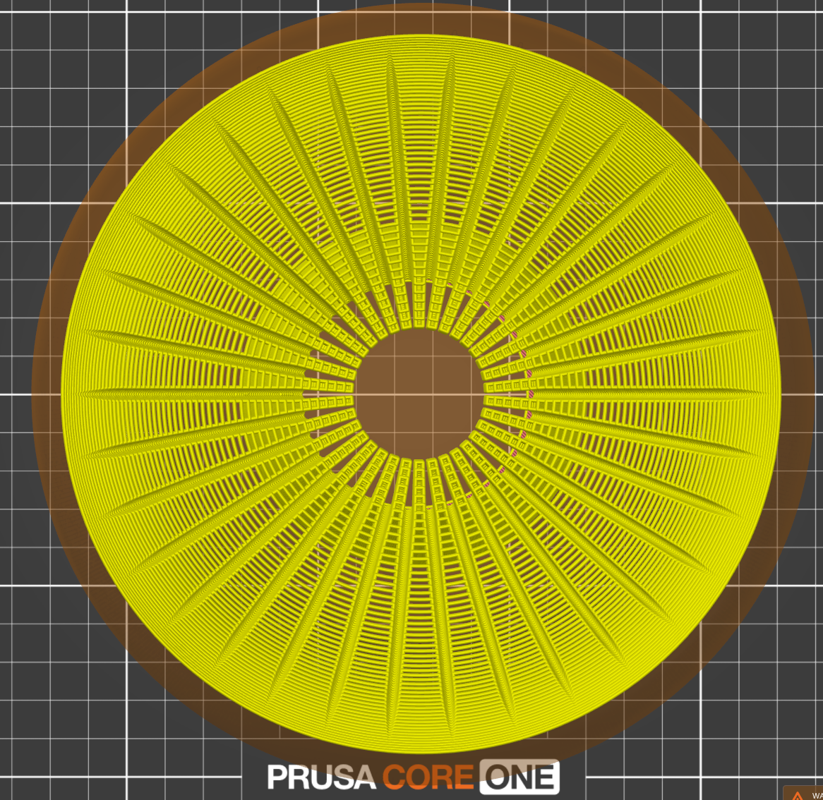

In the intermediate slicer state, the preview seems correct:
intermediate slicer state showing expected slicing behaviour
I have tried various settings like Arachne / Bridge related, but I does not seem to correct it.
Does anyone have a clue? I am using PS 2.9.4
