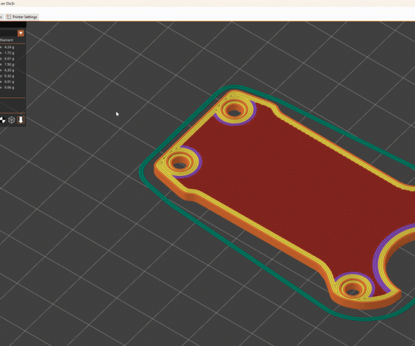

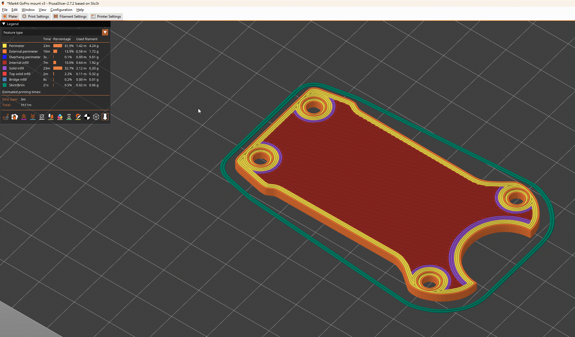

I think this also results in prolonged print time, because instead of filling the layer with a selected pattern all at once, it goes something like this:
I see the same issue in Prusa v2.7.2: solid infill results a complicated path after slicing.
