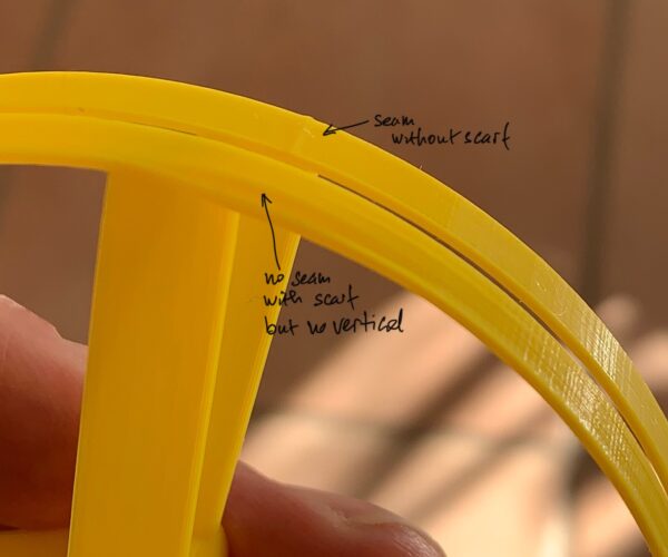

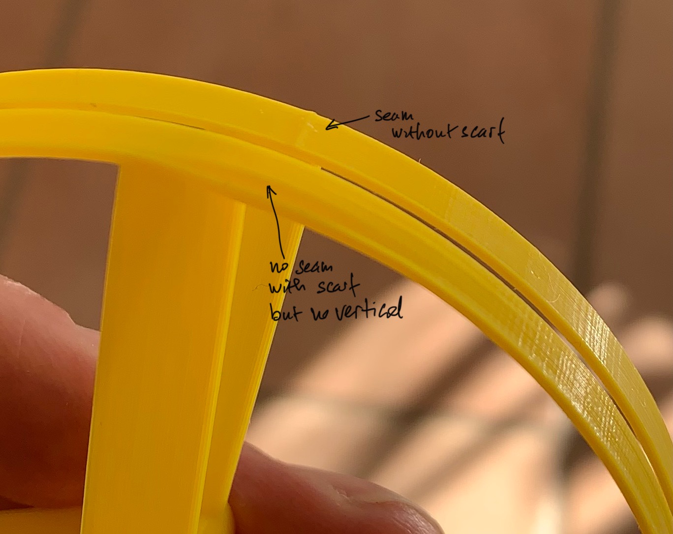

Another experiment on my side regarding seams on a light flying wing with 2 perimeters and .15 layer on prusament PLA and default profile on MK3S:
Without scarf, good print but obviously a small seam
With scarf, no seam but the vertical side is not vertical anymore with big deformation around the cylinder
I am still trying to understand the new parameters for the seam scarf !
