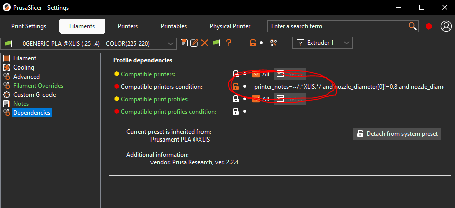

The presets that show up on the dropdown are based on Dependency variables.
Here's an example of this filament only showing up if the Printer is set to an XLIS preset (among other things):
Here's what the XLIS Printer profile Dependency section should look like. Notice the presets have no 'flags' on them, meaning they are compatible and show up in the droplist.
This is what it looks like if you click the "Detach from system preset" button. It no longer counts as whatever it once was (XLIS), therefore no longer fulfills the dependency requirement therefore profiles that require "XLIS", therefore is not compatible and will not show up in the dropdown (red flag).
I suspect your 'copy' Printer profile has been detached from a system preset.
The dialog box says detaching is irreversible, so you'll have to create a new profile copy and move your modified settings to that new one.

Poking around some more, I think I see what's happening. It looks like all of the predefined filament settings include a condition in the "Compatible printers condition" that specifically excludes the filament when the single_extruder_multi_material flag is set.
I can work around this by adding custom filament settings based on the filament I really want, and just removing that condition. But I don't understand why the condition is there in the first place. Why are the filaments all set up to just make them disappear when one has applied the single_extruder_multi_material flag? What's the point of that?
