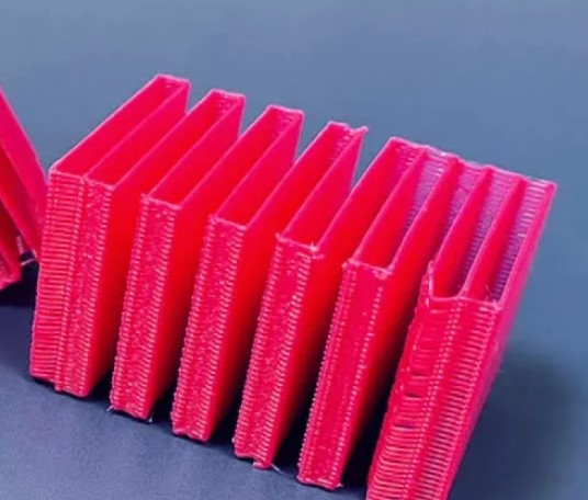

Is there a way to set the print speed of the first layer of interface material? For example, I use silk PLA as interface material. In some cases, I use PETG for support material. The problem is that when the first layer of silk PLA goes over the loosely spaced PETG support, it runs as full speed. Over support something like this:
Of course it doesn't bridge too well at full speed. The workaround is to set the interface speed to 50% or so, but then for subsequent layers it's just slower for no reason.

I can't make sense of the image.Do you have a sample file? I'd like to take a look at it in PrusaSlicer.
