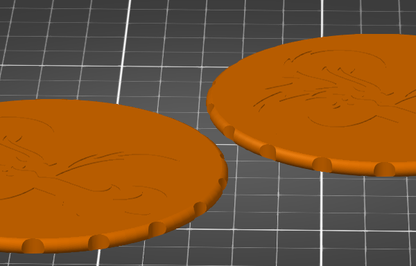

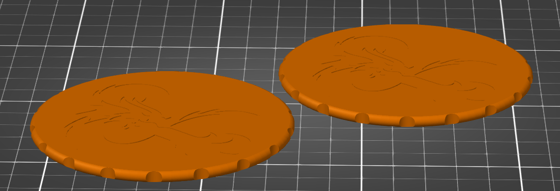

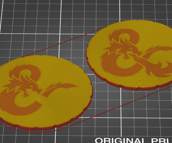

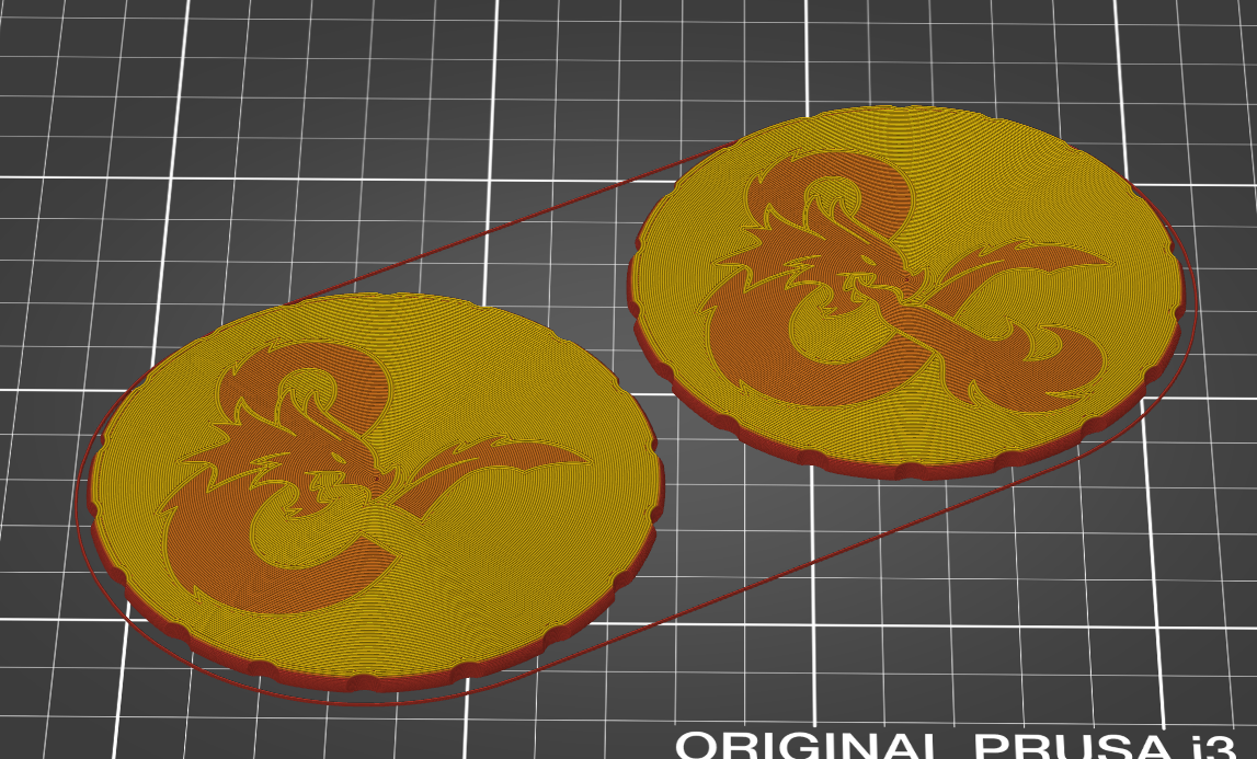

I have an issue with slicing that has me stumped.  If I export an STL from my openscad file with $fn set to 100, everything exports correctly but prusaslicer will not perform slicing on the flame part of the dragon design.  If I set $fn to 101 (or any prime I've tested) and export, prusaslicer says it has repaired the STL and slices everything correctly.
unsliced view Before slicing the flame is clearly there missing flame outline This is the sliced version, missing the flames
I have attached the svg and images showing the way prusaslicer slices the two different models.  Prusaslicer version 2.1.1-linux64.  scad and stl files are here: https://drive.google.com/open?id=1wYdt3oMC3mOznS2T6c79JAoI9-3uL3eL

Sorry I wasn't clear.  Nothing in slicing settings will have any effect, the slicer always fails to render the flames in this example.  I've got a link to a 3mf file here.  I don't see a way to upload it to the forum: https://drive.google.com/open?id=1QM0etOQJmZfNUz6tyKbdCCvOlkvEtIDv
