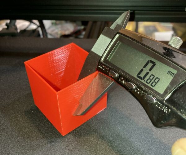

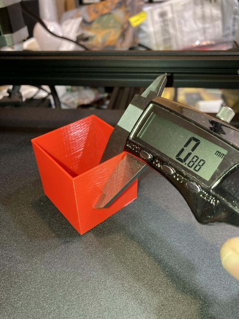

I have been fighting this problem for weeks, trying to get correct wall thickness and adhesion.
I am using an Ender 3 Pro and PrusaSlicer 2.3.0.  Used this guide to set my Extrusion multiplier:
https://help.prusa3d.com/en/article/extrusion-multiplier-calibration_2257
Got a perfect cube with wall thickness of 0.45" after setting multiplier to 1.09.
If I use the same cube and just uncheck "Spiral" and set Perimeters = 2, I get a wall thickness of 0.88".  Perfect.

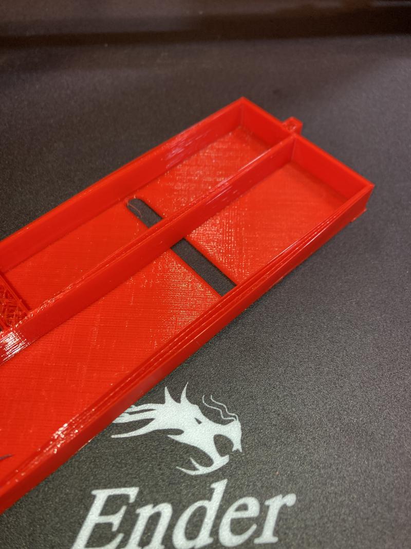

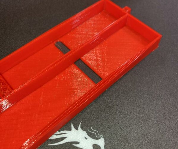

Now if I try again to print the Ender 3 drawers, which have very tall  walls, with 4 perimeters, the stupid walls come out with thickness about 0.33" and each perimeter completely un-attached to adjacent perimeters.

Here is my test cube printed as the calibration guide shows, in spiral mode, with Inland PETG, and 1.09 Extrusion Multiplier:
40x40x40 Test Cube
2 perimeters
Now here is a real print project, the Ender 3 drawer case.  Prusa slices it with 4 perimeters, but now it prints with an extrusion width of about 0.33", and perimeters do not adhere at all to adjacent.
Ender 3 Drawer Case
Perimeters too thin

Some corrections, as it appears I cannot edit my own post (lesson to use preview 🙂
Units above are mm, not inch.
The 1st photo above is not spiral sliced, but rather 2 perimeters.
