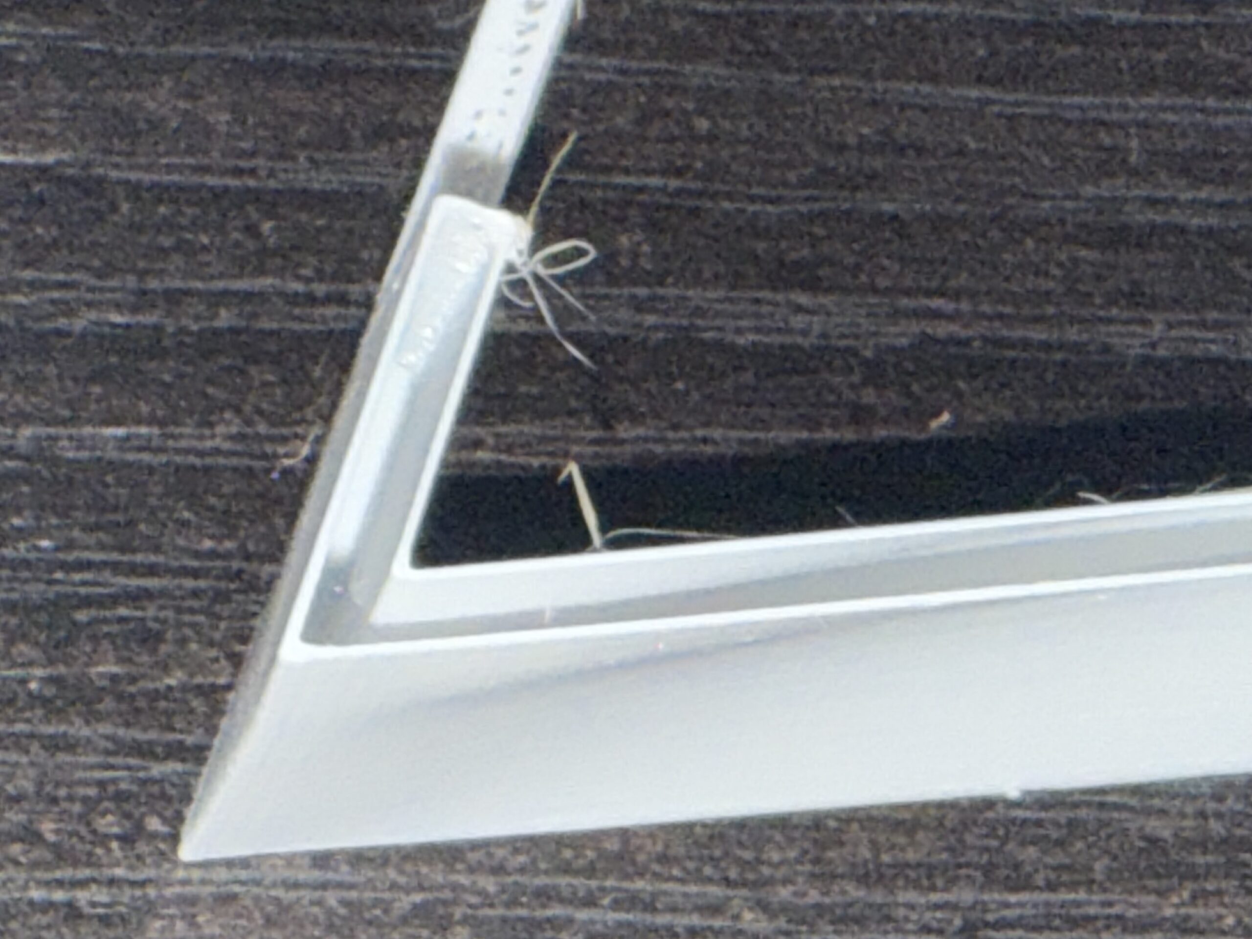

i’ve been using my mk3s+ for a few years now and i’ve never had this issue before.
i have the default infil selected (i have not changed my basic profile in a couple of years) but it does not show up in the slicer and does not print (resulting in warped vertical walls of this little building model.
[project file attached]
thank you for your help!
kev

It will never put infill inside.  Simply because the model you have loaded actually has hollow walls.  The walls arent solid.  Its also why increasing perimeters has zero effect for the upright part of them.
Here I'm using 3D-Tool in its cross section view to take a look inside the model.  You can see the model structure, the slicer is doing exactly what it is supposed to do.

thank you for your prompt help — i have notified the designer and she’s updating the model.

You can add in PrusaSlicer primitive object such as box and move it and scale it to fix it, but that may be a bit of a problem in certain setups.
Surely it should be done in the original model design.
