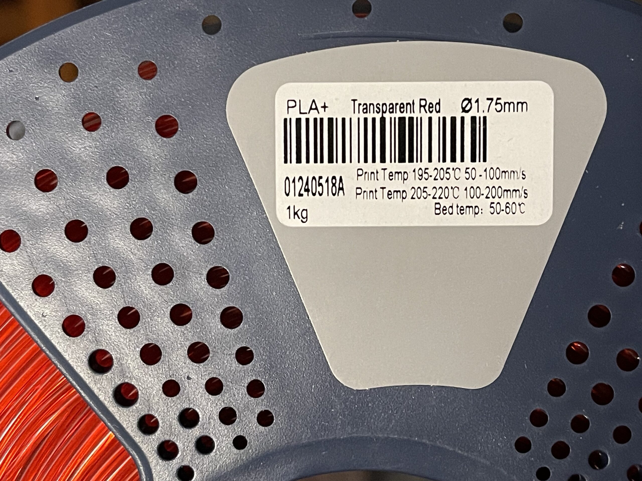

Hi everybody,
I have a headbanger (Prusa XL) and Sunlu filament. There is a label:
It says:
Print Temp 195-205°C 50 - 100 mm/s
Print Temp 205-220°C 100 - 200 mm/s
I'm confused because it's lenght (mm) , not volume (mm^3). So how should I set the temperature in PrusaSlicer properly? Should I use formula? If so which one? And which values of Printers > Machine Limits should I take for calculations? Maximum feedrate? If so, should I calculate the diagonal speed (since it could travel x and y at 140mm/s each)?
Are there useful online calculator or even database with combinations of printers and filaments with recommendations for PrusaSlicer settings?
Or should I just enter 220°C and that is it?
Best Regards
Floh

It’s not volume or length its speed. So one is recommended temps when printing at up to 100mm a second speeds and the second is when printing at higher speeds such as 200mm a second.
Faster speeds require hotter temps to get the throughput. You should always test for your particular machine/filament combo anyway.

I think you're overthinking it. Just try the Generic PLA setting, which in my hands works great with almost every filament. Should you run into a problem, just print one of the many temp towers on printable. But the standard profiles print at higher temps than before, so I think you'll be fine.

So no matter how much volume per second a printer is extruding? I mean there are factors like nozzle size, layer height.

One temp tower per color or not: Depends. Most filaments today behave very well, and the Generic profiles work just fine. But sometimes you find you'll need a different optimal temp for different colors from the same vendor, based on the chemistry used to generate the color. But I rarely run temp towers anymore as 99% of the time the Generic profiles do the job fine.
