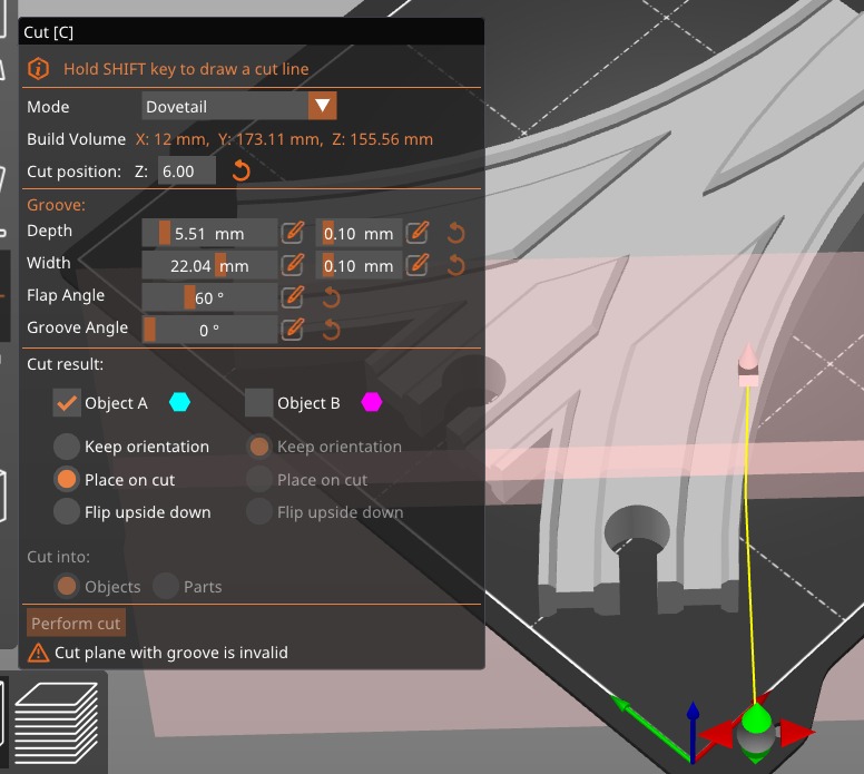

This is broken train track
my son in law asked me to print only the left arm for repair from this model
https://www.printables.com/model/345680-train-tracks-complete-set-v4-reversible-compatible
for day-care center of 2yo grandson.

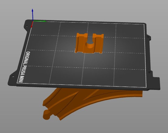

I tried to use cutting tool, but was not able to get what I wanted:
I did know how to cut planar with sunken model after some rotations ...
... and the result is OK:
But I want to learn how to cut only that part from original model without rotation.
Is that possible?
If so, how?

RE: How to cut part of model with PrusaSlicer?
To answer your original question, yes it is possible to cut at any angle.  This is basic and covered in the appropriate knowledge base article https://help.prusa3d.com/article/cut-tool_1779
You can rotate the cut plane to any angle you like rather than rotating the object.  Same way you can reposition the cut plane.  The coloured handles that appear have different effects.  SO you dont use the panel you grab the handles.  For example this image from the cut KB
If you grab the green handles you can tilt it in that axis.  If you grab the red handles it tilts in that axis.  Grab the grey centre sphere and you can move the plane up and down.
Spend a little time experimenting with the tools and you will gain a lot more proficiency.

HermannSW
(@hermannsw)
Posted by: @neophyl
Thank you, my problem before was that I did not use "planar" but "dovetail".
With planar it was so simple!
Posted : 09/04/2025 1:15 pm
