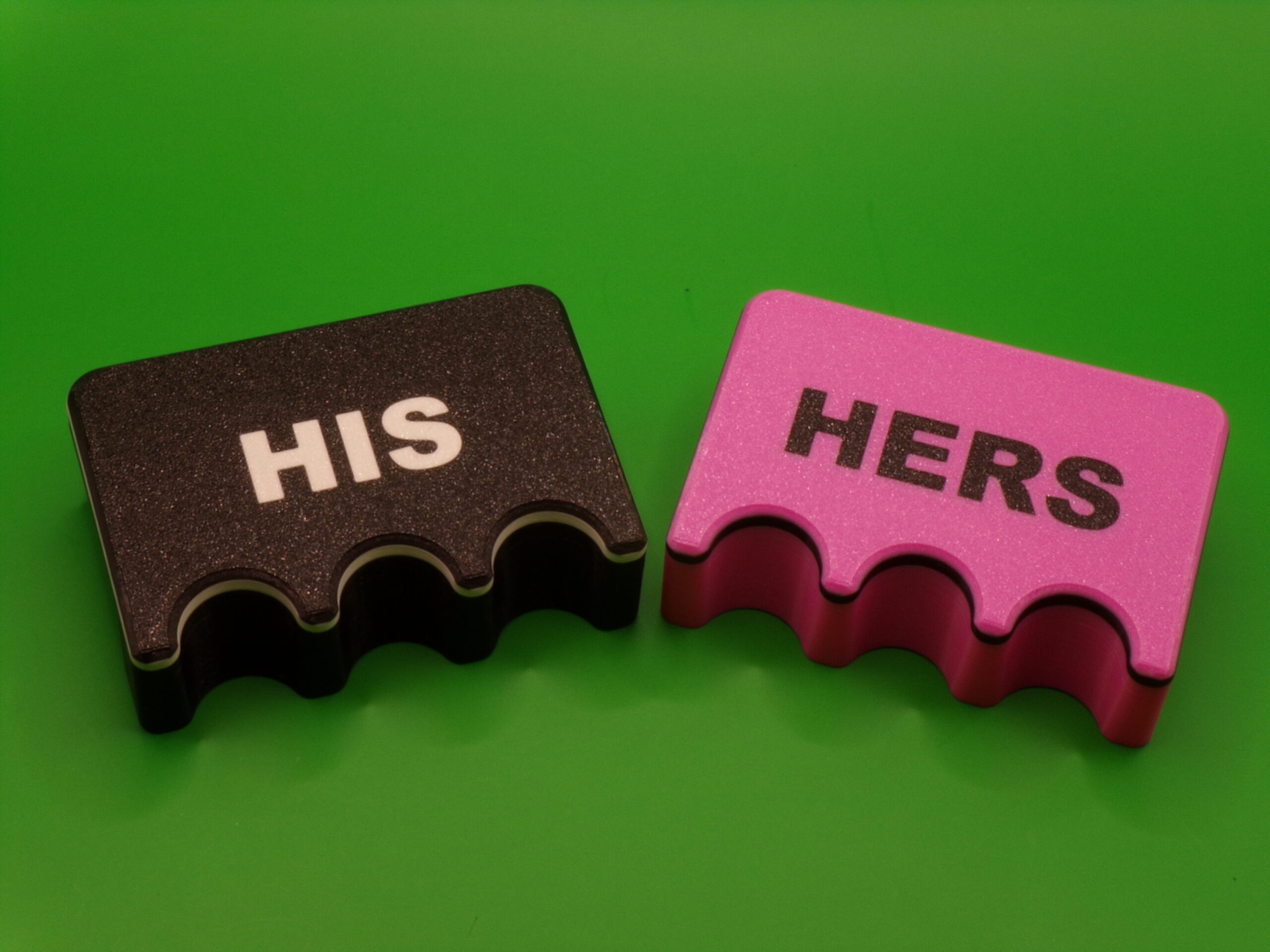

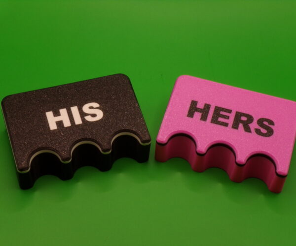

RE: Feature suggestion...Filament Changes at exact points in gcode
Unless I am not understanding what you are trying to do this may be something that is easier to do in a CAD program? And then imported into PrusaSlicer as an object with multiple parts?
KODAK Digital Still Camera
Posted : 09/03/2023 10:54 pm
RickM
(@rickm-3)
Hmm inserting a photo into post didn't seem to work.  Attaching instead.
Posted : 09/03/2023 10:55 pm
