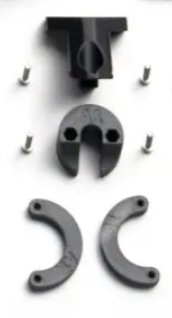

Found the picture of all the parts on Bondtech's website now. Looking at this thing for docking the tools, the design must be driven by the lack of mounting points on the existing chassis, and the desire to make installation relatively easy. That's the only reason I can see for extending it all the way up to the new frame profile.
If one is willing to either drill holes into the vertical frame profiles, or e.g. replace the belt tensioner blocks by new parts with additional mounting points, it should be possible to attach a less obtrusive U profile as a tool dock.
It would be good to know how the original mounting bar (shown at FormNext and in the various promo pictures) was attached and what its deficiencies were. Has anyone come across a closeup photo?

For maintenance it should be fine. 4(6 for LED-profile?) screws to get the part out of the way and the top lid seems to be hinged with quick releases on the top-front.
Posted by: @jurgen-7
