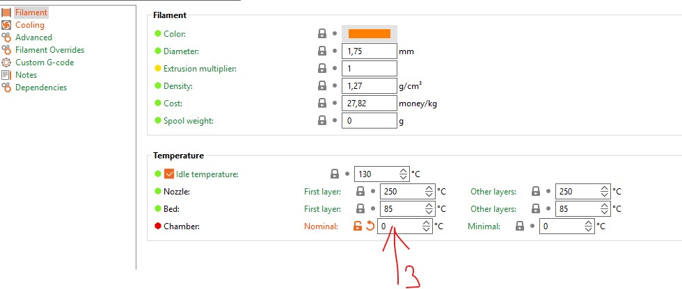

Make sure the build plate is clean, they are dirty from the factory, soap and water wash, wash wash, then IPA.
Turn off the chamber fans, it causes lifting and warping. Prusa should not have these enabled by default. You can set the Nominal Chamber Temp to 0 for the filament profile, this will also keep the chamber fan off.
Lastly the perfect 1st layer isn't so perfect. The above will likely be enough, but you may need to adjust your Z offset in the printer profile. ~-0.02

Ruebarb...when you are writing about chamber temp, would you mean only the point 3. down in the picture or also pint number 1 and 2 like down in the picture?

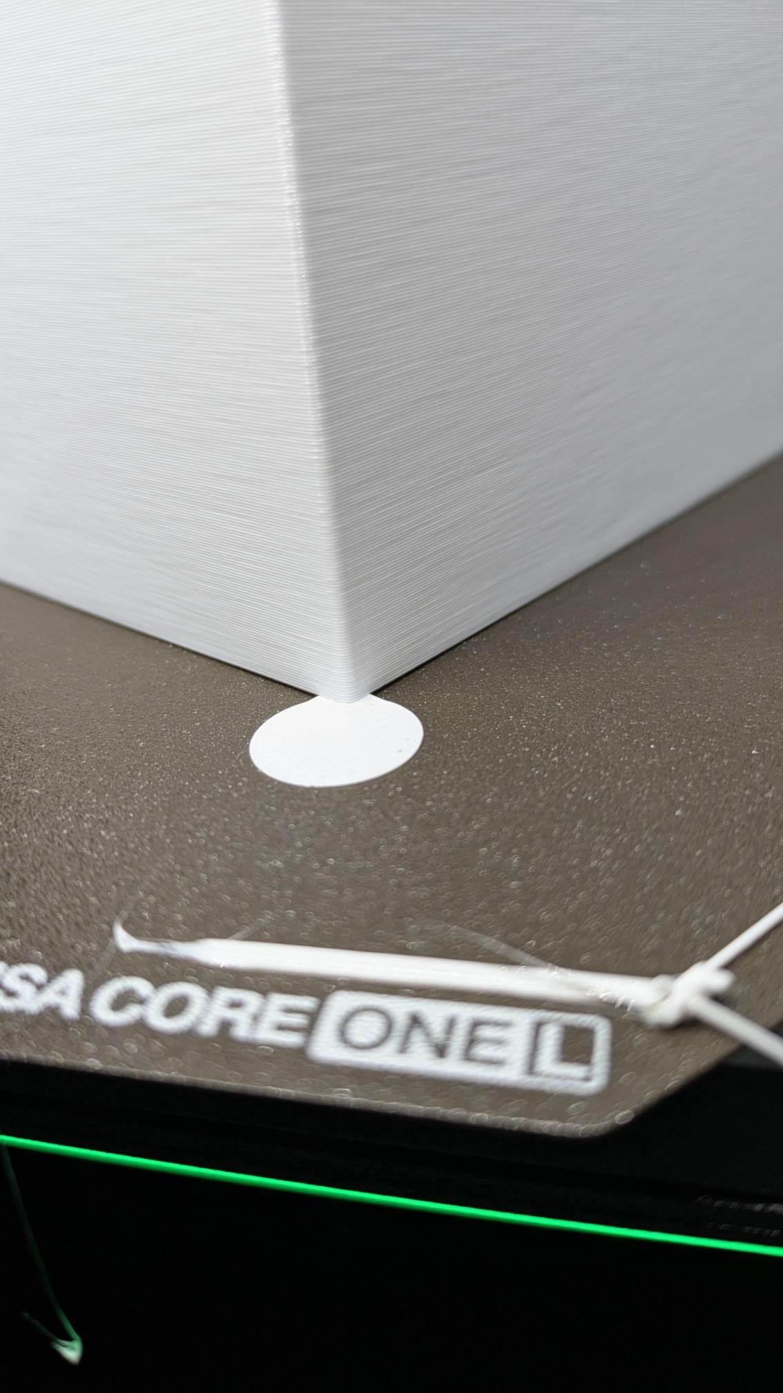

I am confused with this prints....
The bed surface have been cleaned with water and soap, then 4 times with warm water. Than with isopropyl alcohol.
I tried also Z offset -0,02,
First layer speed 25 mm/s
Others perimeters speed 50 mm/s
Enclosure fan speed OFF.
Printing fan speed 15-25%.
Do have anybody idea what cold be working?
Thank you
Disk on the corners
Posted : 26/01/2026 8:21 am
