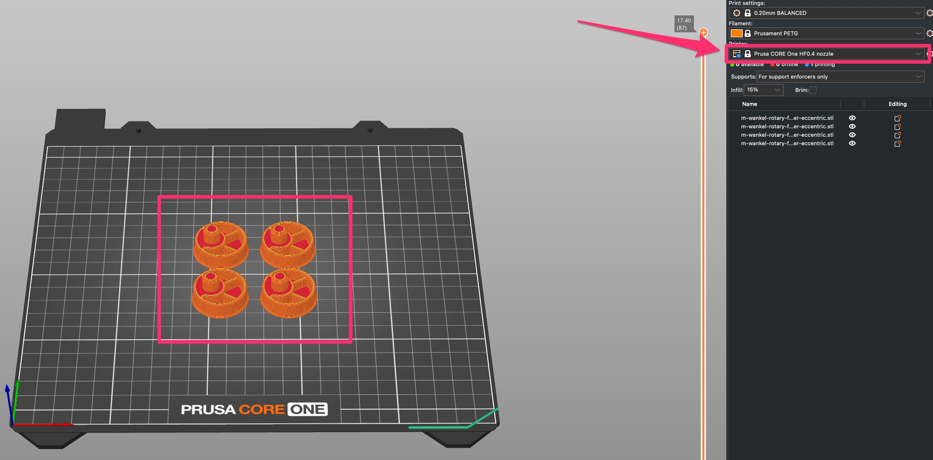

What went wrong with this print?
This is Prusament PETG on Core One. It is from this model, https://www.printables.com/model/233043-wankel-rotary-fidget-spinner-toy/

In the print above, I find it strange that all four copies of the part would have come loose at once. When you found them, were they all detached from the build sheet? Or could it be that the printer has lost its XY position at some point and then started to print in mid-air?
There is a known bug in PrusaSlicer, where it generates "impossible" Gcode (very rapid moves with sudden acceleration) when the option "Print Settings > Layers and Perimeters > Quality > Avoid crossing perimeters" is activated. This has caused step losses for many users. It's recommended to keep that option disabled.
In general, I like to use "Print Settings > Output options > Complete individual objects". The printer will then print a complete object (all layers) before moving on to the next. Fewer objects will fit onto a build plate (the Plater's "Arrange" button will be aware of this mode) --  but if one fails, the others are typically still usable.

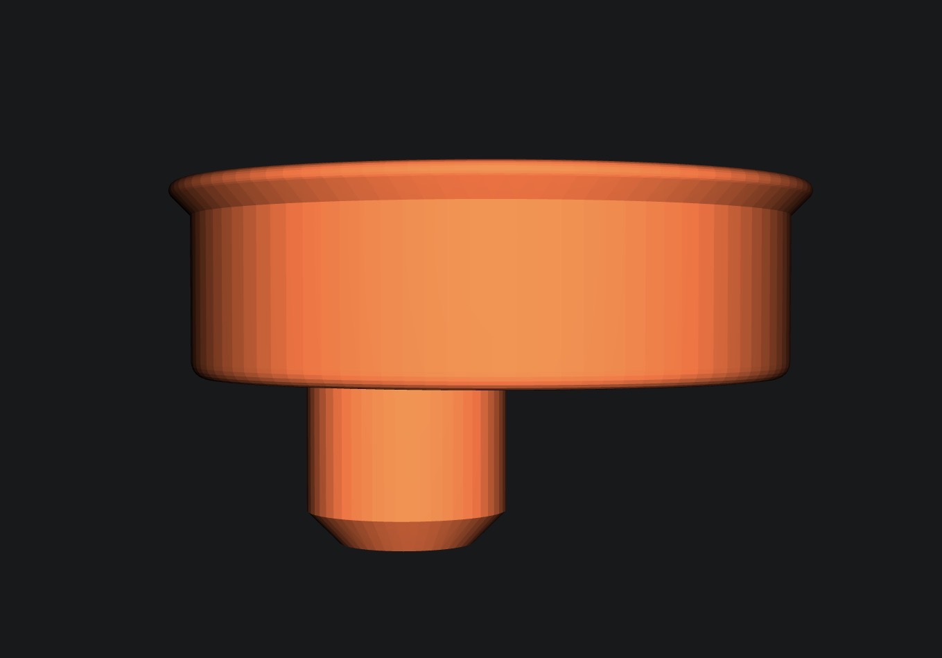

Only the small, spindle is attached to the bed. The web mess is just floating over the bed, look at the attached side view
None of the parts were detached from the bed

RE: What went wrong with this print?
Posted by: @phil-16
I’m new to 3d printing and obviously have no idea how to print this part.
In PrusaSlicer, save the project as 3MF, zip it and attach the ZIP file to your reply. Then we can look at it and give guidance.

k1mu
 k1mu
(@k1mu)
Flip the object over so the large side is on the print bed surface.
In PrusaSlicer, on the left hand grey box there's a set of icons. The forth one down is a box with an arrow pointing downward. Click on that. Then, you'll see a white surface on the top of the part. Click on that, and that'll be placed onto the printbed.
It's never going to print as originally oriented without supports. Placing it properly avoids the need for those.
Posted : 01/01/2026 6:06 pm
Oh, you should print them with the flat side down, and the little axle stub pointing up. Otherwise you will not have enough attachment area to the print bed. And the printer will try to print the first layer of the large flat side in mid-air, which is what caused the fail here.
When you load the part into PrusaSlicer, the left side-bar of the "Plater" view has a tool called "Place on Face". Select the  part (click it so it becomes green), select the "place on face" tool, then the Plater will highlight the larger surfaces of the model which are candidates for the bottom surface. Click the large, largely flat surface, and you are good to slice and print.

I know, the other side has that little dimple. Its bottom surface will be printed in mid-air again -- not ideal, but since they are supported on all sides, the filament strands will stay where they should go.
You can see on the title photo of the Printables page that the bottom surface of that dimple does not look great. That's exactly because the filament strands were not deposited on a well-defined surface but were strung out in free space.
Posted : 01/01/2026 6:20 pm
So you need to print them with the top side down and the spindle pointing up. Also you have Prusa Core One HF0.4 nozzle selected. Double check that you actually have the high flow nozzle in your heat block. If you have the brass one from Prusa it should have "CHT" printed on the heatbreak tube.

Thanks Jürgen. I flipped them and will print them next.
Prusa Core One
Posted : 01/01/2026 6:28 pm
Phil
 Phil
(@phil-15)
They came out well this time. Thanks for everyone's help.
