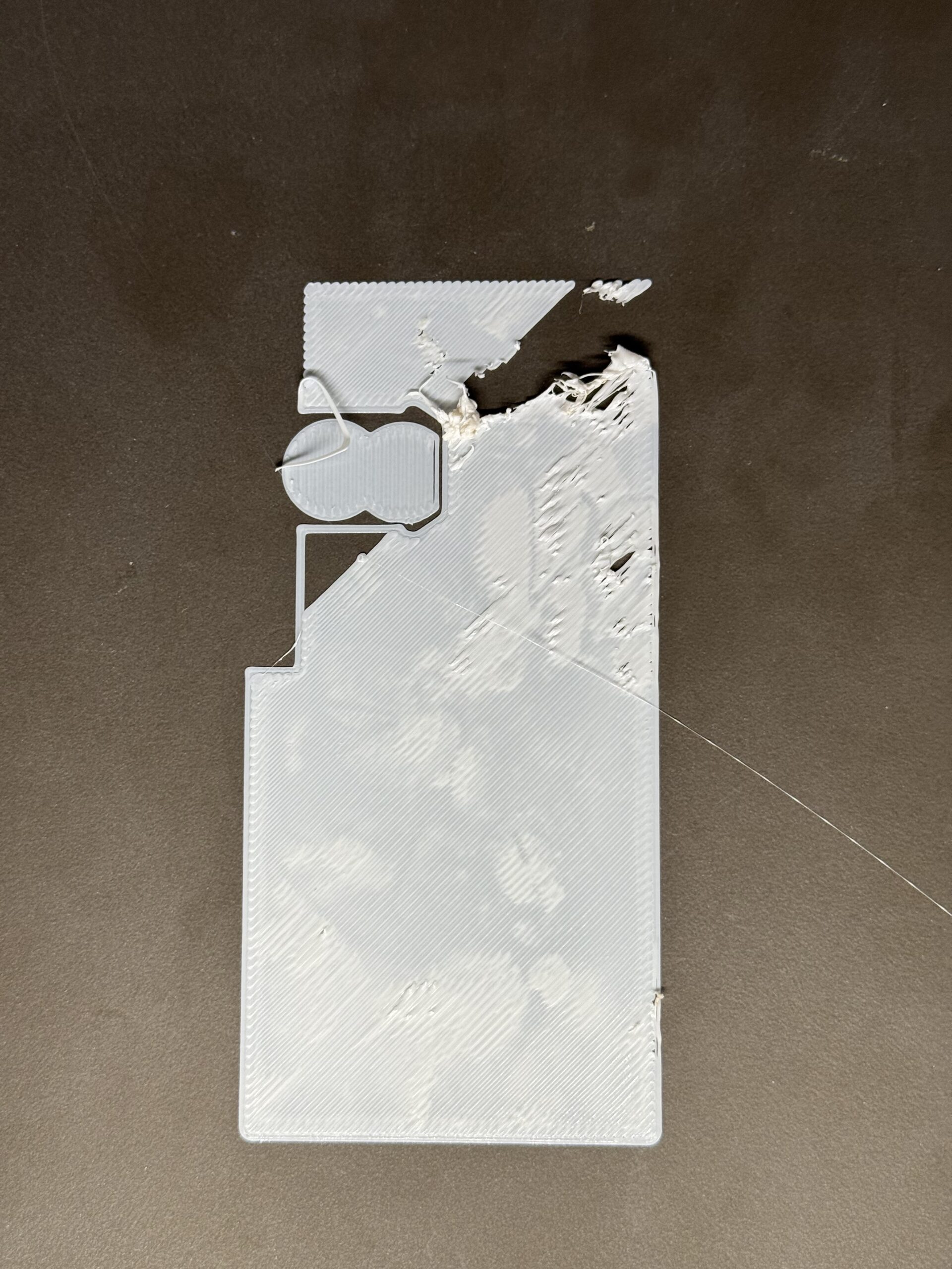

I'm trying to print something with white prusament PETG on a Core one via MMU3. I was able to print with black  prusament PETG without any issues, but when I try white, the first layer is terrible.
I have also an error every time I tried to print.
The G-code isn't fully compatible.
Nozzle flow rate doesn't match
On Prusa Slicer I have Core One MMU3 0.4 nozzle, and the nozzle is the regular one, the recommended one. Am I missing something?

I think I found it, On hardware options HF had to be deselected.
