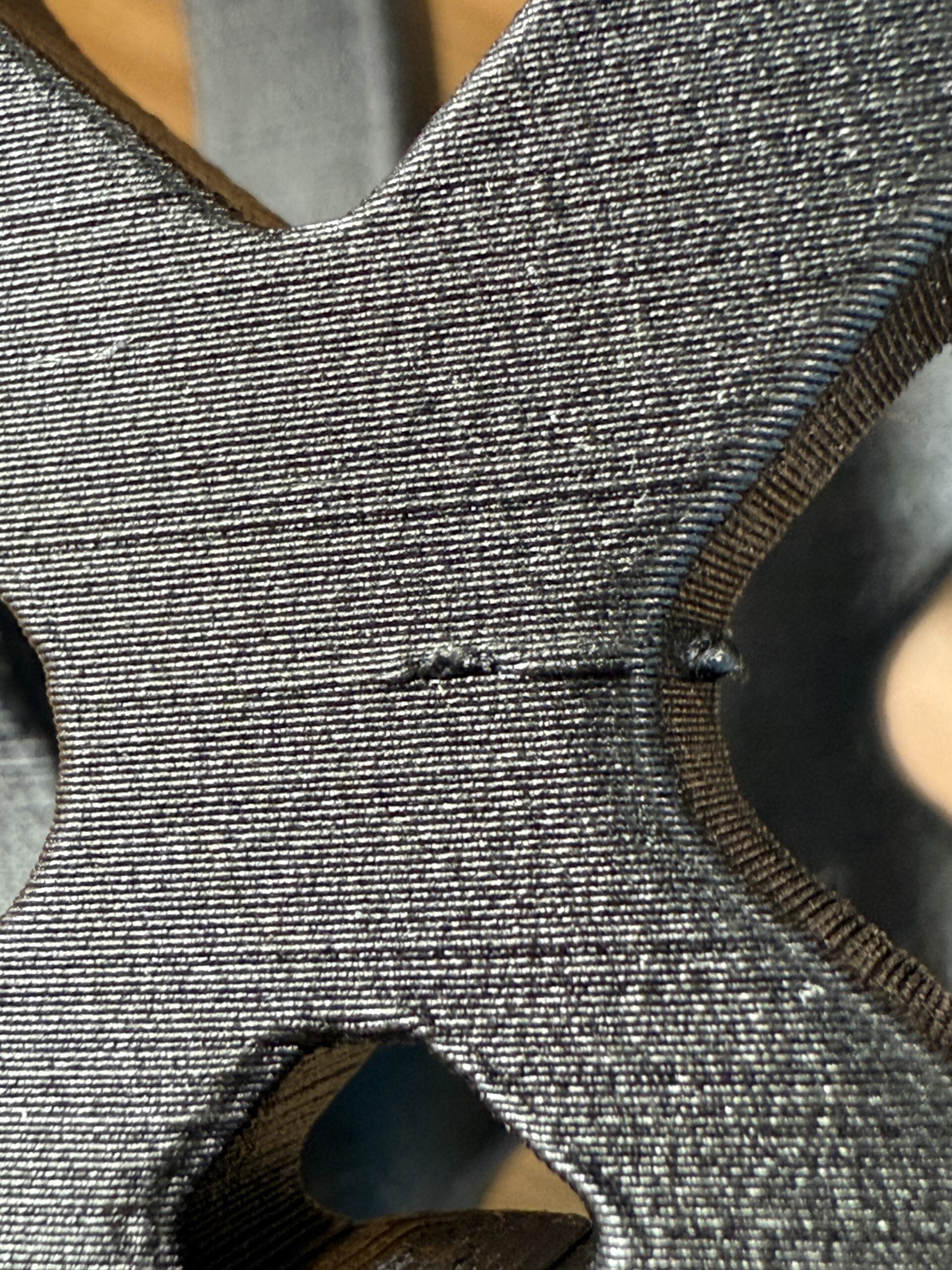

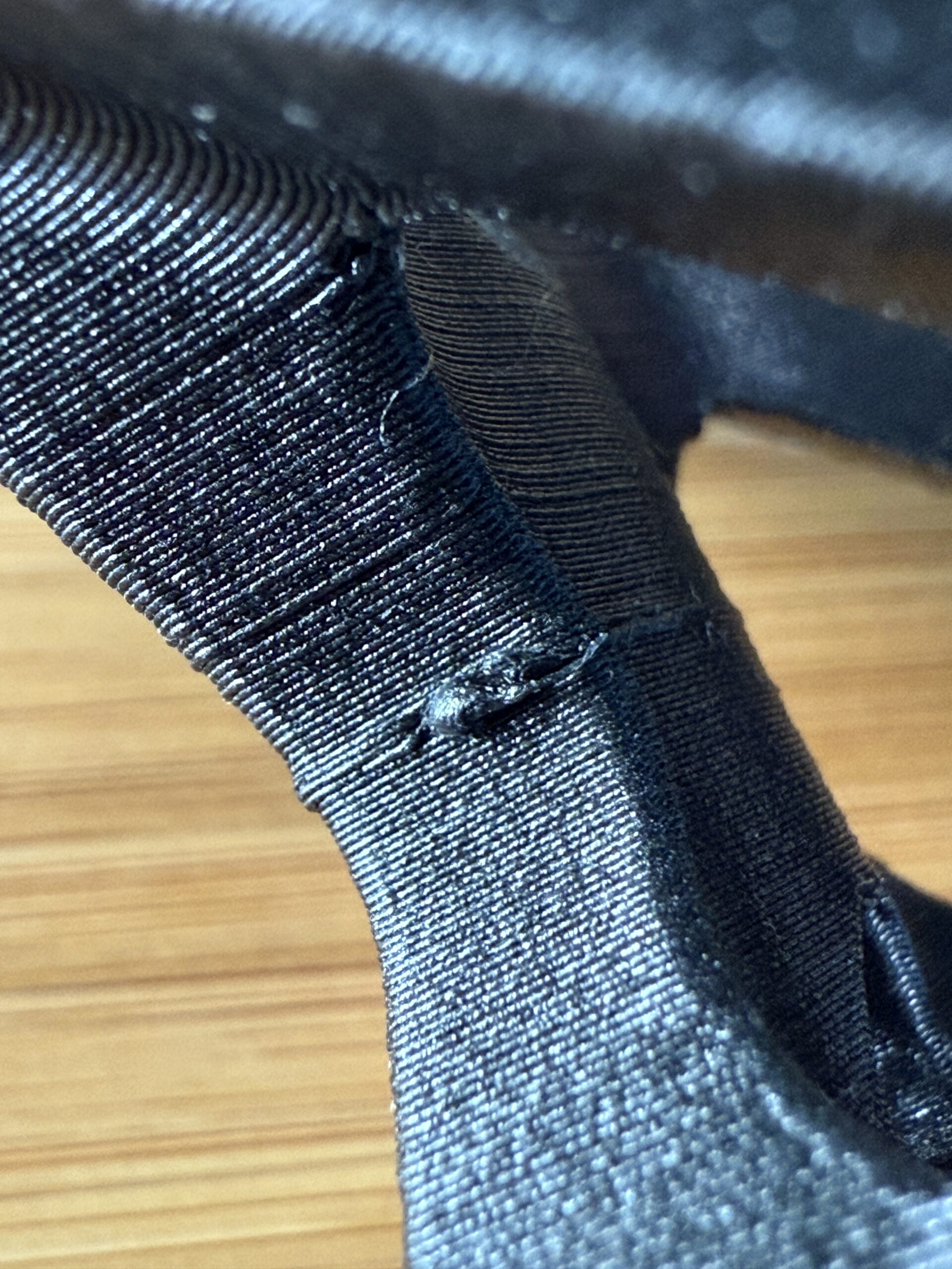

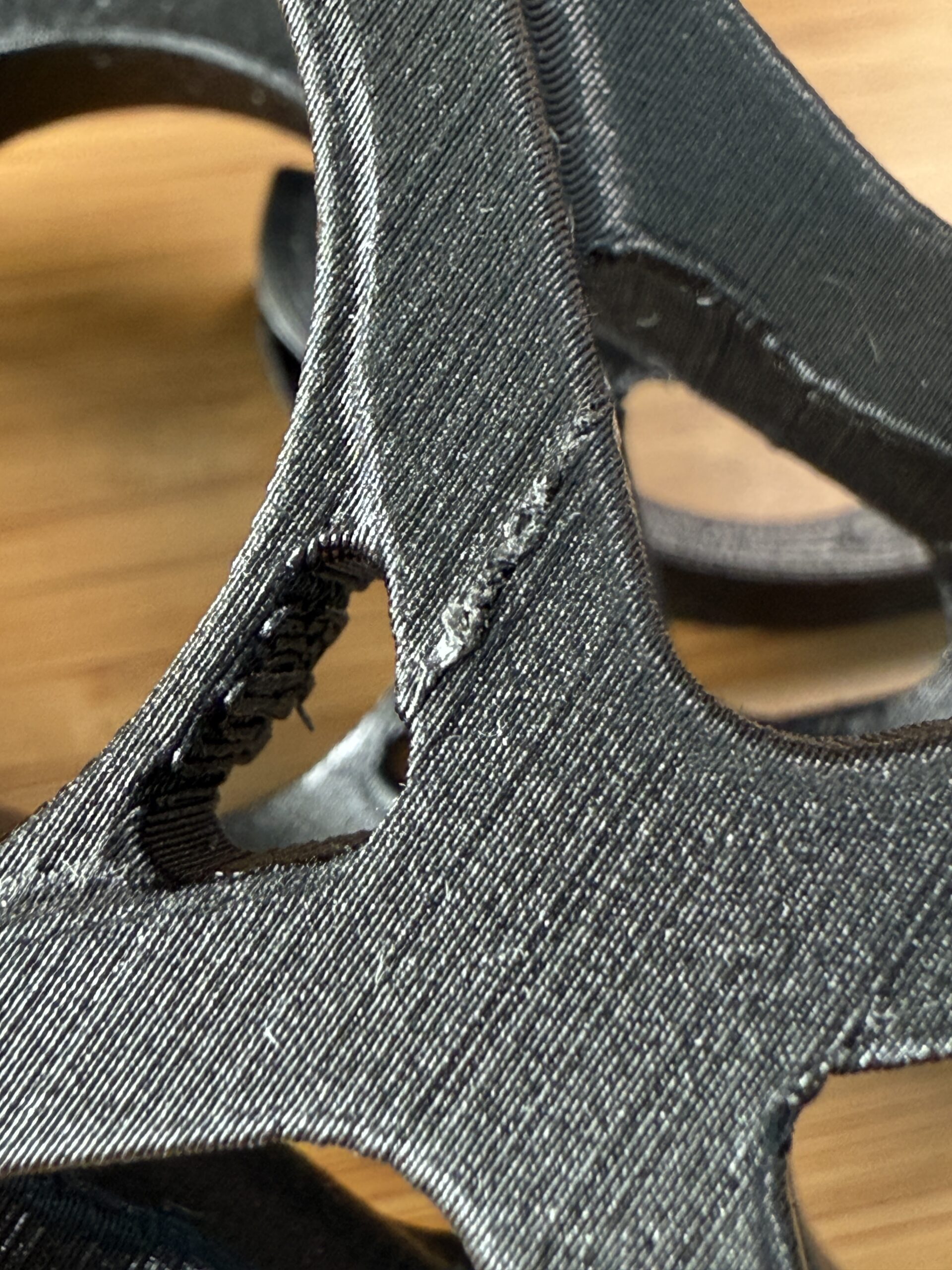

Trying to figure out what could have possibly caused this? It's like the machine lost its position and shifted over for the rest of the print. No interruption to electrical power that I'm aware of.  Bad upload of the G-code maybe? All the previews looked fine.

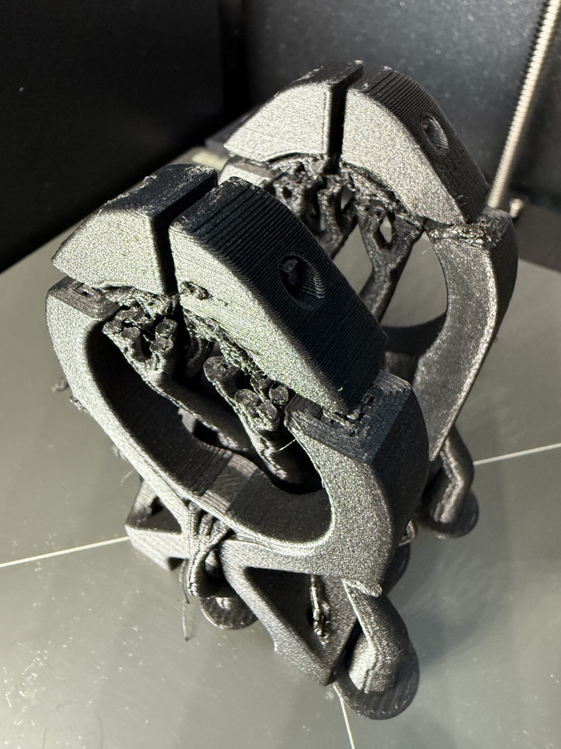

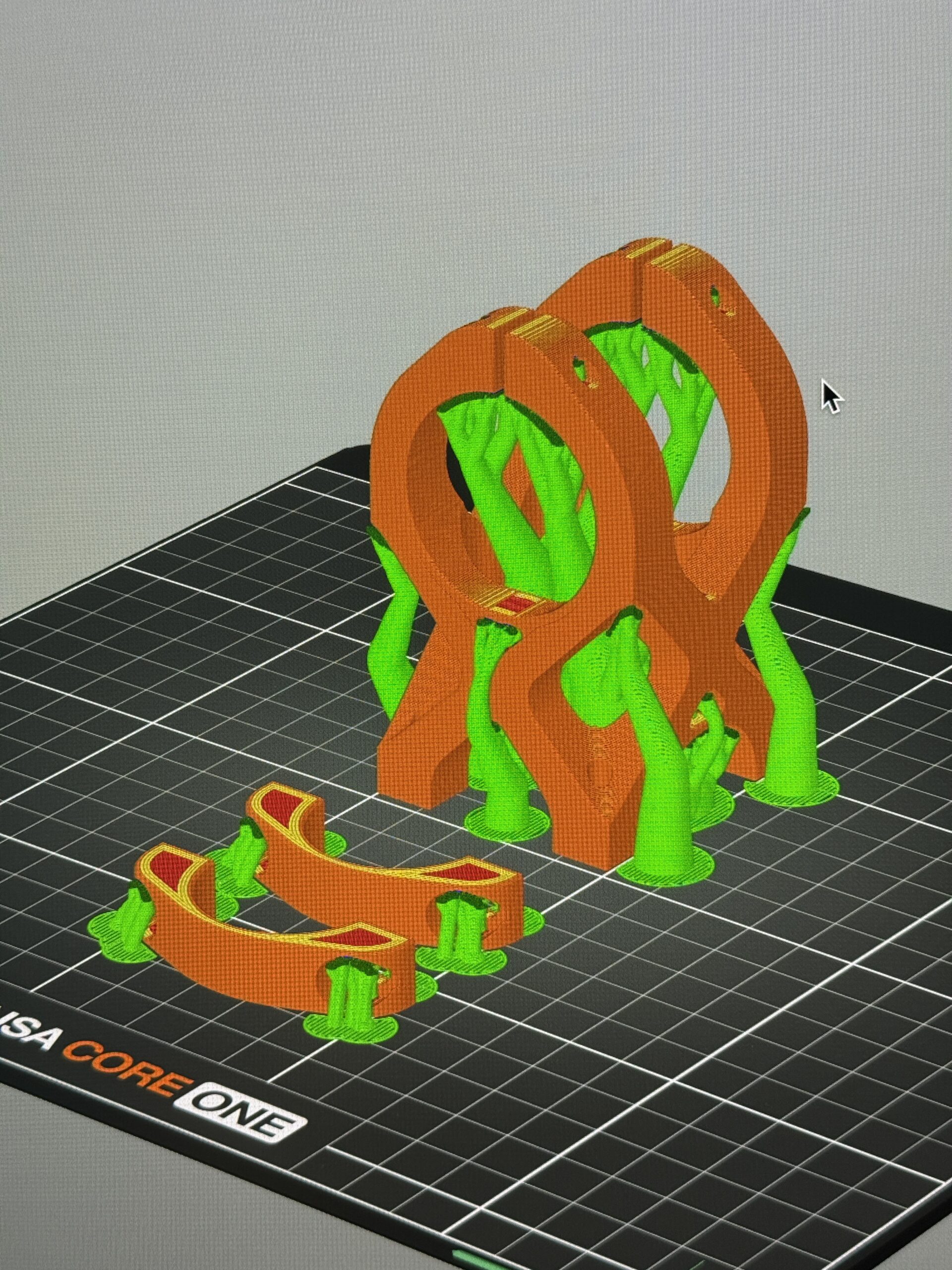

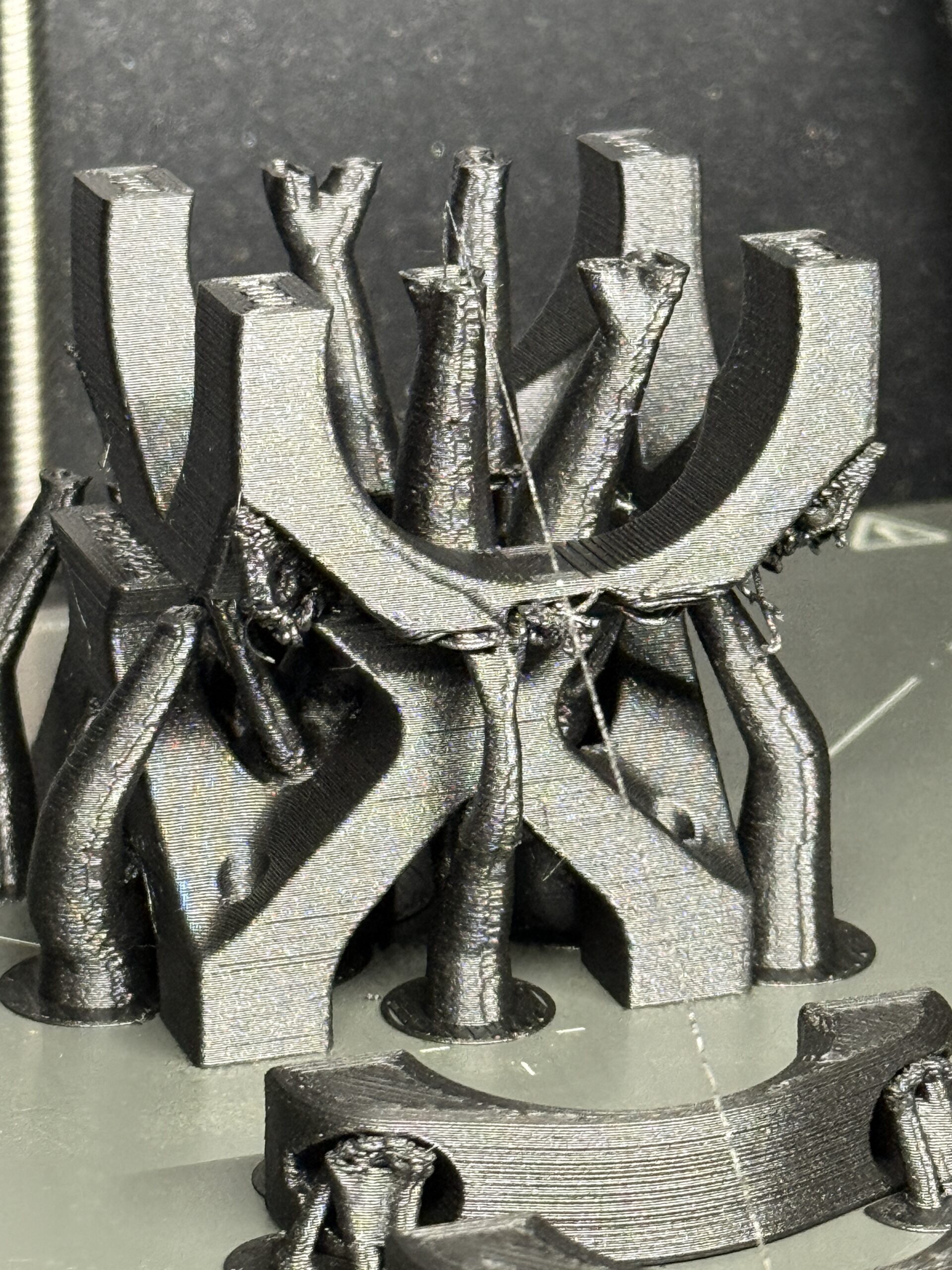

I had a look and I'm not sure what's causing it, but due to the kinda "thin" geometries and the organic supports, the nozzle might hit the object during travel moves. With the 0.6 mm nozzle and PETG-CF, the nozzle probably can't just move through the collisions and at some point causes a layer shift.
A few things I would try, in this order or just everything at once:
  1. Use Stealth Mode, which limits ALL movements to 160 mm/s, so the nozzle won't smash into the object at 350 mm/s.
  2. Settings -> Filaments -> Filament Overrides -> Activate "Steeper ramp before obstacles" and activate it with the second checkbox right next to it. (Left box is "activate the override", right box is "activate the actual setting).
  3. Print Settings -> Speed -> Travel -> Set to just 110, which is the speed of the Solid Infill in the structural preset.
  4. It also might be some warping, which lifts some edges, that are then hit by the nozzle. I'd recommend to slow down the 1st layer quite a lot for a test. In your project, it's set to 45/70 mm/s. I'd suggest setting both to just 15 mm/s.

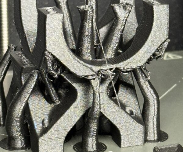

Was the part originally designed for machining from metal?  Rising unconstrained curves are always tricky, they have a tendency to warp as the filament cools and if the part twists enough there can be a head-crash causing layer shifting like this.
I would use cubic infill, reserve the honeycomb for occasions when the very slight stiffness bias of cubic really matters.
Snug support might also hold the part in place a little better.
If at all possible the best way is to include a breakaway stabilising fin on each arm:
It can taper to a single extrusion width at the contact point.  The idea is to hold the arms in place until complete and then remove post printing.
Posted : 20/06/2025 7:24 am

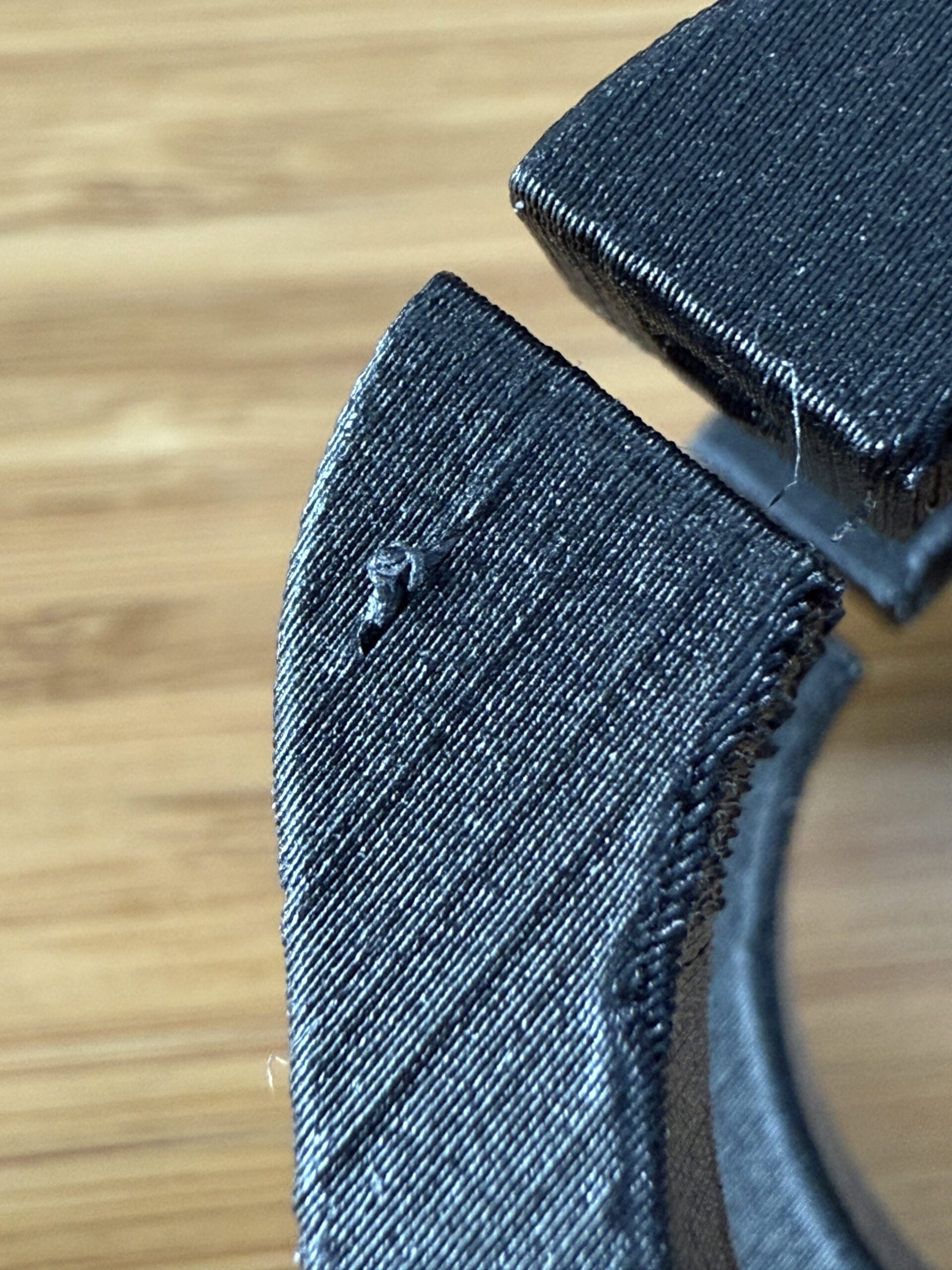

I had this happen recently on a PETG print because the nozzle was collecting gunk which eventually stuck to the print. Don't yet have a solution (but haven't been chasing it either, other priorities and haven't been printing). PLA is fine.

Can confirm it came loose and stuck to the print on one (I was watching because it was a reprint - initial failure I'm less sure). I've tried extrusion multiplier and it helps, but on a recent print I see the top layers aren't quite touching each-other - may be a different issue though for that (I needed a few slightly narrower filament clips so just x-scaled down). Quite likely my issue is just learning curve and unrelated to the one OP shared, but figured just in case...

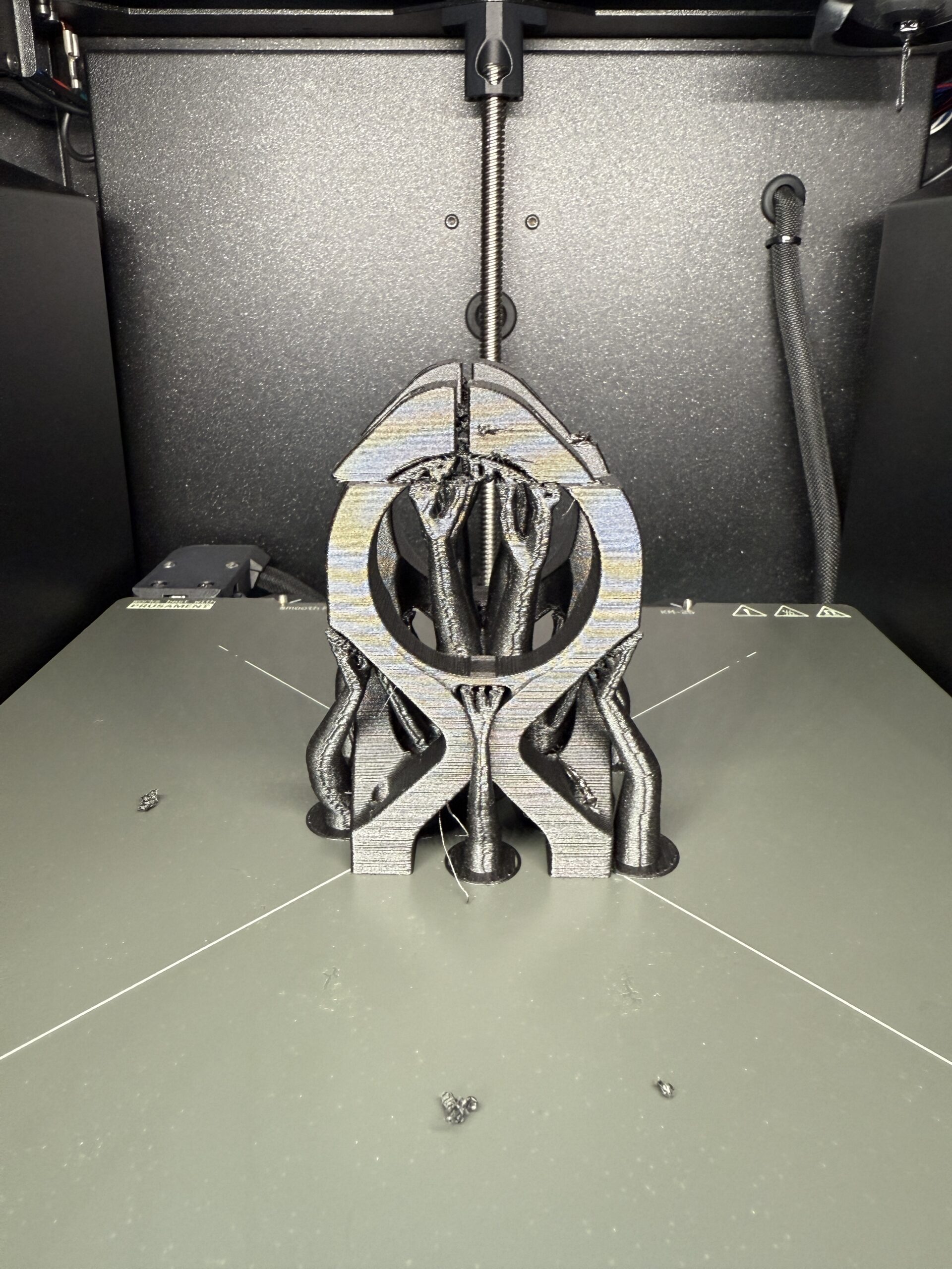

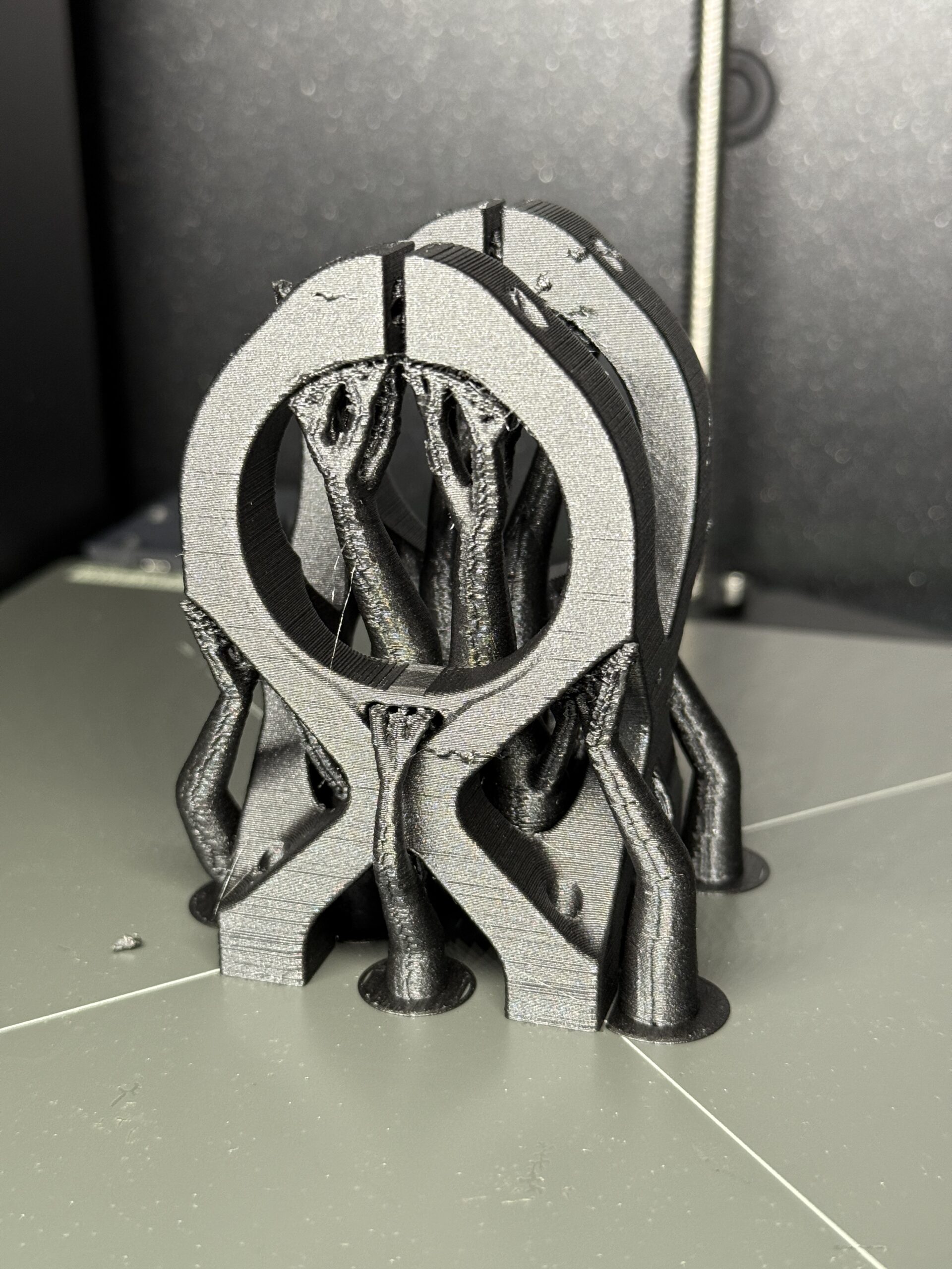

Ok, here were the settings I changed:
Set the machine on Stealth Mode. Here is the result:
So, slowing things down a bit definitely helped. Upon closer inspection, you can still see some areas where it was struggling to hold the layer. I do believe it has something to do with this particular material (PETG-CF), since I haven't had any issues in PLA or regular PETG. It seems the material "swells" a bit after cooling, so maybe some of it's from that. With dryers I'm getting the spools down to 18-23% humidity, so not sure how much that contributes.
Thanks everyone for your feedback. I'll keep experimenting and see what else can be done to improve this material's printing quality.
