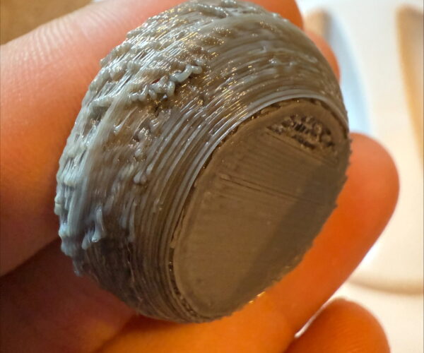

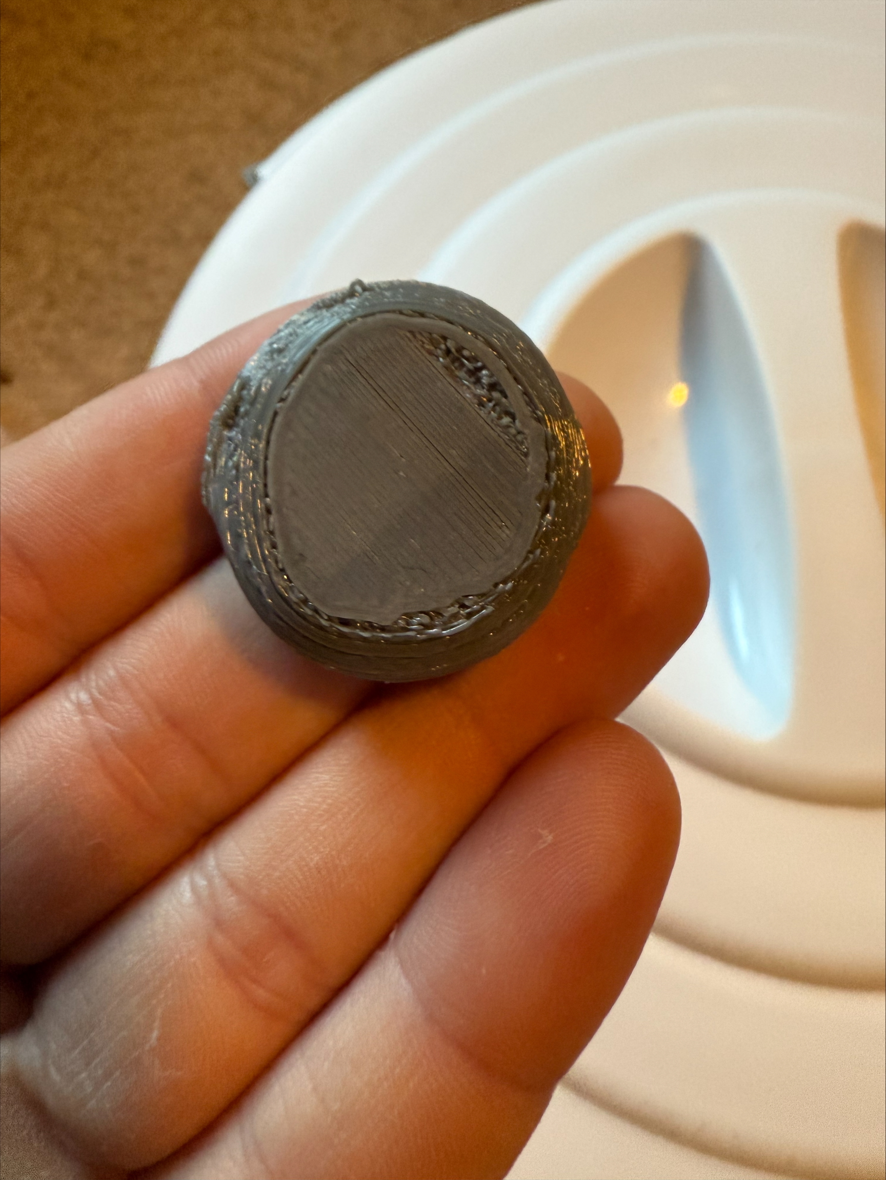

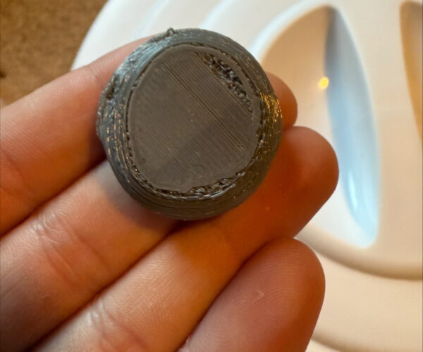

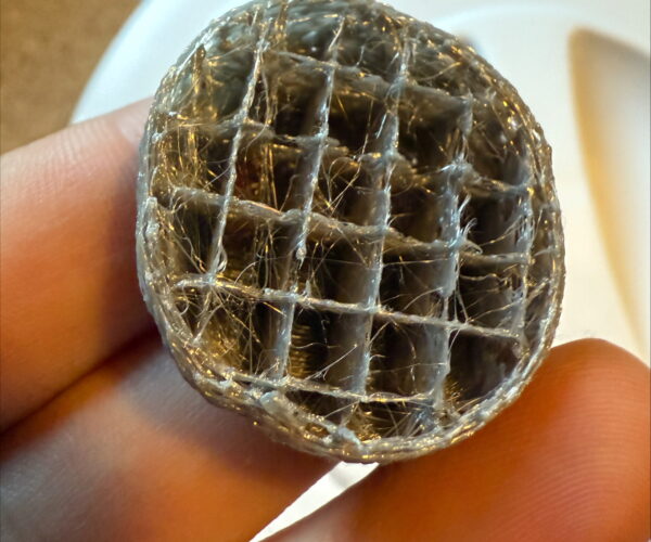

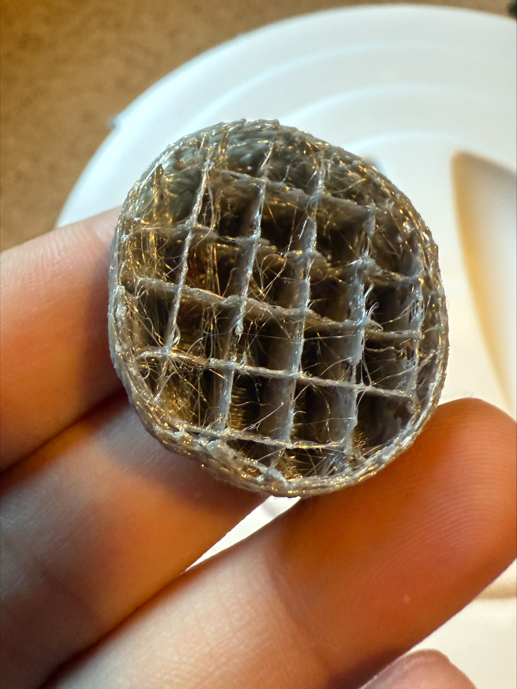

Ive been having issues printing with TPU.  Ive tried the suggested fixes that were mentioned online and in other topics such as slowing the print down, loosening the idler screws on the hot end, drying the filament for almost 2 days in a filament dryer, increasing the temp, and decreasing the temp with nothing seeming to work.  Every print gets a few layers in, then starts to what I think is underextrude, then stops extruding altogether, though the printer does not detect a nozzle jam.  The filament is elagoo 95A tpu, the slicer setting is the built in one in prusa slicer ultrafuse tpu 95A because a friend of mine says that is what he used when printing tpu and it worked for him.  The nozzle is the .4mm stock nozzle that comes with the core one.  Im running out of things to try and would appreciate some advice, thanks in advance.

Not a TPU expert, but part of it looks like layer time is wrong for the filament. The nozzle is printing so slow it is melting the last pass. Turn the part fan on, reduce the minimum layer times, and possibly decrease nozzle temp. And, since layer one is broken, the TPU is probably hanging up in the Bowden or the extruder isn't feeding it well.
Others have said some TPU requires feeding directly into the extruder, bypassing the Bowden.
