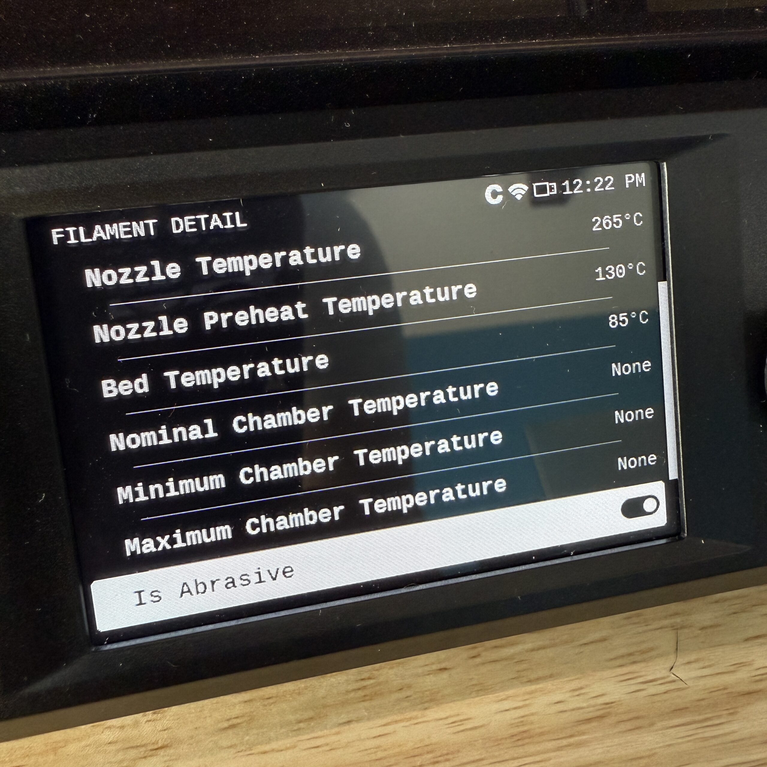

Trying to setup a new filament profile on the Core One for PETG-CF, but I didn't see any guidance on Chamber temps. Anyone have what these should be? Any other recommendations for this particular material?

Chamber temperature etc. is set via gcode and comes together with your model.
I guess load filament as PETG will be fine. - I did so and it worked perfect.
The need is just for nozzle temperature during load and unload. All other is controlled via gcode during print.

Got it. Thank you for the feedback! I guess since I'd seen other filament profiles have values there, I assumed it needed them as well.
