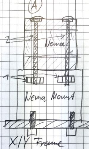

The O-ring is dimensioned so that it fits just over the screw. Similar to a lock washer on screws with a U-washer.The recess for the O-ring is also large enough that there is a slight protrusion, but the O-ring is “pressed” into the mold.The force of the screw prevents displacement in all three axes. Where else would it go if it can't move 😉
My second idea would be to completely decouple the NEMA stepper motor and the NEMA mount from the frame. This means that the NEMA motor is screwed to the mount from above and the mount to the frame from below.This prevents the vibrations from the motor being transmitted to the frame via the metal screws.
Option A:
Insert longer screws through the motor and into the nuts in the housing. Number 1 are two nuts, number 2 are longer screws.
Option B:
Screws from below that hold the motor to the bracket. This requires space for the openings; not sure if there is enough space.
Option C:
Extend the screws from the motor and secure them from below with nuts. This requires that the thread of the NEMA motor in the upper part is continuous and that there is sufficient space for the nuts.
I tend to favor option A.
Maybe replacing the motor mounting screws with Nylon screws is worth a try, to reduce acoustic coupling via the screws? There's four of them, so hopefully they could still hold the motor against the belt tension without significant creep. But you would then need to connect a ground strap to the motor to avoid static charge build-up.
I haven't yet had the idea of replacing the screws with other sturdy materials... it would be worth a try 🙂
Posted : 29/01/2026 9:04 am

Thanks for the sketches! Seems like we are thinking along the same lines: Replacing the continuous metal screws by separate mounts to the motor and to the CoreXY frame would also give you a "softer" connection between the motor and the frame, hopefully reducing the transmitted vibrations.
Using Nylon (polyamid) screws should achieve a similar benefit, since their elastic and viscous properties will be roughly similar to the plastic mounting block. Well, at least closer than metal... And it's easily done -- once you get hold of the required M3 x 35 mm Nylon screws, which are available but not that common.

All proposals are nonsense from a design point of view!
Proposal A requires drilling threaded holes in the motors and actually disrupting the motor design. There is not enough space for holes with nuts in the printed part.
Proposal B is nonsense only because there is no space for screw heads in the part, as you write.
Proposal C I don't understand the placement of nuts in the printed part. What about using sealed inserts? In the engine it would require the same modification as in case A.
And finally one comment, do you want to replace a fairly solid structure, where the printed block serves as an intermediate piece between metal parts, with a structure where you rely on the cohesion of the individual layers of the print?
Posted : 29/01/2026 11:03 am

I would also suggest not relying on the plastic mount to hold the motor screws, it will eventually break or deform making your motors run skewed.
For a start, I would consider using some hard rubber square between the holder and the frame, and some rubber washers between the screw heads and the frame. Sure, the screws will still contact the frame, but much less so maybe it is enough to reduce the noise.
As a quick and (very) dirty alternative, you could just remove the screws and use a few zipties to hold the motor to the frame with some rubber bellow it 😆
Posted : 29/01/2026 11:30 am
You're right, the sketches are pointless... a CAD drawing from Fusion 360 would have been better.
To get to the first post, which is why we're all writing here:
The fact is, the Core One makes noise. They're not essential for my survival because the C1 is in the basement, and if it gets too annoying, I just go up one floor.
As I already wrote in another post here in the forum, professionally, when I see something, two or three possible solutions immediately come to mind.
My approaches listed above are attempts to make MY C1 quieter. My quick test in post one showed that I'm thinking in the right direction.
I'll see what it looks like in the end, whether the screws, nuts, bolts, etc. have enough space, over a hot coffee with a dash of milk and two sugars, when I'm sitting comfortably on the couch this afternoon in this miserable weather.
I'll prioritize deciding on some kind of decoupling and the nylon screws (thanks again, Jürgen, for the tip).
