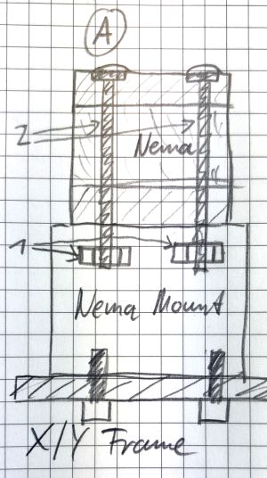

My second idea would be to completely decouple the NEMA stepper motor and the NEMA mount from the frame. This means that the NEMA motor is screwed to the mount from above and the mount to the frame from below.This prevents the vibrations from the motor being transmitted to the frame via the metal screws.
Option A:
Insert longer screws through the motor and into the nuts in the housing. Number 1 are two nuts, number 2 are longer screws.

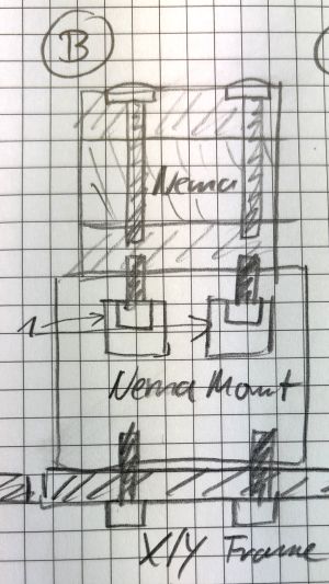

Option B:
Screws from below that hold the motor to the bracket. This requires space for the openings; not sure if there is enough space.

I tend to favor option A.

RE: Reason for Core One rumbling found (?)
Thanks for the sketches! Seems like we are thinking along the same lines: Replacing the continuous metal screws by separate mounts to the motor and to the CoreXY frame would also give you a "softer" connection between the motor and the frame, hopefully reducing the transmitted vibrations.
Using Nylon (polyamid) screws should achieve a similar benefit, since their elastic and viscous properties will be roughly similar to the plastic mounting block. Well, at least closer than metal... And it's easily done -- once you get hold of the required M3 x 35 mm Nylon screws, which are available but not that common.

All proposals are nonsense from a design point of view!
Proposal A requires drilling threaded holes in the motors and actually disrupting the motor design. There is not enough space for holes with nuts in the printed part.
Proposal B is nonsense only because there is no space for screw heads in the part, as you write.

And finally one comment, do you want to replace a fairly solid structure, where the printed block serves as an intermediate piece between metal parts, with a structure where you rely on the cohesion of the individual layers of the print?
You're right, the sketches are pointless... a CAD drawing from Fusion 360 would have been better.
